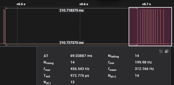

Thank you for the new RC21. I am though still seeing odd behaviour.
Much the same program as before, same options also.
Also, thank you so much for the StallGuard as found in the TMC2209! I was starting to wade through the TMC data sheet to figure out how to use it, and suddenly, there it is, already in the firmware! WOW!

I put a logic analyzer on the STEP pin to see what's going on. Some move requests loose 2 steps. The capture below is for the first move of 1 unit. There are only 14 step pulses generated. There should be 16. (Note also the 3 stray pulses at the beginning, when the stepper system is initialized. I didn't check the state of the enable pin during these pulses - sorry.)
Here's a comparison of the output with RC20 and RC21. No change.
"x" on the right indicates a move request with 2 missing pulses. The error is consistent each run. "Pulses out" is the pulse count from the logic analyzer.
I haven't seen an error on moves above 32.
Note my configuration of 16 steps per "unit". This means a move of 100 on the A-axis turns the motor exactly once. Also, X,Y and Z are not used and unconfigured.
Just checked something:
Moves of A.5 and A.75 work fine, A.25 loses 2 steps.
PicoMite MMBasic RP2350B  V6.03.00
       RC21        RC20     Pulses out
1      0.875       0.875        14   x
2      2.875       2.875        32
3      5.875       5.875        48
4      9.75        9.75         62   x
5      14.75       14.75        80
6      20.625      20.625       94   x
7      27.5        27.5         110  x
8      35.5        35.5         128
9      44.5        44.5         144
10     54.5        54.5         160
11     65.375      65.375       174  x
12     77.375      77.375       192
13     90.25       90.25        206  x
14     104.25      104.25       224
15     119.25      119.25       240
16     135.125     135.125      254  x
17     152.125     152.125      272
18     170.125     170.125      288
19     189.125     189.125      304
20     209.125     209.125      320
21     230.125     230.125      336
22     252.125     252.125      352
23     275.125     275.125      368
24     299         299          382  x
25     323.875     323.875      398  x
26     349.75      349.75       414  x
27     376.75      376.75       432
28     404.625     404.625      446  x
29     433.625     433.625      464
30     463.625     463.625      480
31     494.5       494.5        494  x
32     526.5       526.5        512
33     559.5       559.5        528
34     593.5       593.5        544
35     628.5       628.5        560
36     664.5       664.5        576
37     701.5       701.5        592
38     739.5       739.5        608
39     778.5       778.5        624
40     818.5       818.5        640
{Observation: A-axis should be at 820 at the end. 1.5 is missing.}
