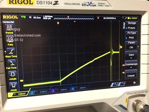

Posted: 04:03pm 11 Jul 2020
Ok I threw 12T on the former and placed 3 sets of E65 cores with a 1.6mm gap.
This is the scope pic. (current against time)
The shunt is 5mOhms Vert is 100mV/div and the time is 50uS/div, applied V is 30V.
so using v = L x di/dt - happy for someone to check my figures, its 1.30am and I'm falling asleep ....yawn so it may be all wrong.
I get 125uH and 720A turns and no sign of saturation yet.
The rest of the fun will have to wait until I get my mosfets and the MPPT board built up.

Posted: 08:32pm 11 Jul 2020
Your figures look good Mike.
I have only just woken up, just having my very first cup of coffee, so my calibrated eyeball may not be seeing too straight yet.
5 milliohms and 100mV/div = 20 amps/div, and I am seeing 70 amps peak.
Thirty volts, 320uS and 70 amps suggests 137uH

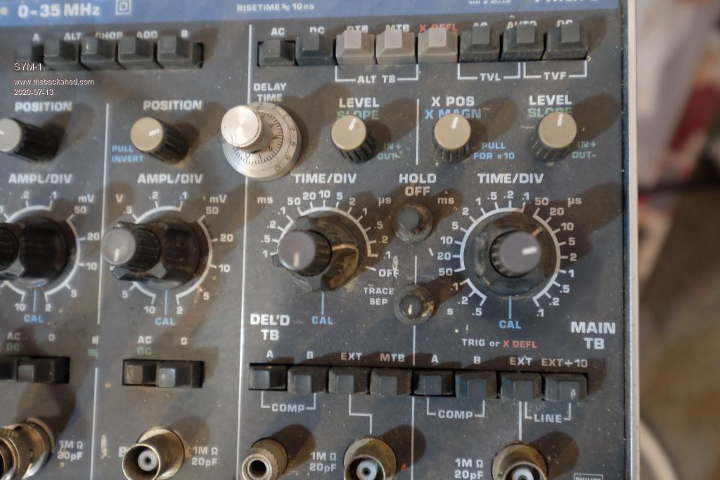

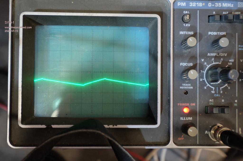

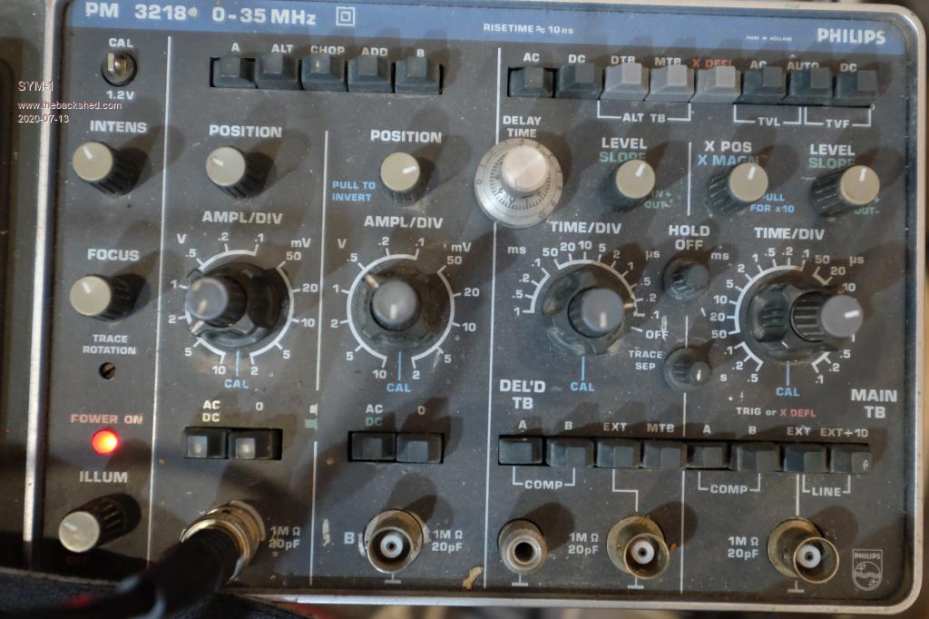

I have been working on measuring my inductance using the dv/dt method.
I have a T520-2 core.  Well two stacked cores.  They have 100 turns.
I performed my test running into a resistive load of 0.75Ohms.  Now to calculate the inductance I needed:
Input Voltage = 72.8V
Output Voltage = 17.4V
uS rise time = 42uS
Current Swing on output = 5.2A (4V/0.75Ohm)
((72.8 - 17.4)Volts*42uS/1,000,000/5.2Amps = 447.8 E-06 or 447uH
Now if this is true - I should be able to drop the number of turns down to 30 and use some 6mm tape or something similar to get the voltage drop down.
I guess the current swing will go up in proportion.  I wonder how much the current swing effects the maximum power output of the panels.
4V swing (5.2A)
20 uS per div
5V per div

Posted: 06:15am 13 Jul 2020
If you reduce the turns from 100 to 30, that is x 0.3 turns.
Inductance will change by 0.3 x 0.3 = .09
447uH will become 40.23uH
With a voltage difference across the choke of of 55.4v (72.8v - 17.4v) and an "on" time of 42uS the peak to peak ripple will now be 57.8 amps.
Why would you want to do that ?
