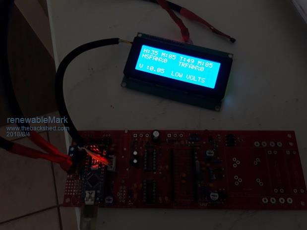

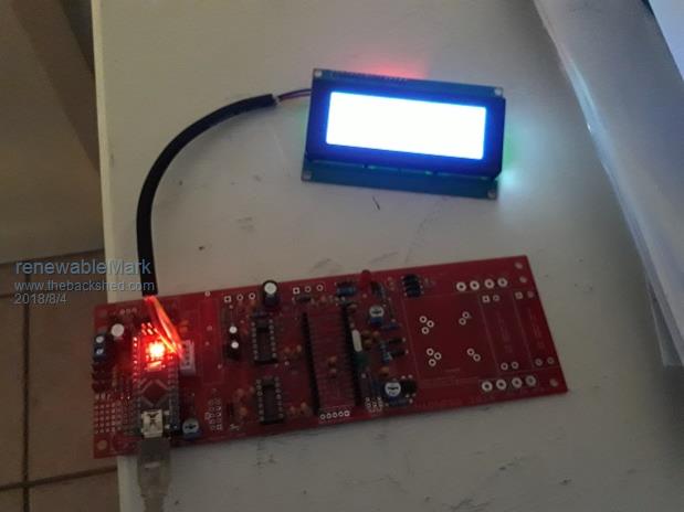

Finished work earlier than expected.
Got it done.

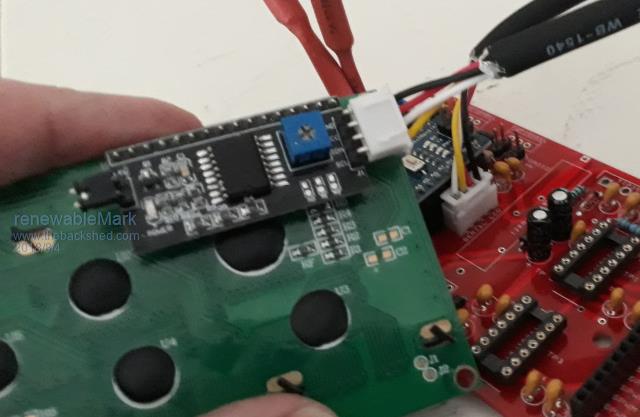

Did have a problem though, it came up with errors due to a conflicting multiple liquid crystal, so deleted the library completely, re installed still had the error, took off just liquid crystal and tried to load sketch, it said library missing, added it again and it said multiple conflicting libraries.
Went into program files 86 on c drive and found arduino and deleted the onboard liquid crystal then went to load the control board software and BINGO.
Did the addresses for the temp probes, had one error as I didn't put in a comma, then another error due to an O instead of a 0, in the program they don't have a line through the middle, just look a different shape, so be aware of that.
Also the pins on the control board are not pin for pin on the back of the lcd.
On control board top is grd then pos then SCL then SDA. so the bottom two are the other way around to what is the order on the back of the lcd.
Pic shows the colours for wiring.
BTW that was some sheilded 4 ply available from jaycar (and yes I will shrinktube the ends to prevent melal fibres coming loose)
So if I can do it anyone can!

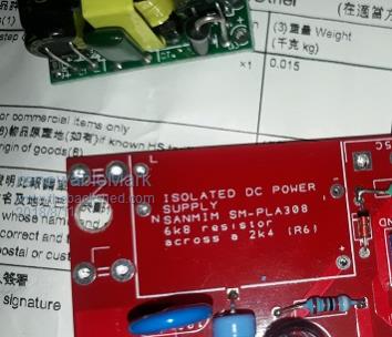

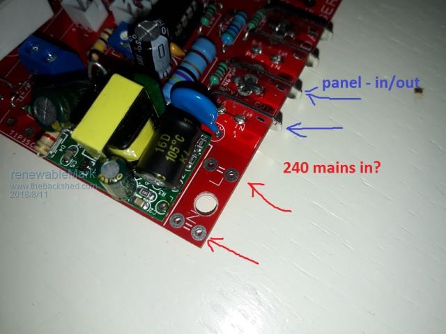

Mad, I'm almost done building the gti controller, the last bit arrived yesterday.
Can you clarify the instructions for the resistors?
Cheers Caveman Mark
Off grid eastern Melb
Posted: 10:56pm 10 Aug 2018
On the DC side remove the large diode next to the + output. You need to take the diode out so you can bend up the Electrolityc capacitor, then you will see the surface mount resistor R6. As per the instructions on the PCB solder a 6K8 resistor across R6, the easiest way is to put another surface mount resistor on top of it but a 6K8 0.25 W through hole resistor does the job also. You need to bend one leg and back onto the resistor and then at 90 degrees so it so the 2 wires match the length of R6. Cut the wires so there is only 2 mm or so pointing down, tin them and then solder to R6. It is a bit fiddly but not that difficult, when done bend the big capacitor down and put the diode back in. Once done solder wires through the power supply to the PCB.
The reason for this modification is to increase the output voltage to 18V.
renewableMark
Joined: 09/12/2017
Posts: 1679
Posted: 12:26am 11 Aug 2018
OK got that done.
So the red arrows are for 240v mains in to feed the isolated supply yeah?
Output should be 18V on the other side.
Blue arrows are for Panel neg input/output and the pos line goes direct to gti input yeah?
Edited by renewableMark 2018-08-12
Cheers Caveman Mark
Posted: 12:48am 11 Aug 2018
Yes L & N are live and neutral for 240VAC, Yes positive from panels goes directly to the GTI PV negative in out are clearly marked just make sure you keep the 2 halves correct for each of those GTIs ypu are using or if you had a GTI with 2 channel inputs.
