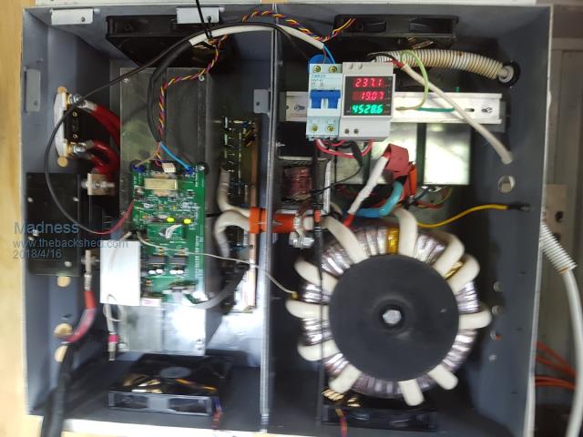

Those are the AC output filters from the Aero-Sharp Inverters. The DC input ones are smaller and have rounded corners. I have 3 of those in my Inverter in parallel also. I have them screwed to the bottom of the case above the toroid.
