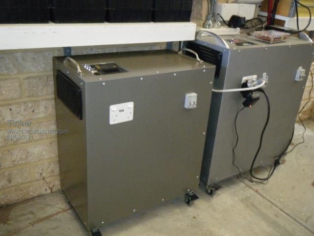

Posted: 10:28am 31 Mar 2018
Its time to add another chapter to my long inverter building saga since inverter #3 had just passed its test.
No real surprise here as its a very close copy of that monster inverter #2 described on many previous pages of this tread.
This one has just a single 3KW Aerosharp core, rewound to my standards. And adding the extra turns paid off, just 19.3W draw from the battery at stand by. I like that.
The other difference was using only 16 x HY4008 Mosfets and only 4 of the big, expensive, screw terminal capacitors.
The cabinet is a little lower and narrower too as the smaller toroid took up less room.

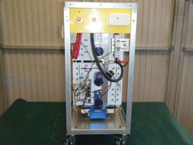

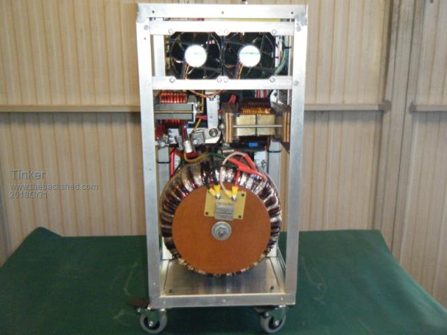

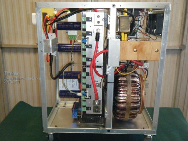

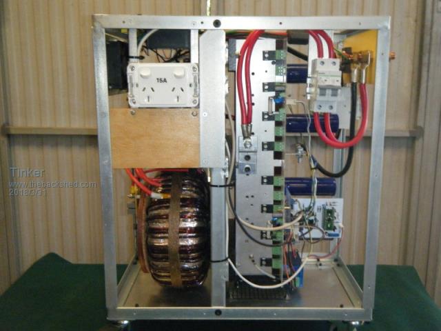

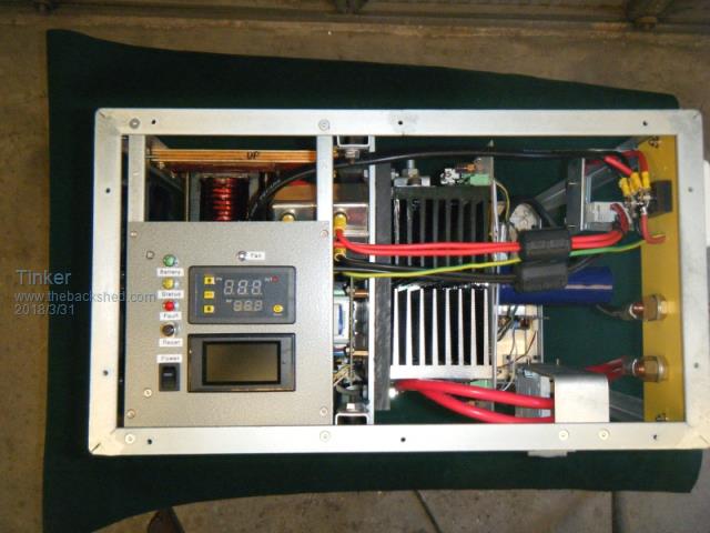

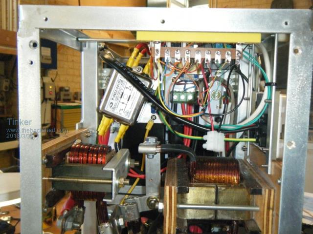

A picture gallery shown below, taken from all sides, might give other inverter builders some ideas.
Wiring under the top control panel:
Front side:
Left side:
Back side:
Right side:
View from top:

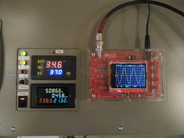

The test results did surprise me. As mentioned, it worked right away and required just adjusting of the AC voltage.
Then I started to load it up, here is a pic of the control panel at over 5KW, the trace does look acceptable too. That little brother to my two stack core inverter packs a punch!
Loading continued after this pic was taken to 6200W or so, no problems at all. But I started to worry then about pushing my luck with that 3Kw core plus the jumper lead clamp I used to connect to the battery got a bit warm from the 100+ amps.
I set the over current shut down to trip at 6KW, in use it should never see that load as this inverter is destined for light duty - literally - powering the lights in my place. Of course, it will serve as a reserve in case my bigger inverter, which powers the rest of my house takes a break for some reason.
Inverter #1, my 8 (Chinese)KW PJ conversion is now retired, collecting dust on a shelf.
Here is a pic of my two inverters, #3 is on the left, not yet wired to the old LA battery bank on the shelf above. I will do a heat soak test tomorrow if there is lots of sunshine.
