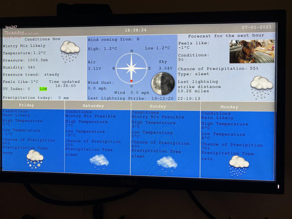

Posted: 02:31pm 07 Jan 2021
I'm pulling what little hair I have left out on this one
I've completely redone my code so it's all processed with a Pi 3+ now instead of a Zero and Esp32
I've got everything "I think" perfect other than this one thing
It's meant to place an image of the current moon phase on the screen
BUT it's not working
It only places Image 1.bmp on the screen
I've tried everything I can think of to try and figure out why it isn't working
Including reading the manual again and as far as I can see I have it correct and it should work
Can anyone see the stupid mistake I've obviously made?

The result of the print statement at this moment is 24.03748008
What does sImage=str$(int(moonage+.5)) produce?
I can't work out what it means (sorry)
There are 30 images of the moon, titled 0.bmp to 30.bmp one for each moonpase as it appears
example at this moment it should be
but it's displaying

One final one and I really think that this is impossible as I'm stuck on V5.05.01
I have this outline of a compass is it possible to get the numbers around the outside to rotate to a given angle?
It doesn't have to look like it's rotating, it can just move.
ie if the angle was 45 then the letters moved around the circle 45 deg so N is in the E position and so on?
Ideally I'd like to have NE, NW, SE, SW on there too but can't figure out how to get them on it
I know it's possible with the CMM2 but I can't waste one of those for this project even if I did have one
 dim cx% = 785
 dim cy% = 238
 dim wid% = 105
 dim ang! = 0.087266463
 Circle mm.hres/2,mm.vres/4 + mm.vres/32,90,2,1,RGB(WHITE),RGB(134,174,230) 'Centre
sub compass_rose cx%,cy%,wid%
     local a%
     for a% = 0 to 90
       line (cx%+15)+(cos(a%*ang!)*(wid%*.85)),(cy%+15)-(sin(a%*ang!)*(wid%*.85)),(cx%+15)+(cos(a%*ang!)*(wid%*.9)),(cy%+15)-(sin(a%*ang!)*(wid%*.9)),,RGB(WHITE)
     next
     text cx%+9,cy%-wid%+5,"N",lt,4,1,RGB(BLACK),RGB(134,174,230)'
     text cx%+9,cy%+wid%+5,"S",lt,4,1,RGB(BLACK),RGB(134,174,230)'
     text cx%+wid%+8,cy%+4,"E",lt,4,1,RGB(BLACK),RGB(134,174,230)'
     text cx%-wid%+8,cy%+4,"W",lt,4,1,RGB(BLACK),RGB(134,174,230)'
     circle cx%+15,cy%+15,wid%-16
     circle cx%+15,cy%+15,wid%-13
end sub
This is what it's like now (I've left the centre of the compass out of the code above as this would stay in position and not move
