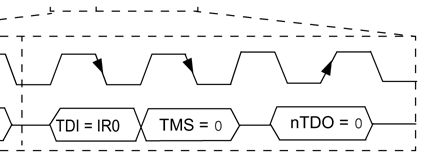

Posted: 07:13am 09 Sep 2014
  G8JCF said   I have to admit that I really don't understand how you came to your conclusion since every timing diagram in the MCHP docs shows quite clearly that TDO becomes valid on the rising edge of the 4th clock pulse, whereas your suggestion suggests that TDO is valid AFTER the falling edge of the 3rd clock pulse and BEFORE the rising edge of the 4th clock pulse. Could it in fact be that the PIC32 clocks out TDO on the falling edge of the 3rd clock pulse, and the 4th clock pulse is required simply to synch the PIC32's internal state counters (a counter of 3 would be really awkward to implement). The existing MCHP clocking diags show that the 3rd clock pulse apparently does nothing, perhaps, the documenter/technical author got it wrong and it should have been clock pulse 4 which did nothing.
I see rob's explanation as highly plausible.
I expect the target PIC32 puts out its TDO as soon as it believes the programmer has changed its PGD to be an input. (There will inevitably be a tiny delay in putting out TDO as the PIC32 has to see an edge and the state machine has to move along to putting the TDO out, but I expect we're talking 10-30ns maybe?) hmm, can we guess what clock rate that ICSP/JTAG state machine inside the PIC32 works at?
It does seem to work :)
However, I think maybe IT DOES NOT if you run fast enough in C (as with 700MHz RPi). I think this is why I needed a small (maybe 40ns?) delay. Such delays don't affect an MMBasic program!
Posted: 07:14am 09 Sep 2014

Posted: 07:19am 09 Sep 2014
peter:
i reckon a 10% speed improvement isn't too shabby! i shall do my best to find a few more.
i've been working off figure 5-6 on page 12 of the document "PIC32 Flash Programming Specification 60001145N.pdf" (also called the 61145N datasheet). the relevant part of the diagram is:
this shows TDO data becoming valid on the falling edge of the 3rd clock pulse. many people do seem to be (erroneously) assuming that TDO is 'clocked out' on the rising edge of the 4th clock pulse, without remembering that TDO is being generated by the target (the 32MX) while PGC is being generated by the host.
the target needs to be told by the host to make TDO available on a clock edge, and then told that the data is no longer needed on another clock edge. it is up to the host to read the data at some time between the two edges.
when the target is informed that the data is no longer needed, it needs to smartly turn PGD back into an input before the host tries forcing data onto the line.
this all fits into the following 'reconstruction' that i posted a few pages back. the 8 edges of PGC can be simplified as the following list of 'instructions' to the 32MX:
#1 first PGC rising edge: get ready to read TDI
#2 first PGC falling edge: transfer TDI data on PGD into 32MX
#3 second PGC rising edge: get ready to transfer TMS
#4 second PGC falling edge: transfer TMS data on PGD into 32MX
#5 third PGC rising edge: reconfigure PGD pin on 32MX as an output
#6 third PGC falling edge: load TDO data onto PGD
#7 fourth PGC rising edge: reconfigure PGD pin on 32MX as an input
#8 fourth PGC falling edge: <end of transaction>
between #4 and #5 the host needs to prepare to read TDO (configure PGD as an input at the host end). after #8 (but not before) the host is free to reconfigure PGD as an output at the host end - this needs to be done before the next #1.
all as clear as mud!
rob :-)Edited by robert.rozee 2014-09-10

Posted: 07:35am 09 Sep 2014
TDO becomes valid on/after the falling edge of the phase 3 clock and remains valid up until the falling edge of the phase 4 clock. That's it really... I'm sure...
This and only this explains how and why reading either before the phase 4 leading edge or after it both work. How much more evidence do we need than what has already been presented in this very thread?
If it was any different how could all the code that works by testing after the phase 4 leading edge work? That includes all of microchip's programmers, my own and several of the posters here. In fact just for giggles I stuck a 30uS delay after the phase 4 leading edge before reading TDO. My programmer still worked but it was (4x slower...)
Now there is still one chance at a rebuttal of this. It could be that TDO remains valid after the phase 4 leading edge simply because of stray capacitance and the high impedance state that TDO will otherwise be in. However, I tend to doubt this so much that I didn't feel the need to test out. It just seems so unlikely given all the evidence so far (like the pull-down resistors on PGC and PGD in the Pickit 2 for example...)
I think that diagram is - once again - slightly misleading.
I think nTDO's beginning (where the level becomes a box) should be shown a little to the right to make it clear it can only start after PGC has dropped. The state machine inside the PIC32 must see that PGC drop and take a small but finite time before it manages to drive what's shown as nTDO.
(With the RPi I can read TDO ever so soon after PGC drops! Doesn't work if I do.)
(As before, those wretched black arrows are not helping and ought to be explained, thanks for nothing Mchp.)
edit: Perhaps Mchp are trying to say that if one wanted to latch TDO (here, nTDO) then doing it on that rising edge with the black arrow would be the right time.
JohnEdited by JohnS 2014-09-10

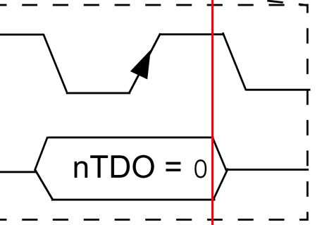

Posted: 08:11am 09 Sep 2014
  JTR0701 said   TDO becomes valid on/after the falling edge of the phase 3 clock and remains valid up until the falling edge of the phase 4 clock. [...] This and only this explains how and why reading either before the phase 4 leading edge or after it both work.
alas, if you apply a vertical ruler to the timing diagram, you'll see that TDO starts to become invalid before the falling edge of the 4th clock pulse:
clearly the only explanation is that the 32MX looks forward in time to determine when the falling edge of the 4th clock pulse will occur, and removes the TDO drive a fraction of a second before then.
them there microchip folks sure are pretty clued up on their time travel!
rob ;-)
Posted: 08:26am 09 Sep 2014
I think that whole box for TDO needs shifting to the right.

Posted: 08:27am 09 Sep 2014
Of course if the time travel theory doesn't do it for you then there is the "sloppy work from microchip" option. Hmmm...

Posted: 08:52am 09 Sep 2014
If one looks at the other timing diagrams, 6.6, 6.9 the falling of pulse 3 sometimes overlaps TDO and at other times misses TDO. Perhaps the MCHP technical writing team were just a wee bit slack.
5.3.1 4-PHASE ICSP
In 4-phase ICSP mode, the TDI, TDO and TMS device
pins are multiplexed onto PGEDx in four clocks, see
Figure 5-4. The Least Significant bit (LSb) is shifted
first; and TDI and TMS are sampled on the falling edge
of PGECx, while TDO is driven on the falling edge of
PGECx.
. The 4-phase ICSP mode is used for both read
and write data transfers.
and yet Fig 5.4 shows the RISING edge for TDO !!
Peter
The only Konstant is Change
Posted: 09:20am 09 Sep 2014
  G8JCF said
5.3.1 4-PHASE ICSP
[...] while TDO is driven on the falling edge of
PGECx.
Peter
TDO is certainly driven by the target on the falling edge of the 3rd clock pulse, while to me the up arrow indicates that a relevant (to the host) state transition is triggered within the target. because the host is driving PGC, it is up to the host to read PGD during a plateau, the logical (and only completely stable) plateau being between the falling edge of the 3rd and the rising edge of the 4th clock pulses.
the plateau between rising and falling edges of the 4th clock pulse covers both stable and unstable states of PGD, making this a poor time to read PGD - especially when there is (according to the datasheet) a fully stable interval in which to read.
it is a bit like flying an aeroplane. you follow the instructions and instruments to the letter. you do not deviate. if you do deviate, your chances of crashing are considerably greater.
rob :-)
Posted: 10:05am 09 Sep 2014
  G8JCF said   If one looks at the other timing diagrams, 6.6, 6.9 the falling of pulse 3 sometimes overlaps TDO and at other times misses TDO. Perhaps the MCHP technical writing team were just a wee bit slack.
5.3.1 4-PHASE ICSP
PGECx.
Peter
Yes, but it's a bit of a guess WHY it shows it. I agree with rob & Jim that you're meant to read it such as then. Maybe a circuit which latched TDO (for software to read as and when) ought to do that on that rising edge.
Some time ago it was said (and I agree) that "while TDO is driven on the falling edge of PGECx." means the falling edge of the 3rd PGECx. So what the sentence means is that the target will (start to) drive TDO out on that edge. Well, one can't read it at that instant (it will not have settled) but a little later would be OK and on the next rising edge of PGECx will be great.
JTR0701
Joined: 10/07/2013
Posts: 71
Posted: 10:44am 09 Sep 2014
Yes, this is exactly my position. It is IMHO common sense that just happens to be backed up by much evidence.

Posted: 01:51pm 09 Sep 2014
So we are settled then,
TDO is stable and readable after the falling edge of the 3rd clock pulse.
It's a good job we don't have edge triggered latched inputs on the PIC32
73
Peter
