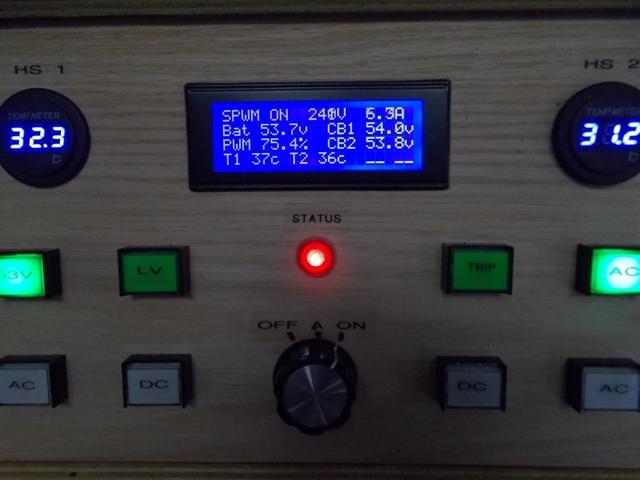

Lots of rain and overcast days with 34°C temperatures and unbelievable humidity.
The Hot water system is running beautifully on the inverter under these conditions and absolutely no problems for the battery bank and existing solar over a few days of this bad weather.
I've had the inverter running at 4kW when starting the biggest work-shed loads, the peak DC input currents are hitting over 730A, once the extractor startup load settles  the running load is at 5.2kW, the next piece of cutting machinery is started and stopped around 20 times for for a few hours, each start is another 390A Peak DC above the running 5.2kw running load.
The results - well nothing happens, the Inverter remains silent, the Toriods never get above 39°C so cooling fans never come on, and the Heatsink temperature rise is around 2° on each heatsink (convention cooling).
Keep in mind that the Inverter is running an AirCon which is keeping the room that the inverter is located in at around 28°C and of course removing the Humidity.
I've had one fault (which does not affect the inverter), one digital DC input meter has lost it's display, back light still works - it's a few years old so I guess it's time to replace it. I might break it open and have a look, but easier to replace it really.
So, now it's time to pull the old Hot water controller panels down and replace them with higher power panels for more solar to the Inverter, I'm also going to put another 6kw of solar facing slightly south on the back of the shed roof for those overcast rainy days, panels don't care where they face in those overcast conditions.
This paralleled output stage Inverter is simply amazing.

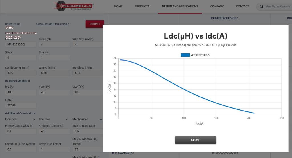

Thanks for the link for the Sendust cores.  In Canada, the price comes up as $6.60 plus $9.45 shipping (CAD), but as you add more cores, the shipping just goes up by $1 each.
(until you hit 12 cores when the shipping goes up by an additional $60)
So to order 11pcs it works out to $8CAD or $8.84 AUD each which is the best price I have found around!
I tried ordering this size core earlier off an EBAY vendor, but they ended up not actually having the advertised cores and sent me MS184040-2 cores instead.
They refunded me, and I may use the cores for something, but obviously not ideal.
On another note, when I enter a stack of 9 pcs of this core (MS225125-2) with 4 turns in the Micrometals inductor Analyzer,
I am not seeing the inductance at the higher currents you are mentioning.
On my previous builds using 3xMS157060-2(Sendust) and 4xT250-40(Iron Powder) the inductor Analyzer numbers were surprisingly close to the numbers
I measured using a storage scope and high current source.  Obviously what you have is working well, so just wanted to confirm that you are using
these cores with just 4 turns.
Here is the current vs inductance curve generated for a stack of 9 MS225125-2 cores with 4 turns.
I have double checked the core weights and sizes between the Micrometals core and the Aliexpress core and they match.  So I am a little stumped with why the difference.
Greg

That's interesting, I'm measuring them with a current source of up to 700A and a DSO, while they are not "quite" as good as the meatier 6 core stack (not available) they are close.
These are measured with a high current hall effect sensor and confirmed against a resistive shut for Hall Sensor transient response and indicated current.
Two chokes have been repeatably subjected to almost 600A daily for over a year, and as you say, they are working well, in this dual inverter they now see 600A peaks across 4 chokes.
It's a shame that we can't get the original cores, and cores in general at a decent price.
Edit: From memory I calculated around 9uH at full current for a single 9 core choke with original thicker cores, if the Sim is correct then I was close, 7uH @ 200A single choke, two chokes would be round 14uH at 400A, over 20kW input surge.

Are you seeing inductance go down when the DC current goes up?  If not, then these must not be Sendust cores.
Greg
KeepIS
Joined: 13/10/2014
Posts: 2265
Posted: 04:52am 27 Feb 2025
Of course, why would they be 23uH at zero current and 9uH close to saturation.
They are Sendust, the correct mix is stated.
