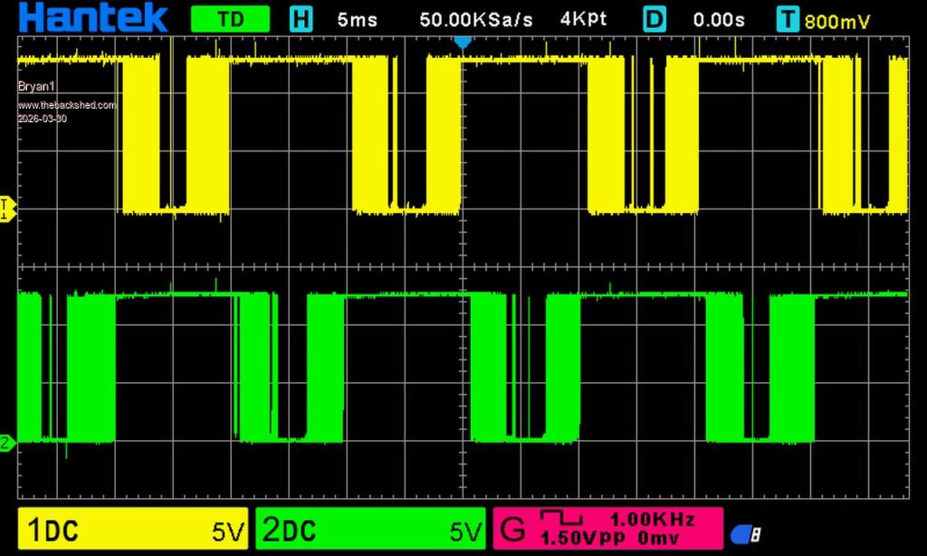

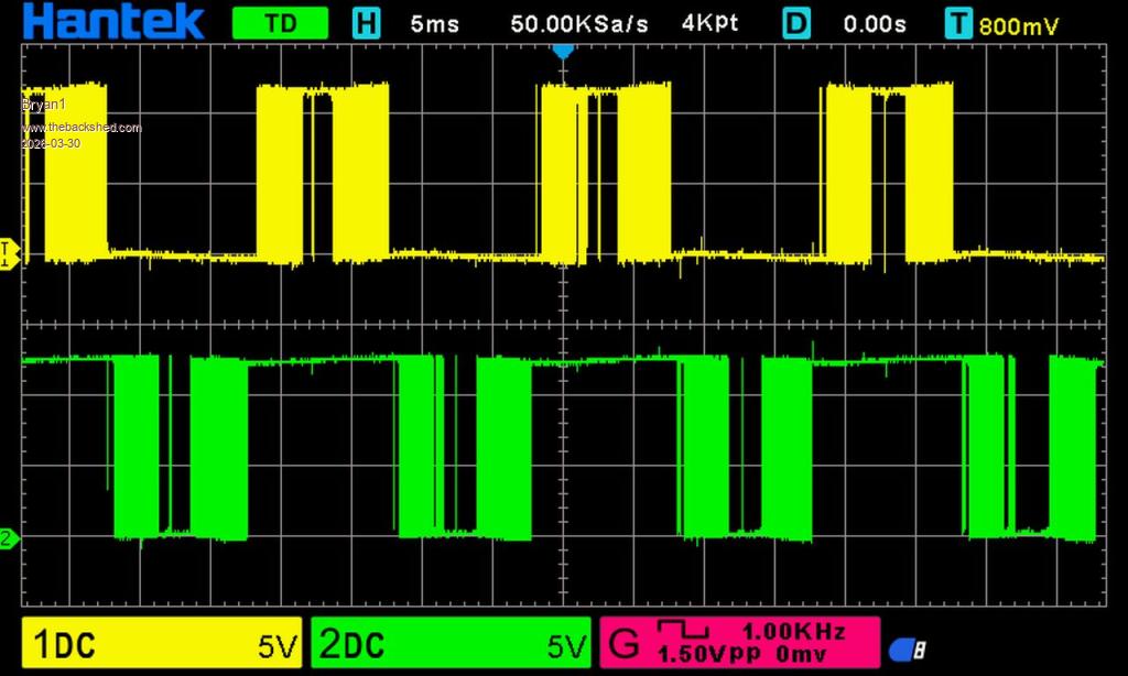

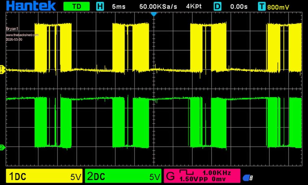

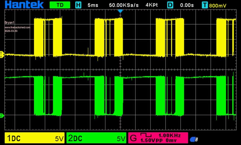

Ok I desoldered the 10 pin connector and clearly saw the H02 pin connection didn't have any solder so now the 10 pin connector sit about 5mm high as I soldered the top pads
Now tried again and still voltage to R52 so thought ok the only thing this can be is the ribbon connector Got out my 10 pin ribbon connector for my AVRDude as  shown below
H02 L02
H02 L01
H01 L01
L02 L01
So hopefully these scope pic's are right

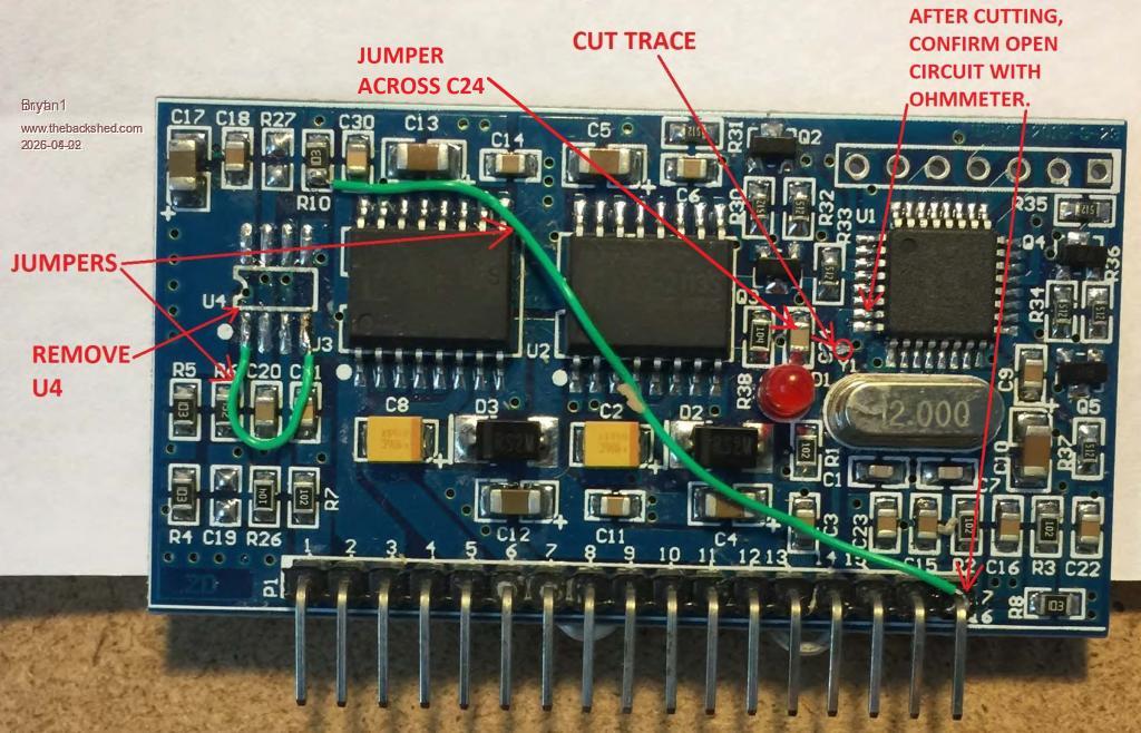

Bryan1
Joined: 22/02/2006
Posts: 2297
Posted: 09:10pm 01 Apr 2026
I do have a couple of those boards here I bought a while ago so this morning I will have a look and see if they are actually EGS002 boards. So if any mods are needed I can do it to one of the boards I have here so it's already to run to run when the inverter arrives.

Bryan1
Joined: 22/02/2006
Posts: 2297
Posted: 10:21pm 01 Apr 2026

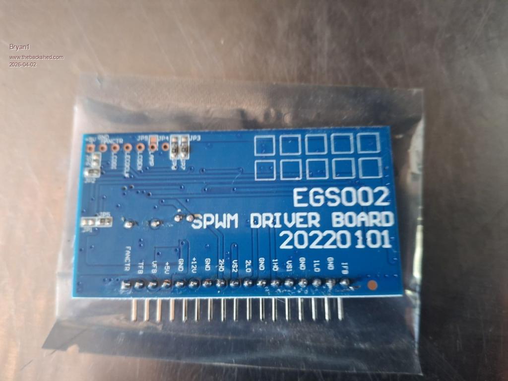

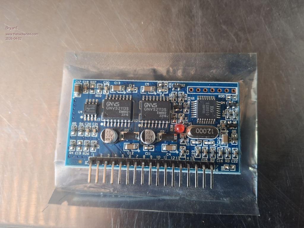

Ok just had a look at those EGS boards
So I do have the EGS002 boards here   so what mod's are needed are needed to do this board.
I did look at that link TinyT put up and there is a picture of the mod's he did so so is that what I need to do.
Now what I found with that inverter build I would put up a post then just go do the change only to find another post said to do more checks so no more making that mistake.

Hi Bryan, so to modify the EGS 002 board
First remove the IC4 , it is the small chip on the left of the board.
Then put a jumper wire to connect the pads where pins 1 and 4 of the chip were.
Then short the pads where pins 7 and 8 were.
That is all I have done on mine and had no problems.
From what I remember the board has some sort of overload mechanism that tends to blow up the mosfets on the main power section if they are mistreated.
Getting rid of U4 allows the overload section on the main board to do its job.
My abuse by trying to start my wood splitter have only ever resulted in the inverter shutting down, then automatically restarting after about 10 seconds.
Good luck

Bryan1
Joined: 22/02/2006
Posts: 2297
Posted: 02:32am 02 Apr 2026

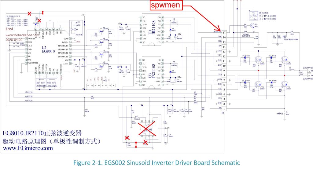

Yea Pete that inverter build was a Madboard one that I spent ages to build and it is sad it's now on the scrap pile.
Now I pinched this pic from TinyT's thread
So with his mod yes the U4 chip is removed and pins 1 and 4 had the jumper wire, now the 7-8 pins weren't shorted.
Anyway got a couple of weeks before the board arrives so plenty of time to get my head around whats needs to be done.
Regards Bryan
tinyt
Joined: 12/11/2017
Posts: 564
Posted: 03:08am 02 Apr 2026
Here is the modification in schematic form. The U4 mod basically disables the SD(shutdown) signal to the IR2110 chips.
The trace cut and long jumper changes FANCTR to external SPWM ENABLE (inverter Start/Stop switch), alternate is fixed enable via U4 pin 7 to pin 8 jumper. The C24 jumper disables IFB signal to the EG8010 chip (allows overload abuse). Your choice to incorporate these two mods.
Edited 2026-04-02 13:17 by tinyt
