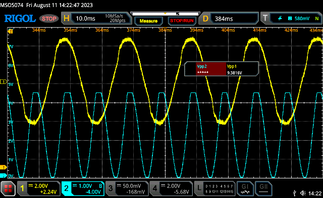

Once again using a differential probe across the Toriod Chokes:
The HI and LO drive is symmetrical in this inverter: While monitoring the waveform across either choke, I short the other choke while the inverter is running.
Note: You must not use a thin jump lead for this, use at least a 25mm "diameter" short cable.
The only change is the waveform voltage doubles across monitored choke.
No other changes are noted except for the expected slight increase in PWM noise on the AC output, obviously shorting one choke halves the inductance between Power Board PWM output and the Toriod transformer.

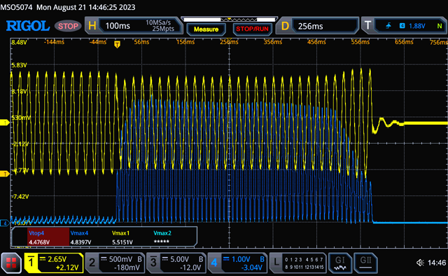

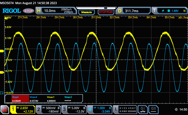

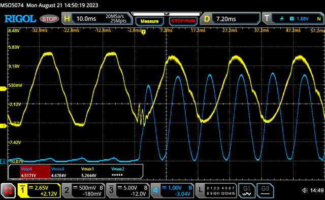

A day of some serious Current tripping, I wonder if you can get high on that
I was now confident that the Inverter was back to its old self after getting the toriod back to 75Hz. I spent some time setting the AC trip point and the newly added Peak DC current input trip point.
I stopped a few days ago when I looked at the Flat tops and bottoms of the DC input current waveforms - I knew something was not right.
So for anyone interested, I have some screen saves from the DSO and a comparison of one of the loads when the Toriod was resonating at 119Hz. Even small loads were causing various levels of flat topping on the DC current sense output.
Yellow: 240V AC out
Blue: DC input Current
Peak inrush current is 550A
Comprising 1 second at over 530A + 2 seconds at over 430A for a total of 3 seconds before the current starts to finally fall off as the beast comes up to speed.
Below: Toriod Resonance - 119Hz - Flat top and bottom.
Below: Toriod Resonance - 75Hz
DE Motor Startup:
Below: A full startup capture. This is when I was still adjusting for the correct Current trip values.
The Inverter tripped just as the load was up to speed, the "Auto Transfer Switch" changed over from Inverter AC power to Mains AC power in under 40ms.
Edited 2023-08-21 19:27 by KeepIS

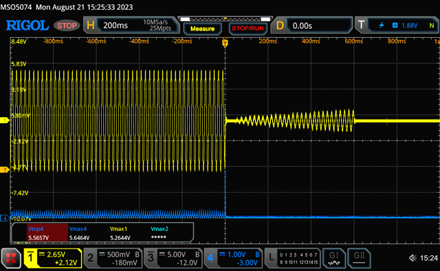

KeepIS
Joined: 13/10/2014
Posts: 2287

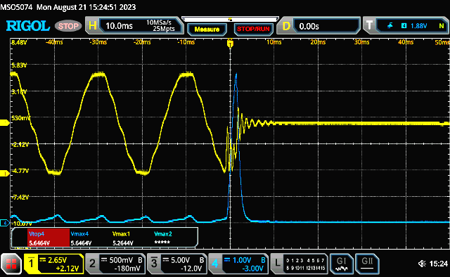

Posted: 10:02am 21 Aug 2023
The Variac was switched on and off then back on, I had be sure it would trip.
This peak DC input current is over 700A, the inverter tripped.
The first AC disruption is the Variac load hitting the Inverter, the Inverter is tripping on the DC input in this screen capture, as the PWM is inhibited, there is some ringing (after the Current peak) as the Toriod transformer field collapses.
BELOW:
This is the full screen capture from which the above Current Trip frame was taken. The Blue trace 700A peak is narrow and now very difficult to see against the Yellow AC output waveform.
There is a second period of ringing around 40ms after the PWM was inhibited, this would be the ATS (auto transfer switch) removing the Toriod secondary from the various running Loads and transferring the AC line Loads back to Mains AC. This causes no issues with the Loads and all workshop machines have NVR switches (No Voltage Release) so they must be restarted manually if power is interrupted in any way.

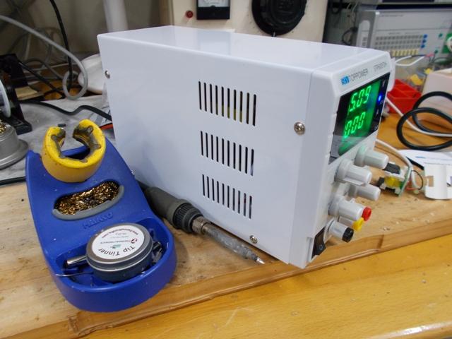

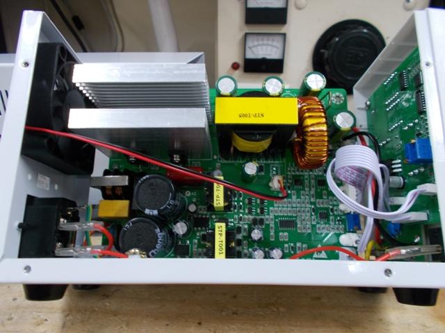

Posted: 01:10am 23 Aug 2023

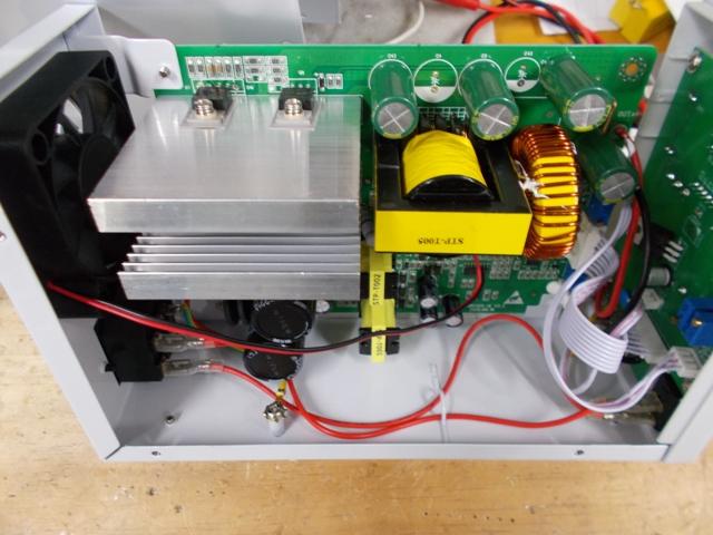

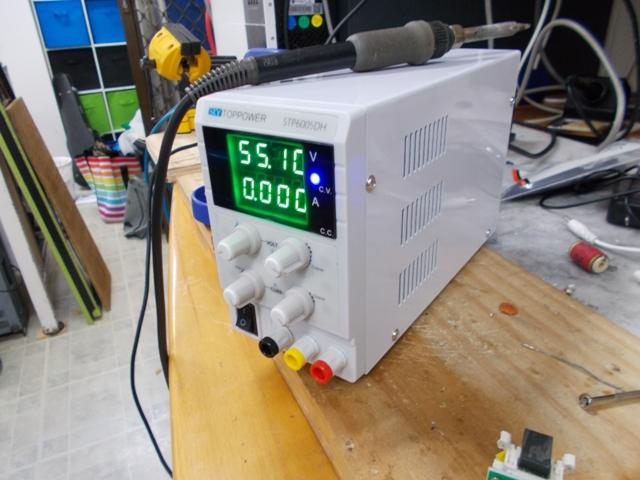

FYI: I'm sick of carting a Heavy Dual Tracking Supply over to the inverter when I want to safely power it with a current limited supply for tests or adjustments, or when testing various solar build devices on the bench that require up to 60V DC and current limited from a few mA to a few A.
This very small 0-60V, 0-5A 300W supply with constant current [0-5A] weighs just a couple of kg, 226mm x 82mm x 138mm.
It had no trouble starting and running the Inverter and switching loads of 280W. Don't know why I never grabbed one before, I couldn't make it for the price. $100 for the 3 digit version and $114 for the 4 digit version from Amazon au. Next day delivery.
I ran it for few hours powering the inverter with a 280W load and it runs almost cold, a "very quite" fan starts up with loads. The displays are quite accurate and not like the normal garbage I've tested.
An idea of the size. It looks and feels like a well made unit, even the case is thick metal and the fit and finish are spot on.
Edited 2023-08-23 15:46 by KeepIS

Posted: 12:16pm 23 Aug 2023
Yes, they are a good little power supply I have a Wanptek 30v 10amp , would be very similar, might get the 60v version later, made a grill to go over the fan to keep the bugs out.

Posted: 10:54pm 23 Aug 2023
I have two older supplies, what were called Laboratory Power Supplies, dual analogue 0-30V @ 3A + 5v fixed and a later Digital readout version rated at 5A, heavy and quite large but great set up in the work bench.
Sure you can push some buttons and they both do series or parallel tracking, but it's a still a pain. At 60V @ 5A this little unit is ideal for Inverter testing and it can sit in the palm of my hand.
These days I find if test gear is big, heavy or hard to move and setup then I tend to not use it for a quick test or mod, and that's just when I should have done so to save component destruction when I make an inevitable mistake in testing or adjustment.
However, those older current limited units were the reason I never had smoke escape during all the building and experimentation I did across two inverter builds.

Posted: 05:24am 24 Aug 2023
I went looking on Amazon for the model you pictured (Toppower?) but they don't have that listed. Although there are other breeds of the same item. 60v would be a handy addition to the bench. I bought my Rigol from Amazon. Good price, and so far as a bonus, no smoke   .

Posted: 05:40am 24 Aug 2023
  Pete Locke said  I went looking on Amazon for the model you pictured (Toppower?) but they don't have that listed. Although there are other breeds of the same item. 60v would be a handy addition to the bench. I bought my Rigol from Amazon. Good price, and so far as a bonus, no smoke   .
Pete'.
Hi Pete: link to supply.
Power Supply
I was going to buy my Rigol on Amazon, but at my age and current situation I just didn't want the stress of something I really wanted going south, but so many people have had a great experience and saved quite a bit.
You likely noticed the one I went for from the screen grabs, so far I'm really happy and it's a big step up from the one year old TEC, I bought that second hand from someone who found they couldn't use it, they just wanted it gone.

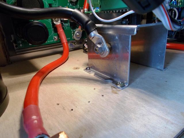

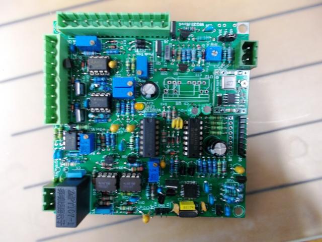

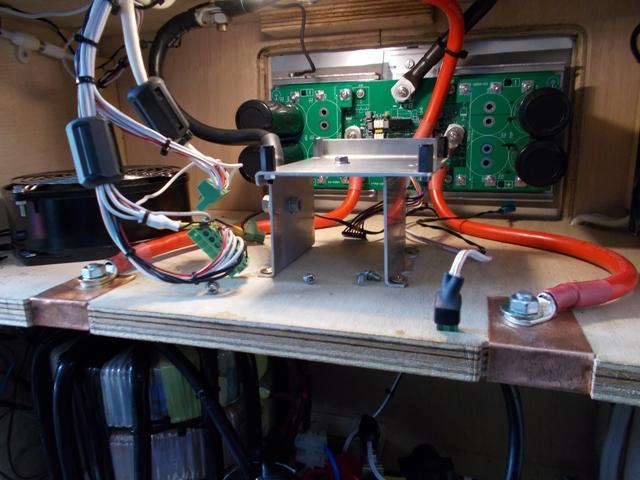

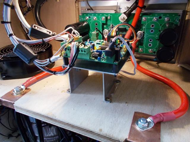

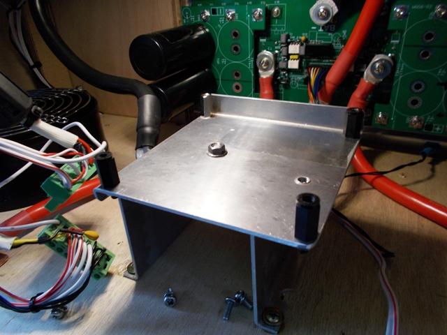

More info on the new controller board and the "ground plane" implementation in the inverter.
Wiseguys controller board has a PCB ground plane connection via one mounting hole on the PCB, the PCB ground plane is not a connection to the boards common 48v negative tracks or connectors.
The difference in noise on the 48V positive and negative supply tracks, connections and circuits on the board is significant, it's worth every second of the time it takes to get this connection right.
I was also aware the systems common negative connection to the aluminum ground plate would have to be at least 25mm copper, and no more then 150mm long to have any chance of working correctly. Testing showed a connection from the Inverters common Negative DC input mounting plate to the aluminum ground plane bolt was the most effective for reducing noise.
That connection is just above the controller board where the common negative DC input bonding plate is bolted straight through from the Top switch/Interface deck of the Inverter cabinet, thus allowing the shortest direct connection to the power board and now to the controller ground plane, obviously both are mounted in the middle Deck which houses the Power and controller boards.
Below: Aluminum Spacer with external Ground plate for mounting the PCB.
System common connection to the Ground plate is on the LH side of the Bracket.
BELOW: The New test board with those lovely big plug in connectors. Takes about 20 seconds to remove that board.
Mike [Wiseguy] pointed out that the hysteresis for the onboard dual Fan controllers would need tweaking, and I've spent a bit of time getting the values correct for my use, which is cooling the only thing that gets warm in the inverter, the Transformer.
This is such a huge heavy lump of iron, temperature sensors sit between the bottom two of the three stacked toriods, and are therefore sandwiched between their secondary windings, so normal hysteresis values for heat sinks are way out, very little hysteresis is needed, like around 2 deg, it's now working very well.

Moreover I seriously doubt that we can in any way be sure that we actually have this magical 75Hz static resonance that we're trying to attain in the dynamic situation of a loaded running Inverter.
To this end, I'm quite happy to sacrifice my inverter to the 50Hz resonant demons, if I'm wrong then so be it.
I'm basing my choice of CAP on the Inverter output and various dive waveforms around the Toriod, I'll use the rough calculated value (calculations based on an uncertain value of flux) as part of a "Toriod + secondary Capacitor" filter for a PWM generated AC waveform as a starting point.
I still have to do more testing to verify what running conditions I need to choose for best output, that takes time. It may be just minimizing inverter noise on the AC waveform, or the cap value may have more of an effect on certain bad load conditions.
Tests in the past and repeated again today show increasing the value of the CAP causes ringing on a bad load, but this is mostly confined to testing the inverter in Isolation or very lightly loaded, once connected to normal running off grid loads, the ringing is hardly affected by the change in CAP values.
THD distortion increases slightly with reduced values of CAP, DUH! Again, only on a single load at the inverter, off Grid connection loading masks the slight increase.
At this stage I have a chassis mounted block CAP of 3.3uf 480v~. I can no longer tell you with any degree of certainty what the static resonant frequency of the transformer actually is, nor do I care. So far I have briefly tested values from 1uF to 12uF while running off Grid loads, nothing really changes. I need to take time to look at the FET drive and Toriod input waveforms under similar conditions.
I think the real choice of value will most likely be when I look at High current startup loads again as I did a few days back, I found a noticeable change in DC current waveforms with a higher value of CAP, however AC waveforms appeared to stay the same.
