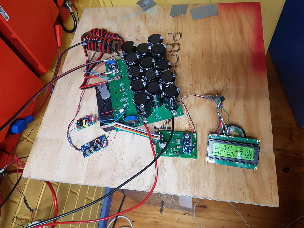

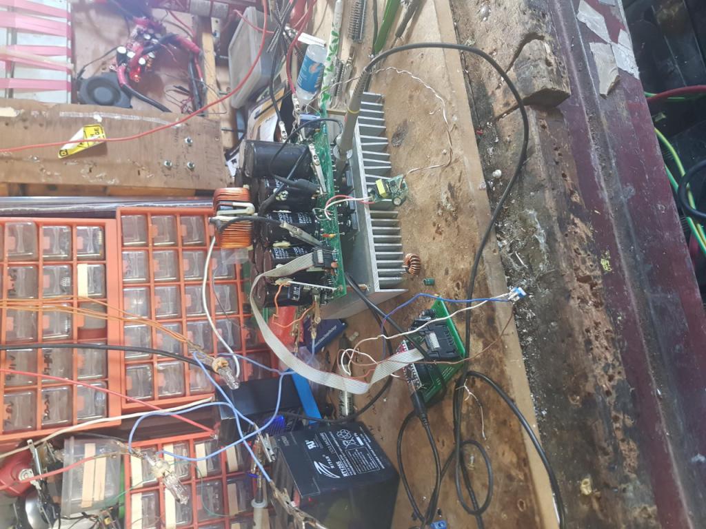

noneyabussiness
Joined: 31/07/2017
Posts: 527
Posted: 03:05am 04 Jul 2020
pics of test bed...
again, thx in advance
I think it works !!

Noneya, software is not my forte but at first glance the output volts D - should that be 0.133 instead of 0.0133 - I am using the 54V & corresponding value in the line above as a reference ? I havent looked at a schematic either, just shooting from the hip.
if its something I did wrong on the PCB I also apologise in advance !
Cheers Mike
poida
Joined: 02/02/2017
Posts: 1507
Posted: 06:10am 04 Jul 2020
Noneya:
First, it's important that you have made a few changes to the design. This is probably going to be OK but I'll bet something will be overlooked that will be seen as important later.
The 10 pin connector appears to be correct, the vital connections that MUST be CORRECT
are the two ground pins, 12V and PWM.
All the rest are going to analog inputs, 6 in total and we can change things in software to suit.
So my first thought is "IS the 10 pin connector correct?" We can prove that with the oscilloscope showing pwm output from the brainboard and the gate drive, relative to ground as it goes into the TLP-250 inputs. Prove this first.
Now we need to look at the inputs to the nano on the brainboard.
Make sure the midpoint of the input voltage divider goes to "A0 -Vin" 1K resistor.
Use the continuity function on the DMM
Then prove the output voltage (as divided, on the power board) is going to
"A2 - Vout"
Then we look at the current sensor outputs. IN turn prove the input current sense output, AFTER R13 on the the powerboard, is going to the 1K resistor "A1 - Iin"
and then prove the output current sense is correctly connected.
We must be sure that the 4 analog inputs are what we think they are.
Then use the DMM and see what voltage the 2 current sensors are putting out.
If you used bipolar type sensors, you should see about 2.5V on the output at the sensor pin for zero current.
Measure this and all things with respect to battery DC ground
Then if all the above is in place my firmware will have a chance of running.

noneyabussiness
Joined: 31/07/2017
Posts: 527
Posted: 08:34am 04 Jul 2020
thank you for your advice, i have checked it over vs the schematic, but ill go over it again with a fine tooth comb in the morning.. i did try your test code, the only change was the voltage on the serial console when I twiddled the pot, hence why i used that generic code off of google (pedestrian i know)... I've obviously made a boob of myself , i mean boo boo..
I think it works !!

Under the heading of "pics or it didn't happen"
here is the low power mppt controller that is hooked up to the East facing array on the roof. It has run without any issue for a week (I fixed what I think is the last bug in the firmware last weekend)
Today we had low cloud and near continuous drizzle.
This must be Melbourne! Yes indeed.
You can see 2 supplies. One is a a non-isolated dc-dc converter, this provides the 12V.
The other is a floating output supply which is used for the gate drive of the MOSFETs

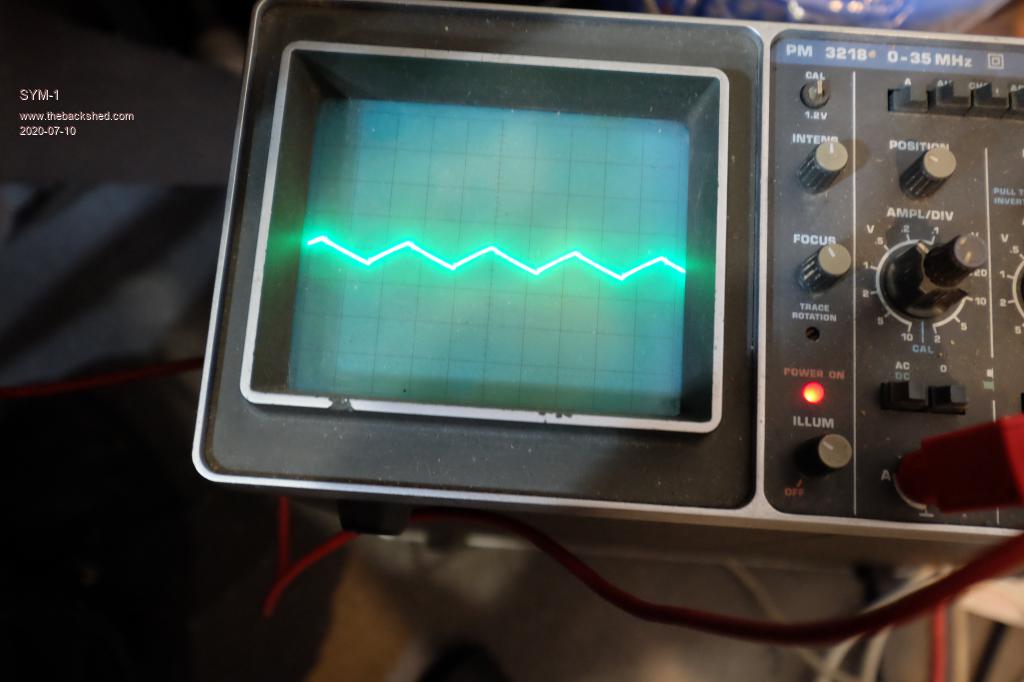

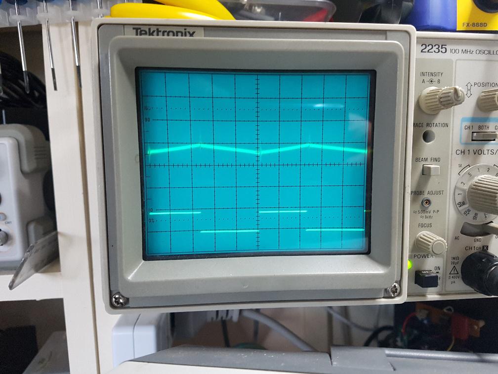

And for those who say "yeah but I don't have one of them fancy digital oscilloscope thingies so how will I see anything?"
My standard test of 20kHz, 110V, 2kW
Here it is using the Tek 2235
Let's build a few and see what they do.
Posted: 07:58am 05 Jul 2020
Oh yes !
Looking really good there Peter

  poida said  Under the heading of "pics or it didn't happen"
Poida, just out of curiosity, on your picture the little display shows "17C & 21C" as the last item in the first two lines.
what does that indicate?
thanks.
poida
Joined: 02/02/2017
Posts: 1507
Posted: 10:58pm 07 Jul 2020
Those two numbers are the temperatures of the heat sink and the inductor
The when under any sort of load the inductor will be hotter.

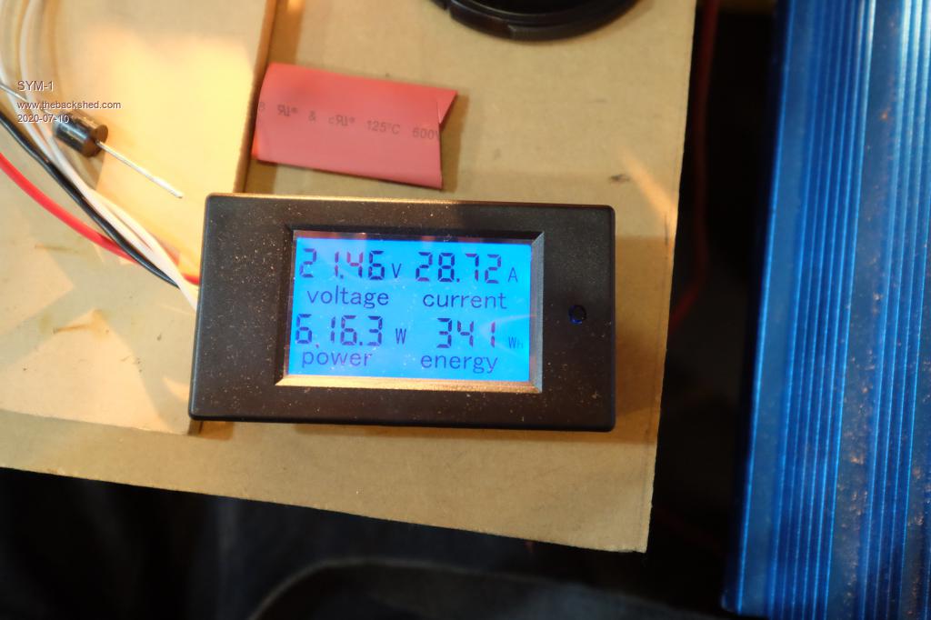

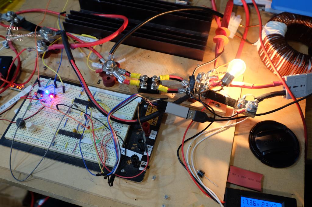

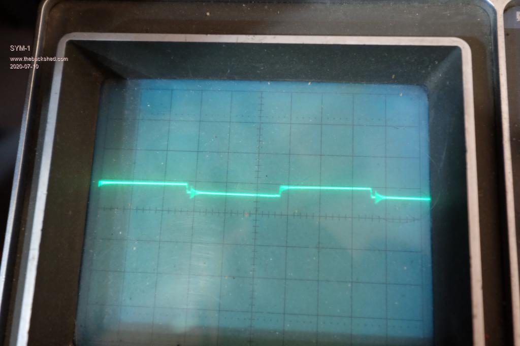

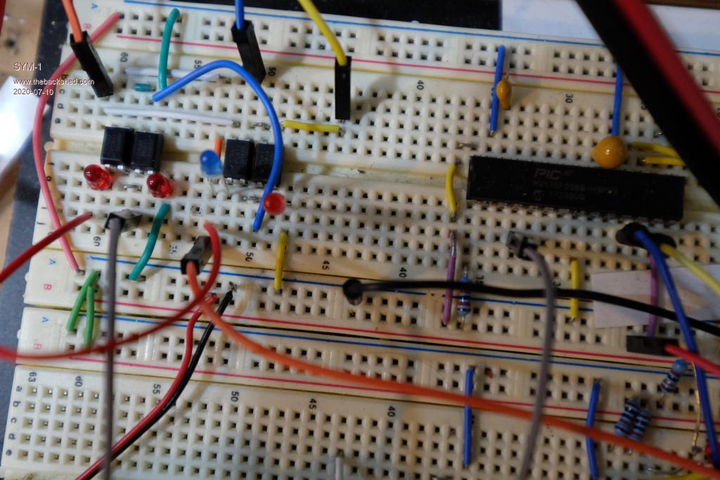

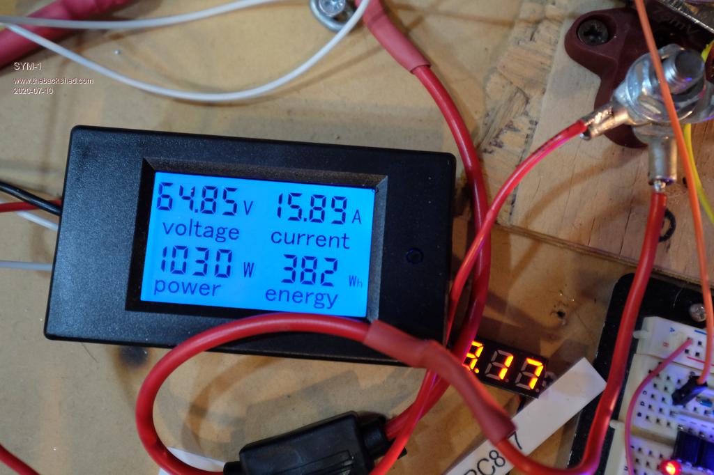

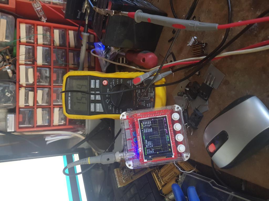

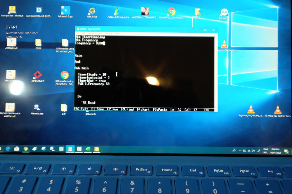

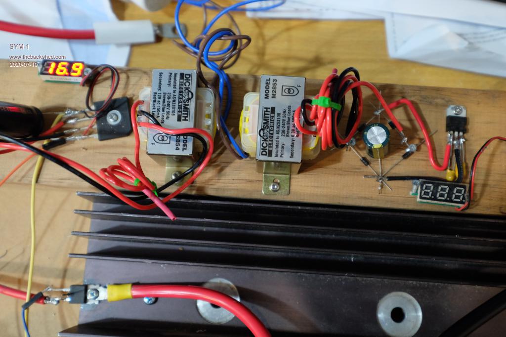

Joined: 18/10/2019
Posts: 47
Posted: 06:43am 10 Jul 2020

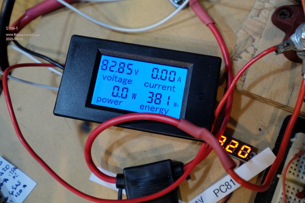

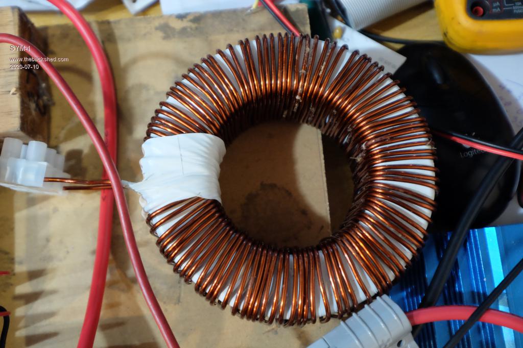

I haven't populated the boards yet and I only have 100 turns of 2.3mm dia on the -2 inductor.  I am intending to increase this to 4 sets of parallel sets of 100 turns yet to get the resistance down.
Losses are still quite high.
Some of this is due to my slow gate switches using 2 sets of PC817 in a DCOI arrangement.  I used 2 sets because if you one set you get inversion and the micromite I am using to produce the PWM signal defaults to ON if the program stops so I get full voltage across the output.  I have been through a few fuses and $3 FET's.
I am using a IRFB4115 FET for testing.  The diode I am now using is a VS-UFB280FA20 from RS.  It is 45ns and 1.1V drop at 120A.  Two diodes in the package.
So losses probably high due to 3 things
-DCOI
-losses in windings
The DCOI is quite slow on the rise time but the upshot of this is I have no switching noise.
I plan to try out the FET's everyone else is using plus one or two other FET's I have once I am happy the circuit is stable.
I blew up my first pair of diodes - they were 10A diodes (2 of them) but they blew up at about 11A.  The diode I am using now is rated at 175A and 200V.
Here are some pictures of progress so far.
Voltage In
Voltage in drops a bit because I have a 1 Ohm resistor to stop inrush at the moment.  Here is a picture of the input pulling 1kw from my batteries.
Here is the output
Here is the trace of the output voltage across 0.75 Ohms.  I am getting about 5V swing - 6.6A
I am running at about 8kHz.   At 20kHz I don't get as much transmitted energy.  Maybe when I speed up my gate drive I will be able to increase the frequency.  I get a bit better efficiency at higher frequencies.
Here is a picture of the test bench.  The FET is on the big heatsink.  It does not get off cold.  The lamp is a 24V lamp which is my highest target voltage at this stage and gives me a good idea how the circuit is running.
The micromite monitor

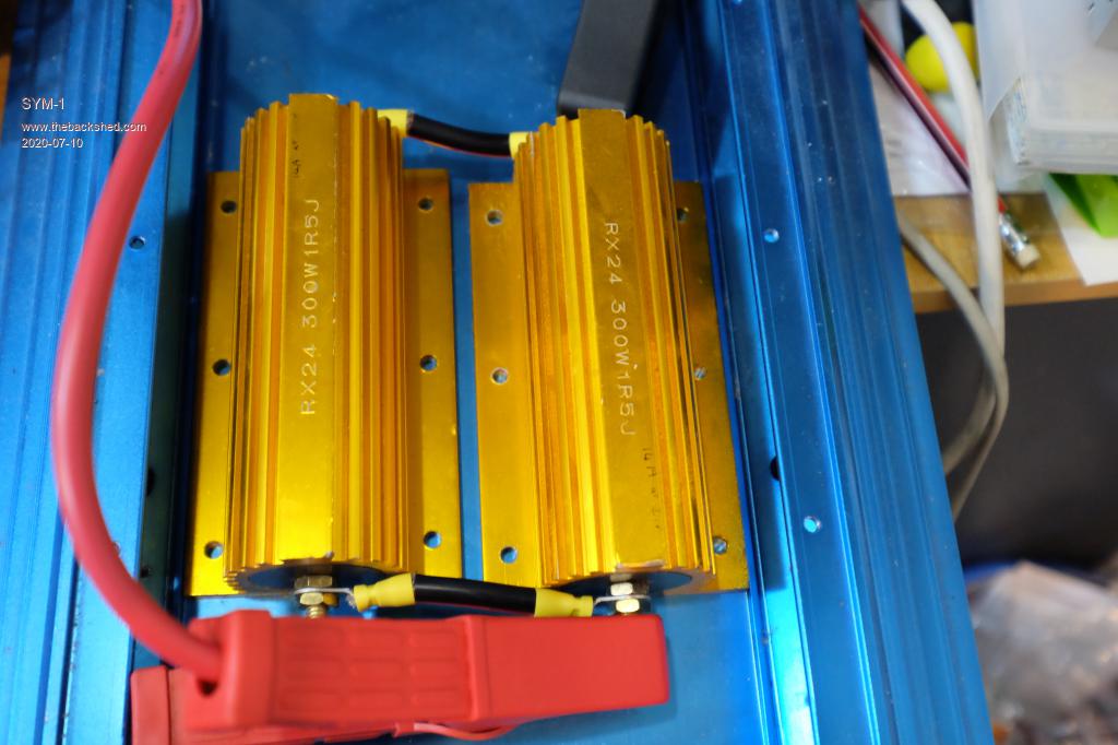

The load
The DCOI driver using PC817's
The 5.2 inch -2 inductor with 2.3mm dia windings
Here is the gate power supply.  I think there is some advantage to limiting this 16.9V to 12V to speed up the gate.  I will try that in the future.

Here is the swing once the batteries are hooked up - 9A or 18A makes no difference to the voltage trace.
When I hooked up a 33000uF 40V capacitor to the output the oscilloscope output was just flat.

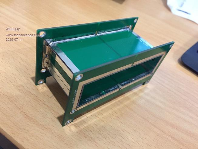

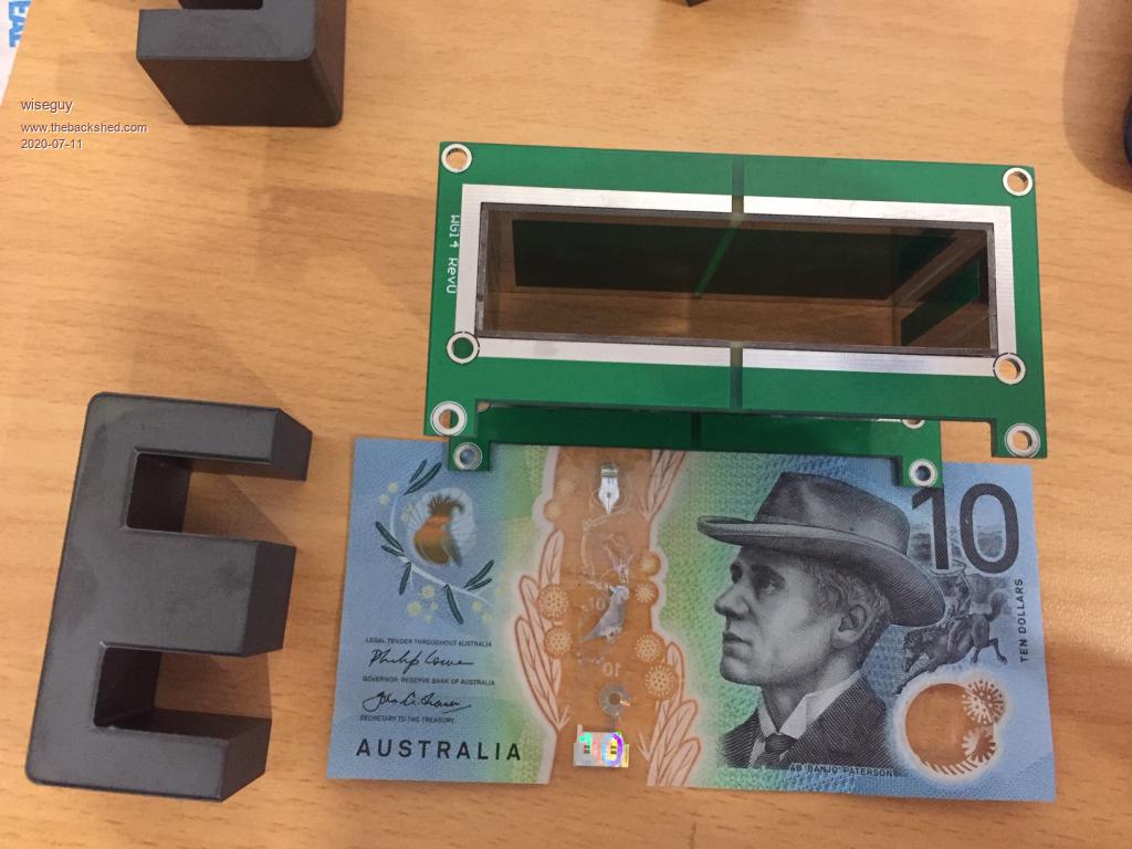

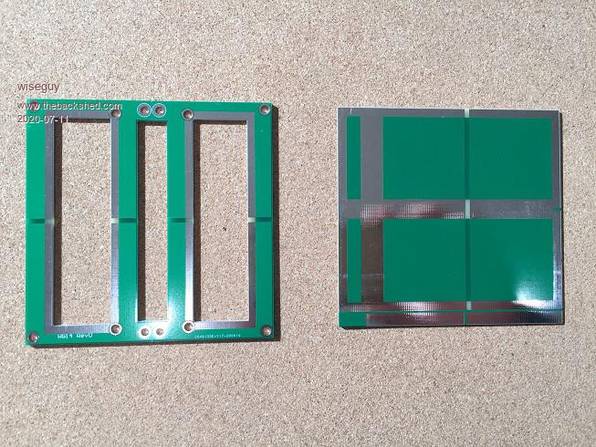

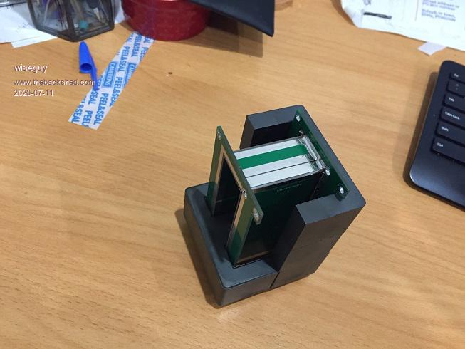

Ok finally found a few minutes to post some pictures of the bobbin I created for the triple stacked EE65 cores.
The PCB design as it arrived.
Cut up and assembled (soldered along joints).
Against a bank note for size reference.
And with 3 x 1/2 cores on 1 side and 1 x 1/2 core other side for a cut away view.
Funny email from PCB maker - Sir we think you have forgotten the drill file - er no there is no drill file. But Sir I dont think we ever made a pcb with no holes. Ok well theres a first time for everything I guess. Please make it as is - there are no holes.
The material used is 1mm for the inner bobbin webbing, the two side pieces are 1.6mm thickness.  Cost for each prototype order (10 pieces each) 2 x $7. I ordered it with another job so freight was free. Each bobbin cost to me $1.40 in pcb material. The finished assembly is seriously rigid/strong, I reckon I could stand on it without breaking it. I will need to file the sharp edges at the 90 degree bends though as they would cut into the wire.
The astute will notice a gap in the copper along the centre of the bobbin - this was to avoid a shorted turn.
Hopefully I can get some turns on it and have a play with the saturation tester soon. My FETs should arrive next week so I can finally build up a whole unit. If it works as expected and anyone wants one, they can be flat packed ikea style and posted in an envelope for ~ $1.10 no alan key required !
