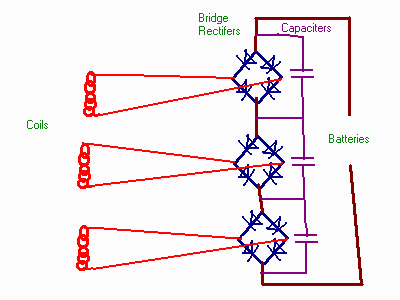

i,m not fully sure about the diagram...i,m trying to rembember it but probabely getting it wrong....nothing new there then....
its something to do with adding dc voltages through capacitors ..
the input is three phase Pete , each start and end are brought out and rectified
independently then the dc voltages are linked (added ?) through the caps ,
i think some people used it on fieldlines with car alts to get higher voltage from an existing stator without doing a rewind ....
the way i look at is , its kind off like charging three small batteries in series
then taking the sum of all three as an output .....maybe i,m just losing it...
i rembember playing around with it a long time ago and think it did work in some form
i try to find that old link....that should help
niall
niall1
Joined: 20/11/2008
Location: Ireland
Posts: 331
Posted: 05:30pm 14 May 2010
bugger...i knew i was raving...sorry about the failed auto cad experiment Bob
pic from wooferhound on fieldlines and a link
http://fieldlines.com/board/index.php/topic,143290.0.html
edit...this topic came up much further back as well but its tricky to find it
looking at the circuit now ....it doesent look like a conventional cap doubler circuit...the boost is on the dc side...??.. Edited by niall1 2010-05-16

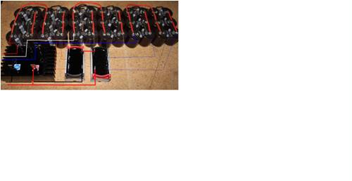

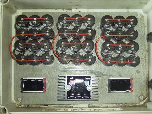

Gordon, I have sent you a PM for some advise on caps. I could not send a photo so I thought I might as well post it here so all can see. I still have trubble getting my head around the cap doubler but here goes.
I have 36 X 330 uf 250volt caps 2 X 50 amp recs and 1 X 100 amp rec and the recs are three phase. I heed some help to work out the wiring as I have not worked with 3 phase recs before. From what I can gather I was going to run the 100 amp as the main from the Gen and use the 50 amps with the caps. There is some wiring on the caps and I have posted a photo. As you can see the caps are in groups of 12.
AMACK
*Note to self
1. Make it thick
2.Make it heavy.
fillm
Joined: 10/02/2007
Posts: 730
Posted: 07:11am 20 Jul 2010
Hi Amack ,
If you lay out your bridge recs like this the wiring flows a bit better
I will send it to you by email as well as it might be a bit small and you can use zoom to enlarge it

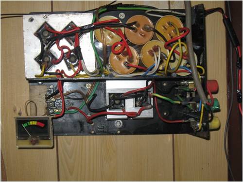

Posted: 09:43am 28 Nov 2010
Hi readers,
I have had the opportunity to test my 48V wound stator on a 24V battery system.
The rotor was stalled heavily by the alternator with this loading. I was able to get the mill working well with 3300uF of back to back series caps in each phase lead. There is a down side in that the caps do not load adequately at higher power levels, and it is necessary to have windmill rpm/output voltage sensing, to activate a diversion loading, to prevent windmill overspeeding.
It looks like the best arrangement is the voltage doubler to load the windmill at low rpm, rather than to unload a windmill that has stalled behaviour.
Gordon.
PS: will be making a new stator with half the turns, as this will allow the direct 24V connection with a cap doubler to pick up low wind power.
It is still best to get the turns close to right for the system voltage and optimum rotor rpm for cutin.
Posted: 12:39am 12 Dec 2010
Hi readers,
The stator mentioned above was originally 215 turns per phase, with 75 turns per coil. I could not get it to work aceptably on 24V. I opted to rewire, rather than make a new stator. This stator had appreciable hum when producing power.
I separated one coil from each phase and rewired the remaining coils in star. The separated coils were reconnected to the interconnection points of the 2 coils on each phase, to make a parallel set of coils. I kept the star points separate.
The output connections were just to the ends of each phase wire from the 2 series coils. I connected a cap doubler and main rectifiers to the system. The performance is per this link
The dot curve that follows the green line is with the cap doubler, compared to the more straight dot curve that is without the cap doubler.
As it turns out, the windmill is now almost silent, and the output follows the wind energy. There is a dull hum only, but nothing like it was. The caps have changed the loading significantly, and have allowed current to flow through the windings for a longer percentage of the time, even though still connected to the battery. The clipping of the AC waveform that normally occurs with rectifiers and a battery is softened by the effects of the AC coupled caps.
The rewire is not a traditional arrangement, as I wanted to use as much of the original copper as possible. The output is still appears very sinisoidal, and there is no drag when spun unloaded. The winding was tested in delta originally for 24V operation, and there was considerable drag when spun unloaded, indicating circulating currents in delta. Individual phase rectification was considered and rejected as it would have required rectifiers on the mill.
It turns out that the cap doubler and a rewire has allowed me to reuse this stator, and I will not need to make a new one.
Gordon.
PS: the caps were 4700uF and 35V, low ESR. At full power, approx 1000W windmill, and 4-5A through the doubler, the SMD rectifiers rose approx 20deg above ambient, and the caps rose 18deg. If I had 3300uF @ 63V, low ESR, these would have worked as well.
