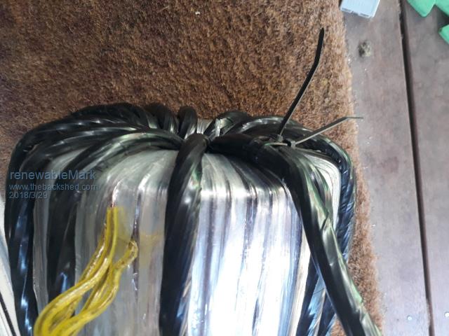

Yeah I have all the primary cables flat against the top and base of the torroid, so it's not that.
I did 4 windings of 128 as well so that would have added height.
The primary cables aren't the problem, it's just overall height.

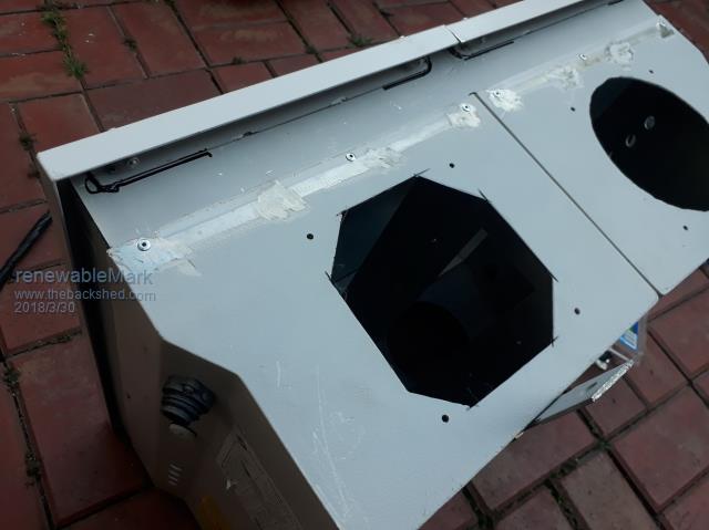

I made up some plates and extedned the front by 50mm.
Took the mounting plates off the aerosharp and fitted them to the extension.
Now I'm thinking, BUGGER, I could have not cut the heatsinks down so much.
Oh well, second one will be a ripper, this will be my reserve unit.
Cheers Caveman Mark

Using old wire is much harder due to hardening.
Make the extension a bit longer and you could add another core as well. I was thinking the same solution if you did not find a way around it. It still surprises me that the toroid would not fit.
Don't worry about the heatsinks, they will stay cool, it is the transformer that gets hottest and is harder to cool, once again though it is not an issue with decent fans. You will find the rotation of the case with fan holes top and bottom will cool itself most of the time without fans, especially in chilly Melbourne weather.

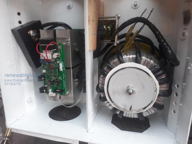

Made a bit of progress.
I got a forklift battery too, it's only 620AH @48V, not as big as I would have liked, but it can be replaced or added to.

Re case, it got primed and sprayed white inside, just a nice and fresh look.
That black box on the left is a project box for the neg dc shunt, haven't worked out how I'll mount that yet.
I clamped the ferrite core with capton tape the way Klaus does his, but I just butchered a clamp by smashing some 4mm al in the bench vice redneck style.
I'll have to look into the other choke he uses, I'll just try and get something working first and make refinements from there.
Once this is tested I'll add more mosfets and with some luck it doesn't go pop.

Posted: 10:29am 15 Apr 2018
A little tip Mark, place that shunt on the negative battery terminal. You do not want to clutter up your very limited box internal space with things than need not to be in there unless you also are planning to fit the corresponding Amp meter into the lid.
However, having this shunt on the battery terminal (and a separate Amp meter for it) lets you monitor current IN and OUT of the battery with the same shunt. Much more useful IMO.

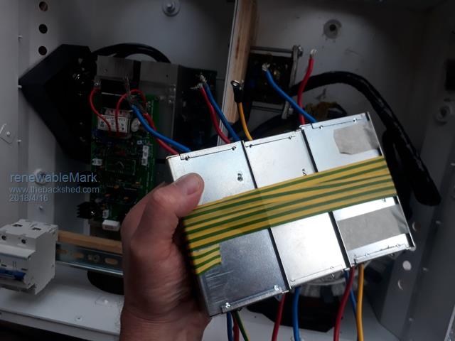

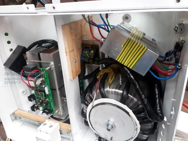

Thanks Tinker and Mad for that advice, it's a bit of a narrow spot that, so not much can go in there anyway. I did want to fit a meter on the inverter so I could know exactly what that unit was doing, not just the overall V in and out of battery, but that is a great idea too, shunt and meter combo's are pretty cheap so I'll get another for that too.
The issue I am having now is fitting the filters.
Unfortunately, the torroid is mounted a bit high, so it's too cramped to fit the filters vertically on the case next to each other.
What I thought of was to mount all three vertically, they'll need an al seperator, then bolt the lot down with a clamp similar to the way the choke got done.
Anyone see an issue with that?

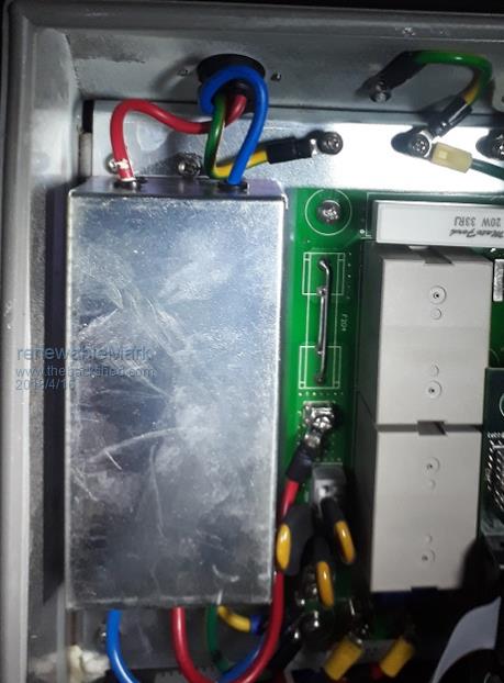

Posted: 09:06am 16 Apr 2018
Mark, these look like the filters you got out of an Aerosharp box. I was told they are DC (solar panel) filters and not a good idea on AC in the transformer output, but I might be wrong - it was a while ago.
Why not get some proper 50Hz AC filters, like the ones you see in my or clockman's pictures? I think there were 7A versions in the Aerosharp but you need to parallel quite a few for 6KW. I bought the 20A version from RS electronics, fitted two in parallel.
You might also find them on e-bay.Edited by Tinker 2018-04-17

Posted: 10:19am 16 Apr 2018
Pretty sure they'll be OK as it's the last thing connected before it goes to the AC output on the aerosharp.

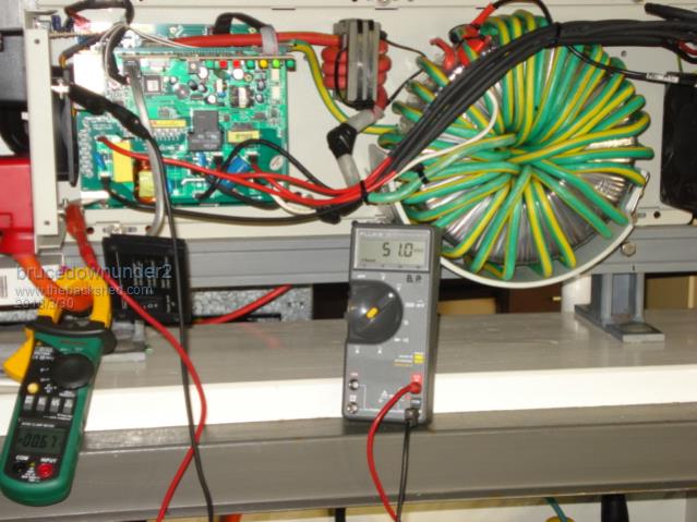

This is a pic of my last one that's still complete. The outputs go to the black plug which is grid connect.
Cheers Caveman Mark
