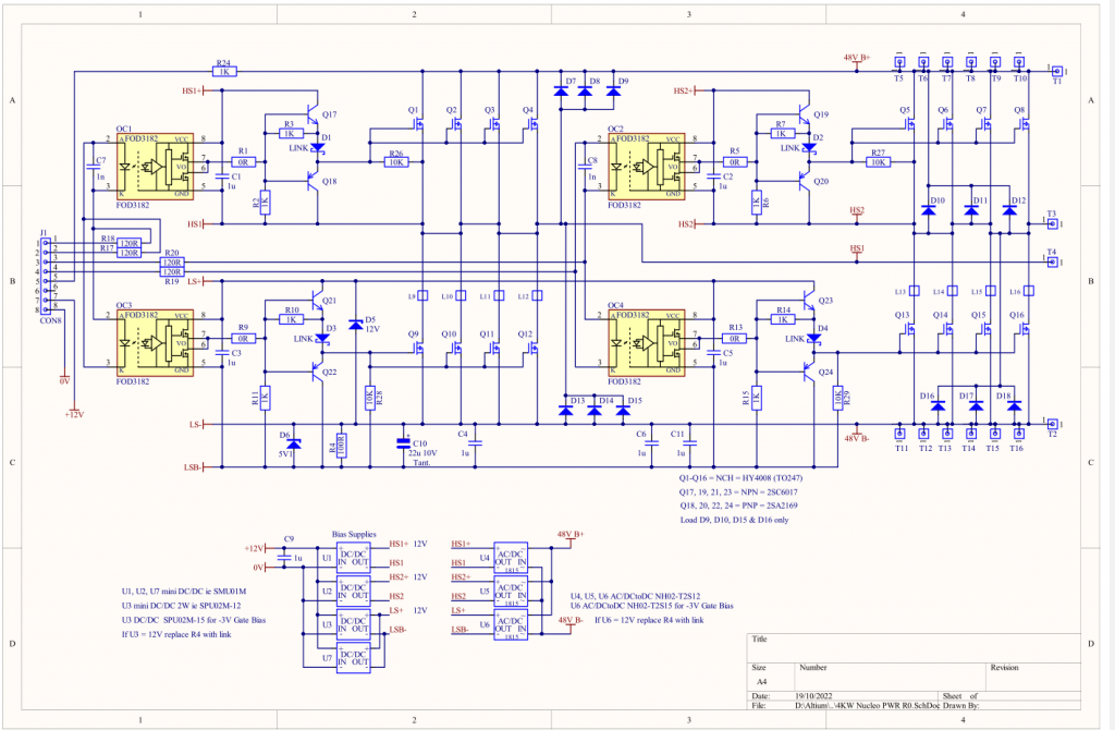

Wiseguy designed the Power board for 5kW continuous and peaks of 10kW:
I have peaks starting currents above that and when you have a few workshop induction motors running, and then start another peice of equipment that causes the over current trip just has the new load is spinning up, well I would not like to see the sort of collapsing fields and back EMF that would have been presented to the Toriod from those induction motors spinning down.
As Mike [Wiseguy] pointed out concerning D16 failure:
"The MUR420 diodes were there to save some heating of the FETs internal diodes, at the time the FETs were going to be HY4008, however I am using HY5608s.
The HY5608s essentially run cold but with high currents their increasing forward voltage drop which can be as high as 1.3V @ 180A would then force excess current through the MUR420s which I think is what killed D16.
There is no data I could find about the peak HY5608s forward current but it is stated as 360A continuous, a slight upgrade from the 4A & 110A absolute peak of the MUR420.
The HY5608 FETs forward current is also 360A continuous and ~ 1290A peak, I would expect the peak diode current to be at least ~ 1000A"
The Diode spilled it's guts and blackened 20mm area under and around the Diode, a quick rub with PCB cleaner and the PCB was like new.
The FETs were physically as new, however that diode would be a dead short to the upper FETs and two on the upper and two of the lower FETs on one side were shorted.

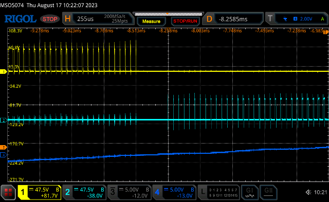

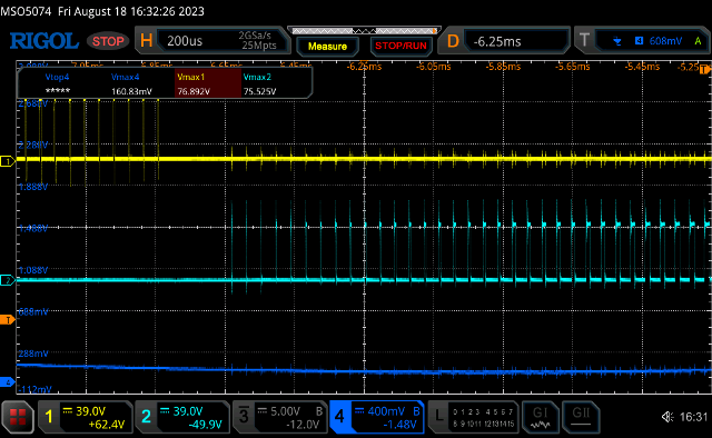

A question I have is regarding the long period of ZERO PWM between the HI and LO side PWM.
Some of the noise is due to DSO Probes connections.
Here is the output from T3 and T4, both referenced to T2 which is 48V B-.
Blue is AC out.
Now here is the PWM zoomed in:
There is around 230uS between the last PWM pulse on the upper side and the start of the first PWM pulse on the lower.

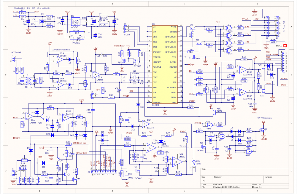

FYI The New Test controller circuit.

The real question I have is around that 230uS long dead zone between HI and LO switching transitions?
I feel something is slightly off but I'm second guessing myself, going back through old recorded DSO and Analogue Storage scope display frames to see if anything obvious  stands out.
In the mean time I'm just posting the DSO frames to see if anyone can shed some light, keeping in mind that this is not a standard 8010 modulation scheme.

  KeepIS said  Thanks for the suggestions,
This may not use the intended 8010 modulation scheme but the HF PWM pulses it outputs are from the same internal source.
It took a while to find but I was sure that TinyT and myself had similar posts about EG8010 waveforms. I found TinyT's post first Here (Jun 2018!! ) and you can see the absence of pulses when finishing one 180 degrees half cycle and beginning the next 180 degrees a pulse absence of a bit more than 200uSecs.  In case the link is flawed it is the top picture on page 10 of the thread.
So it is inherent behaviour and not a fault you are looking for, the energy content at the zero crossings - for a resistive load - is essentially zero so there is a very minor distortion component just near the zero cross of no consequence, the 50Hz sinewave looks fine on the CRO.
Edited 2023-08-17 20:37 by wiseguy

Mike, thank you for that link. I vaguely remember reading that thread, but just so much to go through in between the ongoing Bathroom Reno and cleaning up the mess I'm making, I hate pulling out plaster board and tiles, the mini Skip is nearly full.
I did find an old screen grab from the previous China Inverter and it "appeared" to be there as well.
This is great, it was the last thing I wanted to confirm before diving in and rebuilding the AC filter and then finalizing the Current trip points for AC current and Peak DC inputs, and getting the Toriod Dual Fan trip points set up.

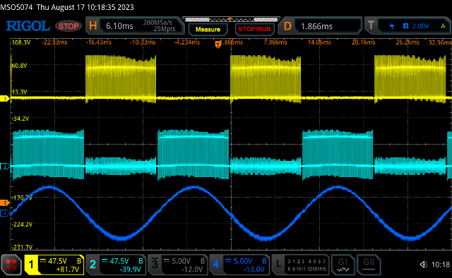

I improved the Probe connections to the Power Board outputs from T3 and T4, as before both are referenced to T2 which is 48V B-.
I also added one more 10,000uF to each CAP board for a total of 40,000uF across the two boards. Adding the extra CAPS made an improvement to Peak DC input current waveforms and PWM ringing.
Blue is AC out.
Blue is Peak DC input Current of 100A and AC load of 2.2kW
220us HI / LO switching point.
It may not be apparent from these DSO captures but the overall waveform noise and ringing is noticeably improved, especially the duration of leading and trailing  ringing under varying load conditions. So I'll keep it at this CAP value for now.

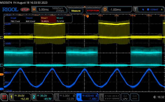

FYI: The DSO screen grabs shown a few posts back are all running under 2.2kW load

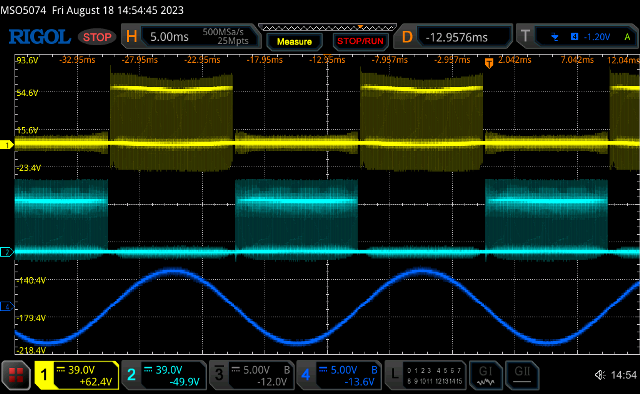

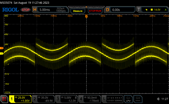

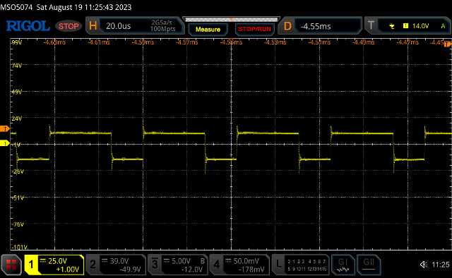

For what it's worth, a quick look across each Choke, the waveforms are identical across both chokes so I'll only show one, 2nd zoomed in.
25V per division, apology for incorrect LH scale offset.
Edit: It's a bit hard to see every second division for some reason, but there are 8 vertical divisions.
Edited 2023-08-19 13:12 by KeepIS
