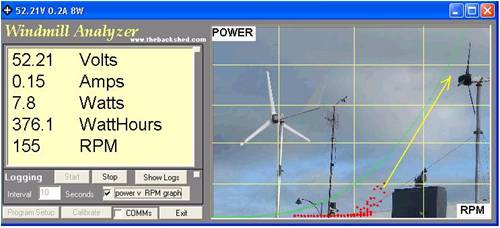

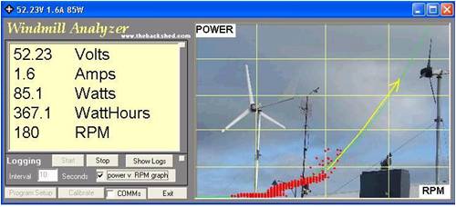

The testing of my new arrangement confirms the theory.
Here are some graphs of with and without the cap doubler today.
firstly without.
and with new simplified cap doubler
You can see a bit larger spread in the data set, but it is clear that the cap doubler has reduced the cutin to approx half the rpm. This is not optimized yet, as I just used 6 caps I had on hand.
There were no mechanical changes to the windmill, and these readings took approx 10 or so minutes to obtain. The windmill does sound a little different at the low windspeeds, with a slightly lower [loaded and producing output current] rpm. The swish/swish noise that occurred with the essentially unloaded mill has gone.
I did not have to use any data manipulation tools, and this was essentially obtained in real time. You will note that the windmill needed to produce approx 44Wh of power to confirm a better output loading curve.
The componentry is contained into a small package with the reduced cap count.
Gordon.

Posted: 01:07am 05 May 2010
Hi Readers,

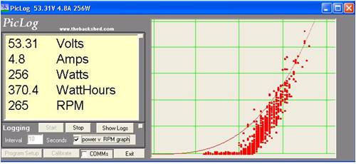

The spread in the data in the graphs above turns out tobe related to the measurement of rotor rpm.
I have some new graphs of without and with caps performance in light wind conditions.
The scatter at the higher recorded power levels are the peaks of the wind gusts recorded at the time. These are low wind speed data. [< 5m/s] The power range on the Y-axis is from 0 to 1000W, and the RPM on the X-axis ranges from 0 to 400RPM This is a 3m rotor windmill, with an Axial Flux alternator.
First is a measurement on the windmill without a cap doubler.
you can note the cut in at just over 200rpm, with some scattered data points above cutin.

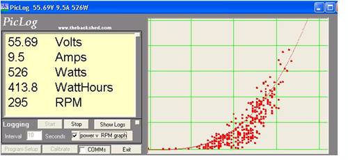

The next is a chart with the cap doubler turned on.
The caps clearly allow the windmill to produce more power at the lower rpm, with a cutin at around 100 rpm.
I have added a yellow line where the output power curve of the windmill would be expected to follow, in comparison to a calculated theoretical.
It should be noted that this is not an exact science, but allows an individual windmill to be modified and see how the mods affect its performance. This is not intended to be a scientific windmill performance evaluation tool.
There is a fair bit of area under the green line where the windmill without caps would be producing less power at the lower windspeeds. The caps do not hinder performance at higher power levels.
The main benefit with this arrangement is that a windmill can be wired with less turns of thicker wire and still produce power at low windspeeds. The thicker, shorter wire results in higher winding efficiency at the high power levels.
This will benefit iron cored, and slotless alternator windmills.
Gordon.

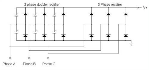

which in a convient 'Segway' bring me to the point of this post:
I reckon Gordon's new 3 phase rectifier + 3 phase voltage doubler could look like this:
Only 6 Cap's in total!!
I was trying to remember where i'd seen this kind of circuit before, then i remembered, the input stage on a computer PSU: The 220V - 110V selection switch just connects the AC side of the bridge rectifier to the midpoint of the capacitor string.

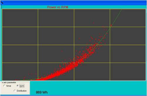

Posted: 01:53pm 13 May 2010
I have just run off a plot of part of a days operation of my windmill with the new cap arrangement. This was just under 0.9kWh produced, and the wind was light to medium, as is seen from the power distribution dots. The power was up to 1000W, on the Y-axis, and the RPM was up to 400 on the X-axis.
This is the power vs windmill rpm. The close relationship between actual power dots and the calculated green line power curve is evident.
By using my windmill analyzer, that will soon be available as a software component that will only work at the moment with a new logging kit, I was able to visually see how my windmill worked, and I was then able to build a cap cct to suit. Anyone with a windmill and access to a computer would be able to use the analyser to measure actual windmill performance. The shape of the output curve will determine if the windmill is corrrectly loading, and the windmill analyzer can be used to check the loading following corective measures. I should say that the performance of any windmill change, say for an AxFx windmill, be it blades, stator, air gap, capacitor multiplier, etc can be verified. The real time setup of an electronic MPPT is possible as well. Even a commercial windmill can be analyzed, and corrective measures determined.
On this note,
The task of working out what to do has become a lot easier now I have my analyzer.
I would think that there are many readers with a windmill, who could benefit from this type of tool, and who should make a positive effort to pass on their interest, either to Downwind or me. The amount of interest will determine what is offered.
Gordon.

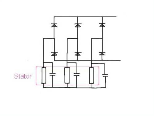

turnymf
Joined: 04/10/2008
Posts: 84

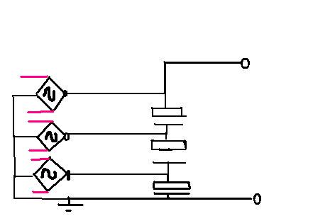

Posted: 01:06am 14 May 2010
With only 3 caps, there aren't that many combinations possible
I would have a guess at this one
cheers
niall1
Joined: 20/11/2008
Location: Ireland
Posts: 331
Posted: 02:08pm 14 May 2010
ermmm....with 3 caps and 3 seperate rectifiers this would be kind off like rectifing
each phase...then using the caps to series up the dc outputs and bump up the voltage ?
Edited by niall1 2010-05-16
