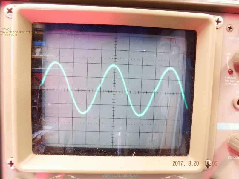

Finally managed to track down a fault that had me bamboozled for some time (and cost me a few HY4008's ).
For some reason on one low side the TIP41/41C pair had gone kaputt. One went open circuit, the other short. The associated iN5819 diode also shorted out. I have no idea why or when it happened but this fault produced some very odd symptoms.
Anyway, its working fine now in my test set up. Just 4 Mosfets, one capacitor and a smaller (~2KW) test toroid. That did 1130W easily and the small heatsinks got barely warm. I guess I could push more power through but with the full 24 Mosfet complement the inverter would make close to 7Kw which is plenty for me.

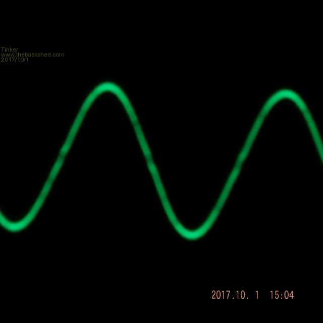

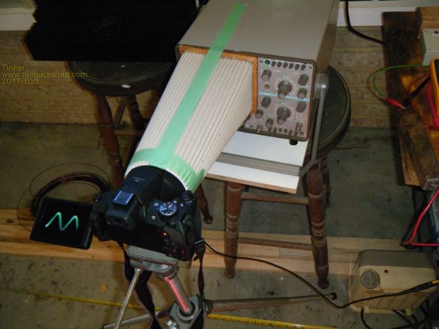

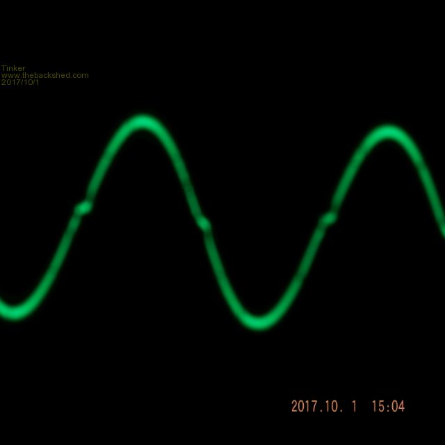

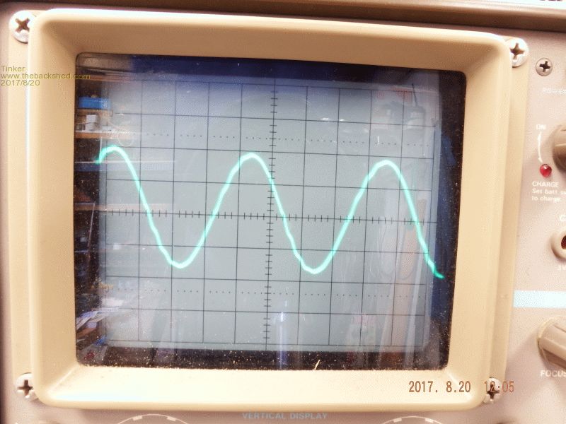

I took some pics of the sine wave (sorry about the poor quality, I need a CRO - camera hood) but the waveform is now the best I got yet from this inverter.
First with no load, a few tiny wiggles:
And it gets even better at 1130W:

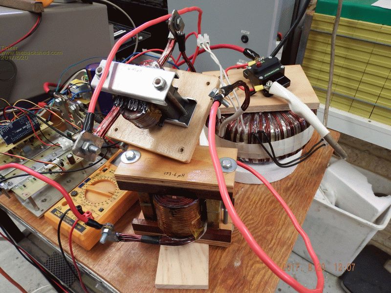

So it appears my large air gap chokes do work. I used one on each side of the primary:
The large one is made of two of the Aerosharp choke cores as discussed earlier in this thread, it measured 173.6uH.
The smaller one is the standard ferrite E65 core with 4 turns and 2.5mm gap (4.45uH)
The no load idle power was 11.5W with that toroid. I guess this will go up a little with the bigger magnetising current of the double stack toroid.

Excellent results there Klaus, looking really good !
Those faint wiggles look to me like some high frequency self resonance in the toroidal transformer, probably in the low Khz range.
You might like to try lowering that resonance to as close to 75Hz as you can get it with a suitably rated capacitor connected across the secondary. A very rough starting point might be a couple of microfarads.
Try tuning just the bare transformer with an audio frequency generator to as close to 75 Hz as you can get.
That should further attenuate any faint residual PWM, and may also reduce the tendency for any odd kinks or wiggles, particularly at no load.

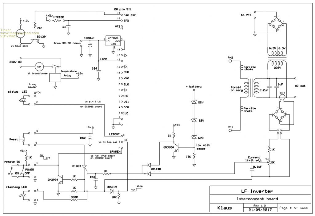

The comments from oztules regarding these inverters lacking a low battery voltage shut down had me thinking I should incorporate this idea too.
However, subsequent posts about using nanos and whatnots to do this task are too complicated for me.
So, for at least my lithium battery bank, which does not suffer high load voltage sag,
the very simple circuit below works just fine.
The zeners stop conducting below 50V battery and trip the shut down. It has to be manually re-set.

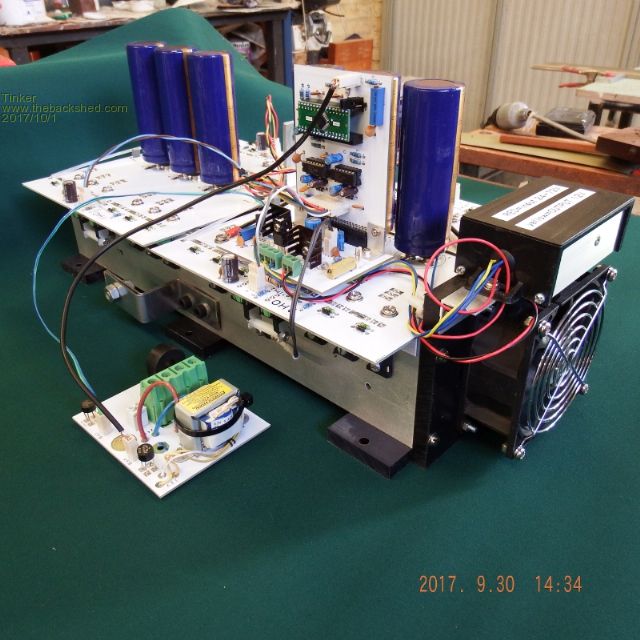

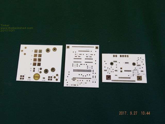

Just in case anybody is wondering why no updates in over a month, well, I have been busy...
PCB's made in China seems to be all the rage so I joined this idea and was pleasantly surprised with the results.
This also gave me an excuse to completely re design my inverter, also successfully.
Here is the recipe how I did it:

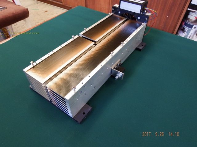

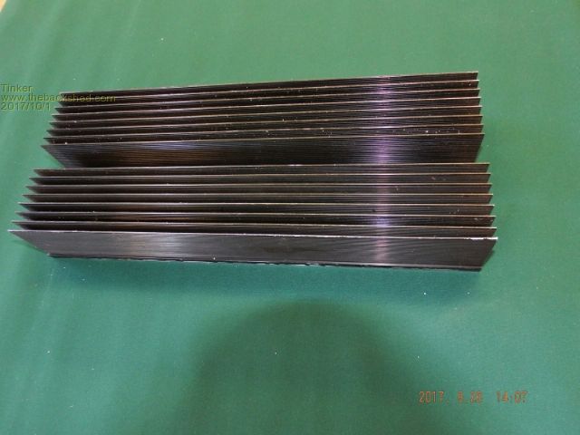

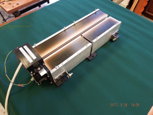

First, take an Aerosharp heat sink and cut it into equal size halves.
This meant the middle fin was cut out. I required a very neat cut as it becomes the high power connection to the PCB. There also must be a 'shoulder' left to space the PCB underside from the heatsink fin.
Next, Trim halves to required length, the long one is 410mm long. Then drill and tap some holes (about 80 actually...), make some plastic brackets and assemble it.

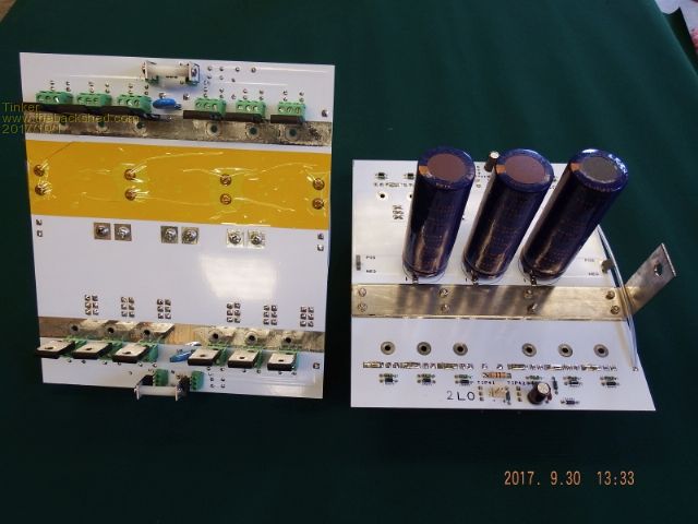

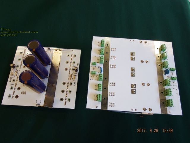

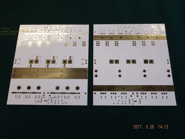

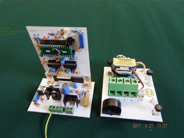

Next, take the two identical main PCB's. Shown below is one of them, left is top side, right is bottom side.

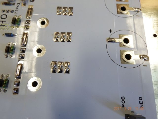

Then incorporate track current capacity increase (thanks warpspeed) and my idea of boosting via current capacity. I did not like the idea of hundreds of tiny vias as on commercial inverter boards.

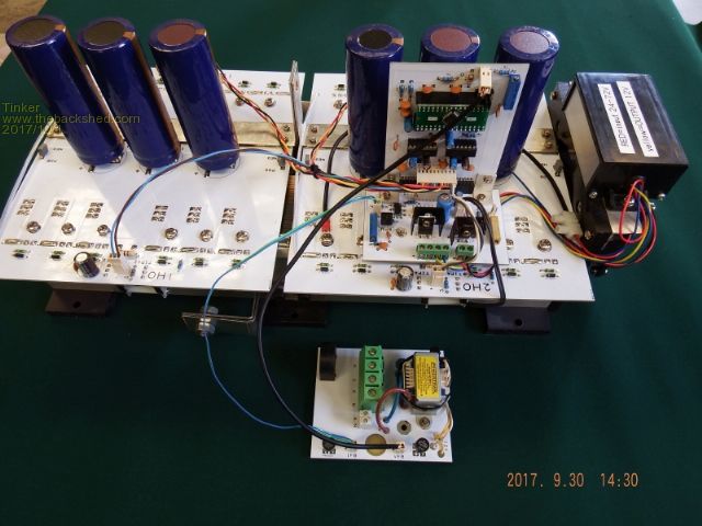

Then start assembling the components. Top & bottom side of one board shown, different size is an optical illusion.
Then, take the three smaller PCB's. All less than 100x100mm.
Solder components onto them as well.
A picture of the main PCB's. The Klapton tape is there because the screws are rather close (~1mm) to the heatsink fin.

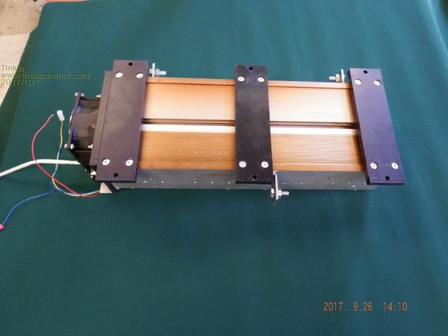

Then wire it all up.
Another view.
So, does it work then? I hear somebody asking
You bet it does.
The magnetising loss of this double stack toroid is 28 Watt.
Using the ferrite E65 core (everybody is using) as a benchmark the loss goes up to 35W at idle. This includes a LED power meter.
The E core, BTW, required a layer of the adhesive clapton tape on each of the core half mating surfaces. Without that there was a high frequency hash over the top of the sine wave trace.
I tried a different way to take pictures of my old CRO screen.
This is the no load wave shape. I could not focus the camera close enough when using the long exposure with this rig.
And this is the wave shape at 6200W load. The inverter could go easily a lot higher but with just a 10KWh battery bank I dared not.
I did wind a 18 turn non saturating choke a while ago. This produced a very nice sine wave up to 2KW but then it started to lean over, quite badly by 3KW. By 'lean' I mean it looked like somebody was pushing from the left at the top peaks of the sine wave.
Presently I'm winding another choke, based on the smaller C cores out of the Aerosharp. It has only 9 turns of 52.5mm sq wire (21 x 1.8mm wire in parallel).
When its finished I'll do more experimenting, to see if that sine wave improves at the zero crossing with high loads.
I will also try different dead times (presently set at 1.5uS). The eagle eyed can see I made this task rather easy .

Very nice Klaus looks like a very expensive bought one.
Once I had it working right I found longer dead time was not good.
I look forward to seeing your choke results, what capacitance do you have on the output of the toroid?
PS, I found turning the brightness of the CRO down and taking a longer exposure with low background light helps with photos.Edited by Madness 2017-10-02
Posted: 02:30am 01 Oct 2017
Thanks Gary, I will try 500ns dead time next.
I use a 2.2uF and 1uF cap in parallel, its what I had in mains rating and PCB mounting.
I did turn down the brightness until the trace disappeared. The camera is on firework setting, now with the hood and no more reflections on the screen I can try other settings, there are quite a few on this camera.
