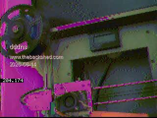

I bought an OV7670 some years ago and never used it. Today was the day I tried it and couldn't get a clear picture, the colours are scrambled.
I tried different GP combinations but with same result.
Can somebody please confirm the camera is running and provide the details?

I tried OV7670 with RC19 and a minimal config and different GPs for I2C:
> option list
PicoMite MMBasic USB RP2350B Edition V6.03.00RC19
OPTION SYSTEM SPI GP14,GP15,GP12
OPTION SYSTEM I2C GP28,GP29
OPTION FLASH SIZE 16777216
OPTION COLOURCODE ON
OPTION KEYBOARD US
OPTION PICO OFF
OPTION CPUSPEED (KHz) 200000
OPTION LCDPANEL CONSOLE 7
OPTION DISPLAY 30, 53
OPTION LCDPANEL ILI9341, LANDSCAPE,GP16,GP17,GP18,GP11
OPTION DEFAULT FONT 7, 1
> camera open gp32,gp33,gp34,gp35,gp36,gp20
> timer=0 : camera capture 2 : ? timer : save image "a:cam_test.bmp"
204.174
Blue looks ok but lilac should be white:
Posts: 12174
Posted: 09:09am 14 Jun 2026
Can you try it with a rp2040 to see if it is a H/W or S/W issue? Do you have pullups on the I2C pins?

The camera runs perfect with this if cpuspeed is >=252000.
PicoMite MMBasic RP2040 V6.03.00RC19
OPTION SYSTEM I2C GP14,GP15
OPTION CPUSPEED (KHz) 252000
OPTION LCDPANEL ILI9341, LANDSCAPE,GP20,GP21,GP22
I will now check with different cpuspeed with the PGA2350.
Posts: 12174
Posted: 01:29pm 14 Jun 2026
I'm running RP2350 at 200MHz with no capture issues but it is clearly now working for you so that's good
