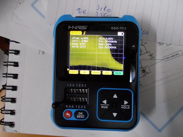

I managed to figure how to get it to grab the waveform on trigger, I got the end of the startup waveform before it wound down to running current. It was spot on in the values returned and the waveform is exactly the same as my big TEC DSO. That was on my second go having never played with the Mini digital CRO before, it's not a true DSO with scroll-able memory, but you can grab the waveform and view it, and it will tell you the correct values.
I need to test it bit more tomorrow, to see if it can reliably trigger and capture the part of the startup waveforms we need, but it looks good so far. BTW it displays the Inverter AC and DC current waveforms perfectly when running as a straight Digital CRO.
It might be something to consider, I think around $75 for this one, likely lower cost units are around, just check the spec as some are nasty, this one was on spec at 500kHz bandwidth and only slightly down at 1Mhz.
Link to CRO
You want Color Set 2, it has the CRO Probe and Adapter $78.

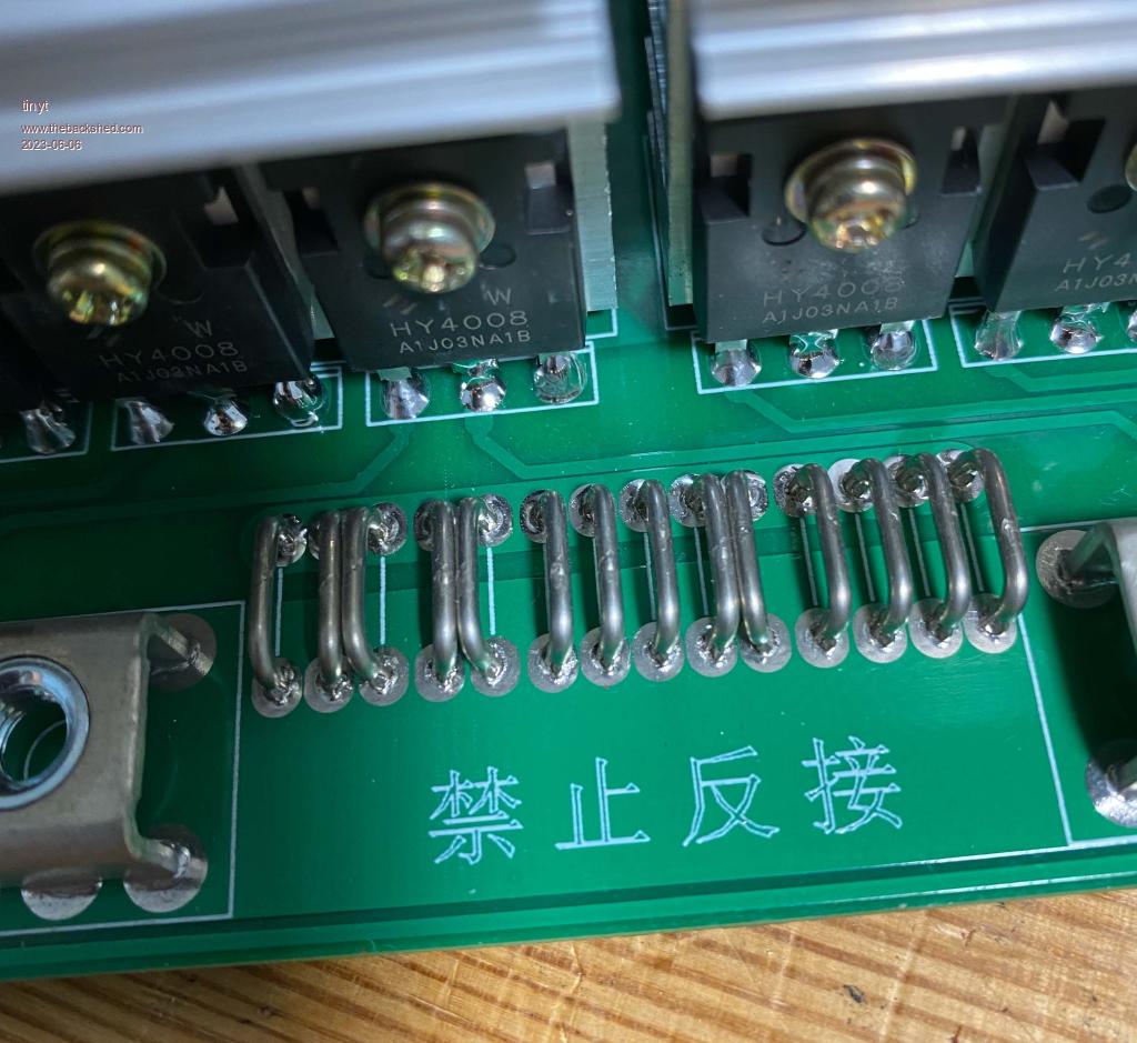

I thought I can use the existing shunt jumpers and opamp (IFB) on the chinese inverter board I am using.

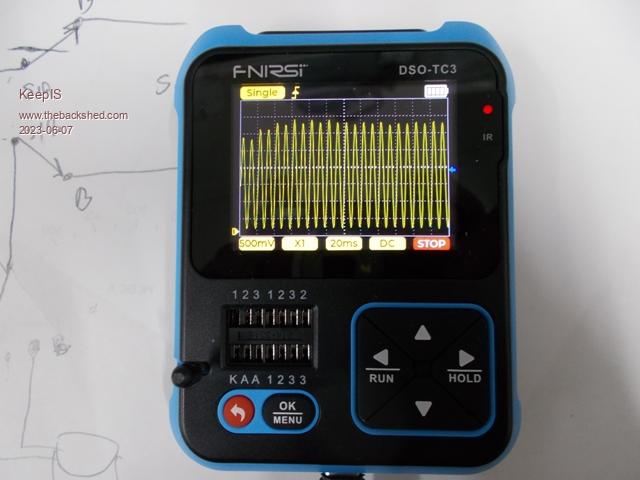

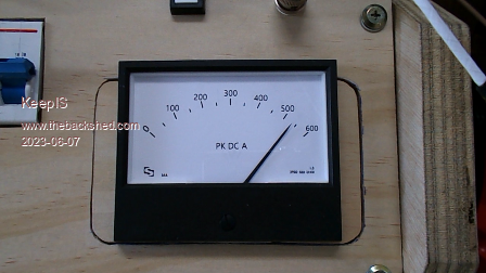

For anyone considering one of the small DSO units I linked to, I carried out a series of tests with various loads, it has no problem capturing the waveform startup and showing the correct values and the captured screen has very good detail.
This has the Display of the Dust Extractor.
BTW This DE is mounted in a 3m high external enclosure.
The value display is toggled off to show the screen display clearly.
Below:
The Meter showing the Compressor startup of 560A -  Pretty darn close.
Note the startup current can vary from around 560A to 587A with temperature, load pressure and other factors.
Edited 2023-06-07 11:30 by KeepIS

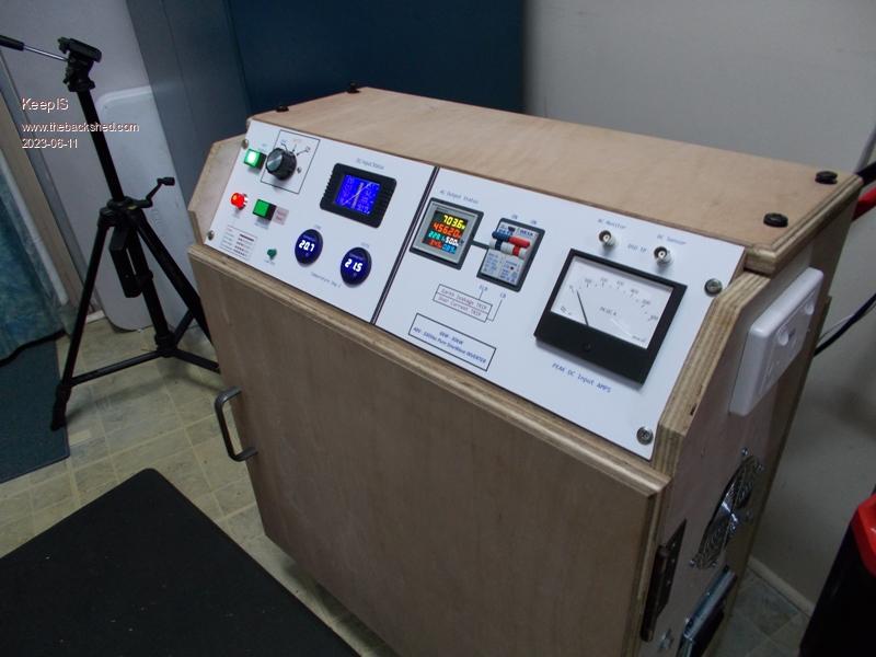

KeepIS
Joined: 13/10/2014
Posts: 2287
Posted: 09:05am 11 Jun 2023

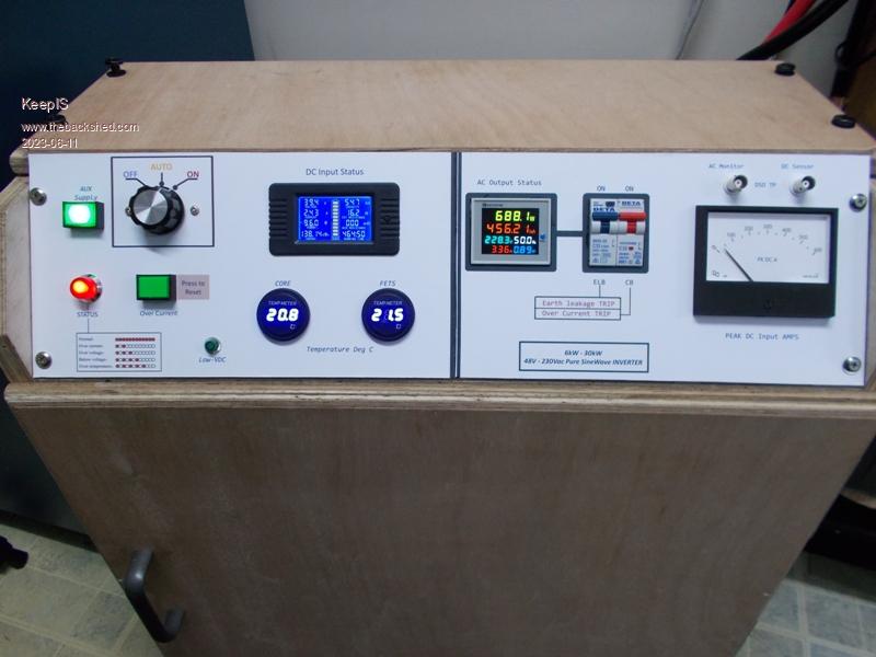

The Beast tarted up
Murphy's friend
Joined: 04/10/2019
Posts: 678
Posted: 02:46pm 11 Jun 2023
Very pretty Mike, what is the display panel made of?
Did you varnish the plywood case or is that not on the list?

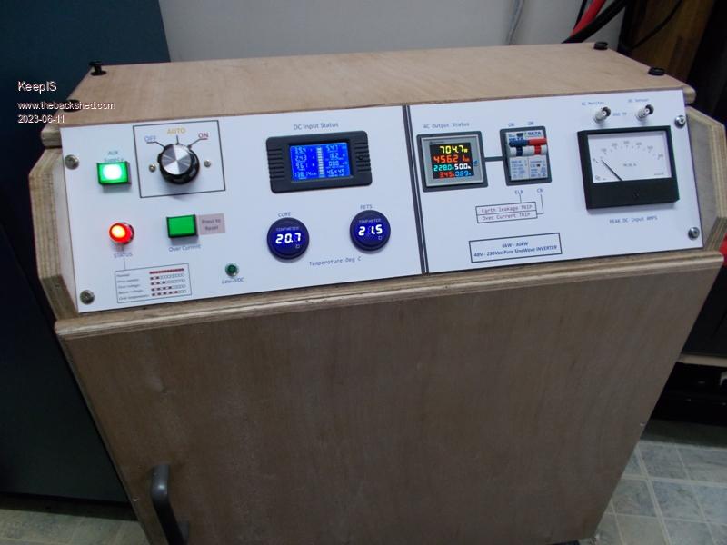

KeepIS
Joined: 13/10/2014
Posts: 2287
Posted: 10:45pm 11 Jun 2023
Thanks Klaus,
The case is about to have its varnish or oil, hopefully I'll finish that today.

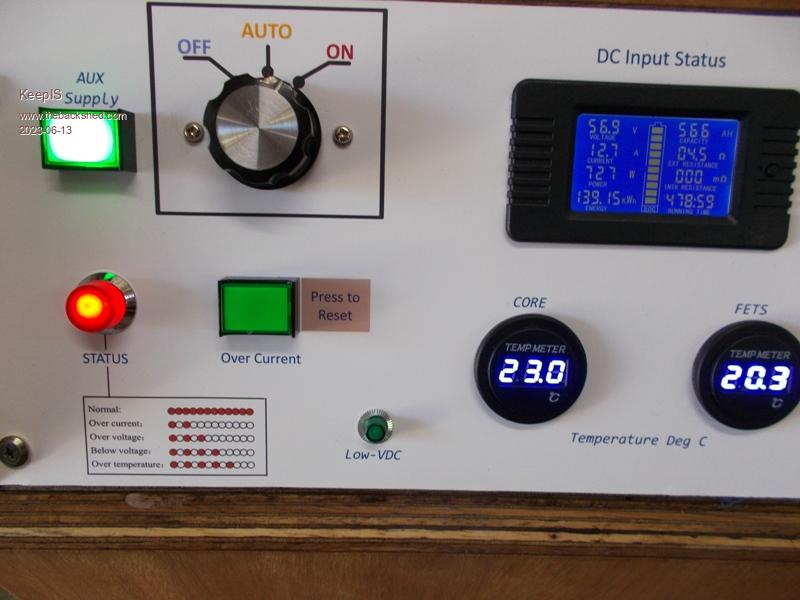

The Display panel finish is Photo paper, I scan the very wide base front panel in two scans, two by A4 sheets wide.
Spend a day in Photo shop and design the front panel, Obviously everything must scale and print exactly, which it does.
The Printout on Photo paper is then given 3 coats of acrylic Clear.
I've been doing this for over 20 years on my projects, still have 3 pieces of gear done like that and they are as good as the day I made them. Turns out to be a pretty tough finish.
Notice the LED status codes on the bottom LH side for the eg8010 codes
BTW:

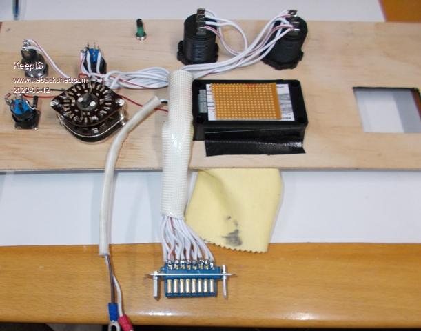

The front panel is wired up on the workbench, I made it a plug in Unit. Four screws, unplug the front panel, and take over to the workbench for any changes.
Edited 2023-06-12 16:09 by KeepIS

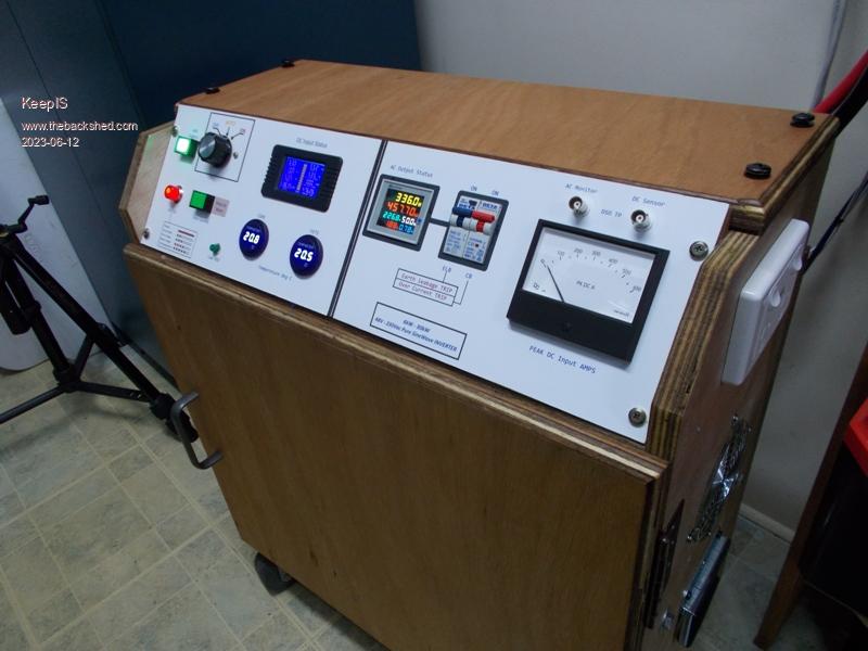

KeepIS
Joined: 13/10/2014
Posts: 2287
Posted: 07:40am 12 Jun 2023
Coat of Danish Oil.
