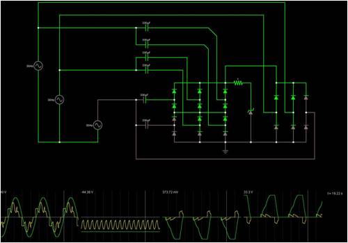

This App is an interactive unit, and frequency and voltages and capacitor sizing can be altered, etc.
Multiple components can be graphed to show related interactions.
Well done Stephen, finding this. I think we are free to download and use it.
Here is a pic of typical display. App is good on a large, high res monitor.
I will run some numbers through and see how it compares with my system.

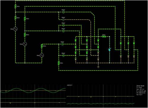

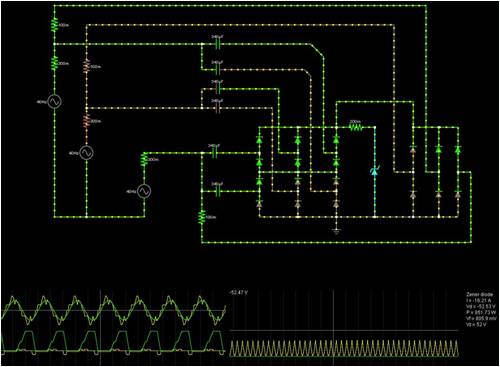

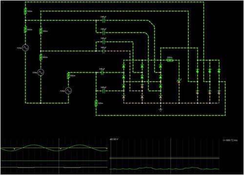

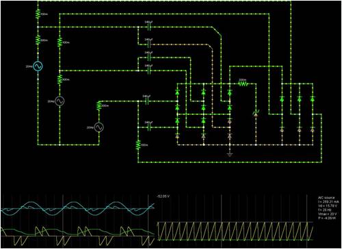

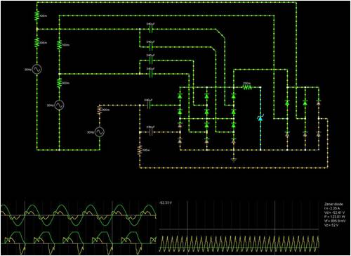

Have run some frequency figs through the simulator, for 340uF caps on my setup with the loading at 52V. I have only done the sim with a doubler and normal rectifiers on my AxFx mill.
There are graphs from 13Hz, 15Hz,20Hz,25Hz,30Hz & 40Hz. This corresponds to 130-400RPM on my mill. The 13Hz, is just below cutin, with no current. The 15Hz is just on cutin, with just the peaks pushing through the rectifiers. At 20Hz[15W], current peaks are showing on the caps[lower RHS graph]. At 25Hz[52W], current starts flowing through the main rectifiers, and this reduces the power through the caps. At 30Hz[123W], current through the caps still reducing, and more power through main rectifiers. At 40Hz[850W], most current is through main rectifiers.
These are the pics of the sim.
13Hz.
15Hz.
20Hz.
25Hz.
30Hz.

The simulator produces results , but not real close to my measurements.
A tool is now available for others to test rough cap sizing for their own windmills.
