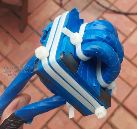

BTW I got the heatsinks all drilled and tapped after work today.
Got some 70mm2 cable lugs for primary and some cable clamps to link the heavy cable with the choke.
I ended up using the recovered wire for the choke, totally amazed I was able to do it, and it actually looks quite neat.
Wasn't sure if it would be ok long term as it only has two layers of tape on it, so I just cable tied the two halves together. I put three layers of tape on the mating surfaces so it doesn't hum and vibrate too bad. If it works ok might be an idea to leave it as is and epoxy it a bit.

Mark, I'm afraid your blue beauty above will squeal horribly under load. OK for testing though.
I found sticking a single layer of Klapton tape on each of the mating surfaces (so there are 2 layers of tape when clamped together) quietens it a lot and might even improve the performance.
For rigid clamping I fitted one half of the core to 12mm plywood and had a U channel, bent from 2mm alu sheet, on the top side with two 6mm bolts clamping the lot together. No noise from that and you can take it apart later for experimenting purposes.
Cable ties won't do for the final clamping job.

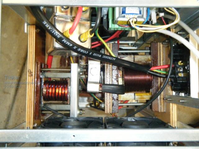

Klaus, You said you mounted the ferrite core on plywood with an Al clamp.
Did you do that intentionally to isolate it from the metal box?
Also I see on various threads some people put a ferrite core on both sides of the primary cable.
Is that just to overcome any unwanted ripples in the wave?
With the core itself does it vibrate the wire in it? If so I'll have to get some properly insulated wire for it.
Cheers Caveman Mark
Off grid eastern Melb
Posted: 09:17am 20 Mar 2018
  renewableMark said   Klaus, You said you mounted the ferrite core on plywood with an Al clamp.
A picture says a thousand words so I took one of my latest inverter (not quite finished yet) to show how I mounted my two chokes.
The ferrite one is on the left, it is in the high side of the primary.
The choke on the right is a non saturating type, made from 2 cores of the original 3KW Aerosharp chokes. The reason for that extra choke was discussed at length among these electronics forum posts, I suggest you read up on that topic, well worth while I think.
If I were you I would just get the inverter going with the choke you have now. Then, when all is well you can start to improve the sine wave shape with the extra choke.
You would do well to epoxy encapsulate the winding as, yes, the wires will try to vibrate and that is no good. The ferrite core itself vibrates at the mating surfaces, that is why it requires secure clamping or super gluing - I would do the latter *only* after you completely finished experimenting.
As you see on the pic, I used rectangular wire in parallel for the little choke, it is also epoxied.
The big choke has many (I'll have to check how many) parallel wires of 1.8mm diameter to get the cross section area required. It was wound on a special former, 3 in hand at a time and as many layers of that as would fit the cores.
If you want to go down that road perhaps better after you get that monster going first.

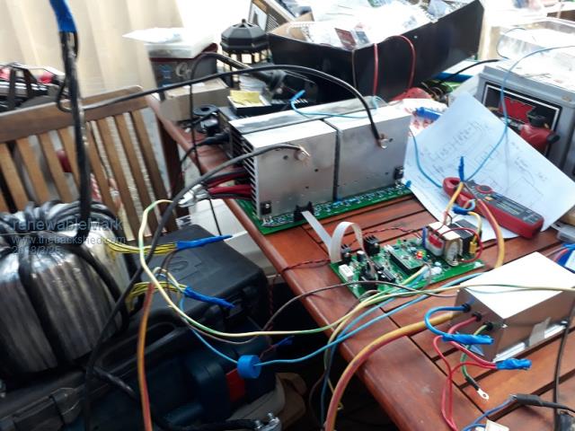

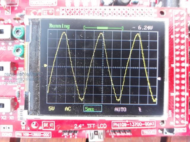

Posted: 07:11am 25 Mar 2018
Well I got the bastard to run and give me a nice wave! ripper!
But I only have 4 fets fitted and no caps.
For some reason it's drawing 2.6Amps.
I just spoke to Mad, he seems to think it might be because there are no caps on yet for it pulling that much.
Has anyone had a similar result.
I swapped the choke to the other heatsink, it had zero change.
Cheers Caveman Mark

Try a smaller value cap... maybe around the 1000uf, may save your Mosfets if something up, but should improve current draw if it is that..
I think it works !!

Also remember your driving the low voltage side, so current will be higher.. 240v 30ma is " the same " as 24v 300ma.. if that makes sense. .although 70 odd watts idle seems a bit high but not unheard of..
I think it works !!
Posted: 08:29am 25 Mar 2018
The extra current is almost certainly caused by high frequency switching losses being added to the toroid no load losses.
Cured by fitting a bigger, better, or different choke in series with the primary.
Fitting 1,000uF at this stage will probably make the idling current slightly higher.

Posted: 08:40am 25 Mar 2018
Well I added 2x 560uf 450V caps that came off the aerosharp and it dropped to 0.89A
So that's around 43watts, not bad. I just sat them there and twisted the tabs a bit to keep a tight fit.
Lets see how it goes with all the components fitted, hopefully, no magic smoke!
Sadly I don't have a big battery yet, so I can't test it properly.
So next step..... fit the fets in groups of 4 and test the wave each time.
Ripper, looks like it's going well, too well.
I worry when something complicated goes this smoothly.
