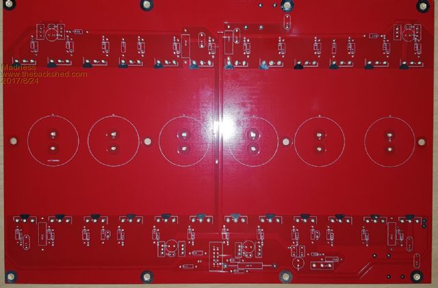

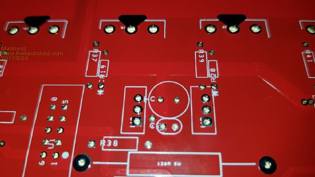

Just received my order from PCBway for PCB's 7 days from order to having them in my hand. I have not had the chance to do anything more than look at them but they look perfect, they are in a whole different league to my home made boards.
Close up looks really good

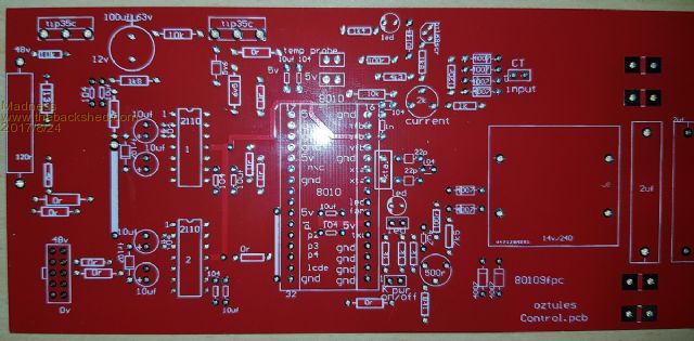

This is the latest version of the Oztules control board

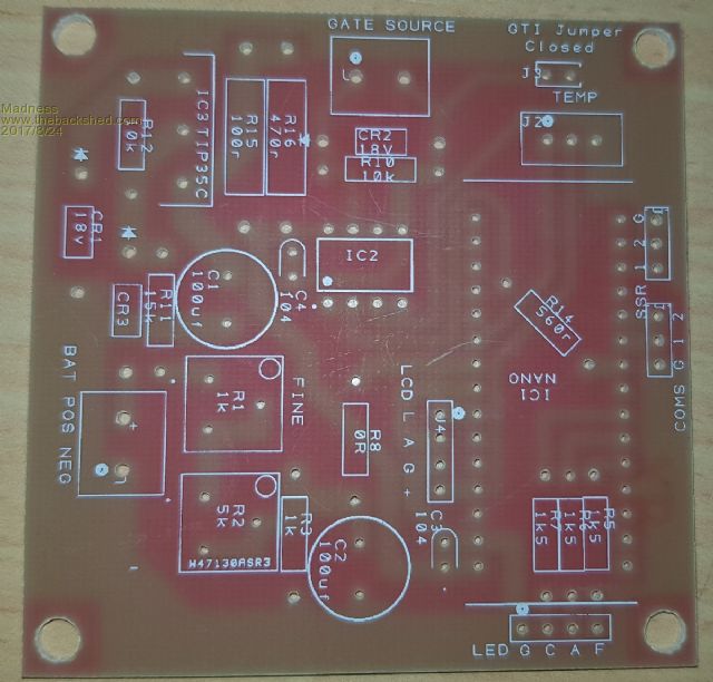

This my adaption of Oztules solar controller

Posted: 09:31pm 23 Aug 2017
[quote]They are in a whole different league to my home made boards.[/quote]
Yes indeed, long gone are the days of messing around in the sink with ferric chloride or drilling all those nasty little holes.

I don't know what happened to my control board when I finished it on the cap end... I did not check the board dimension I think.... makes no difference, but would have looked better with a few mm more perhaps.
Looking good.... as expected..... just wondering of your red ones will run speedier than the blue ones
.........oztules

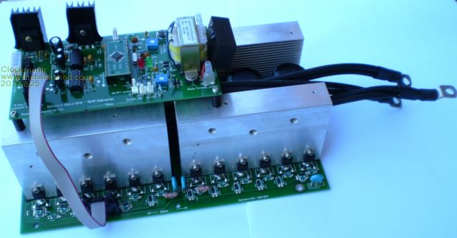

Clockmanfr
Joined: 23/10/2015
Posts: 437
Posted: 08:47pm 24 Aug 2017
I am green. Ha Ha!

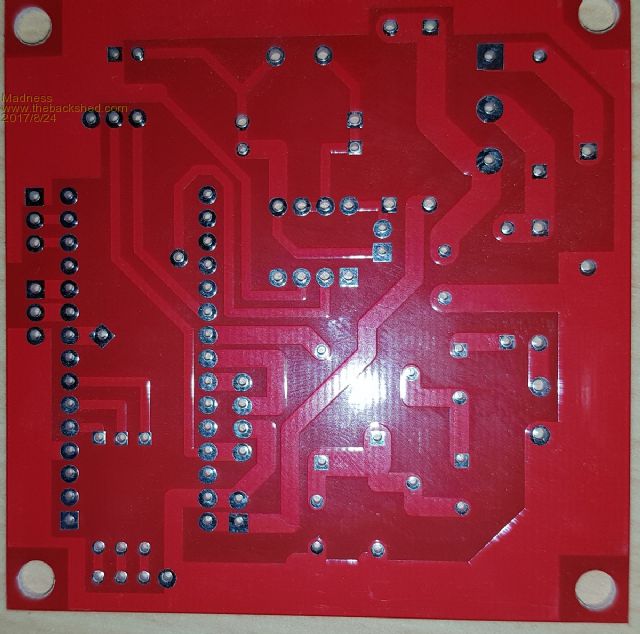

Posted: 09:31pm 24 Aug 2017
I just realised seeing your green boards I forgot to allow pads to solder the negative cable to the bottom of the power PCB. Didn't matter with no solder mask, no big deal I will just have to scrape off the areas where the cables attach. I put mine straight on the bottom so there are no holes required, leaves more copper on the top for the bridge too.

Posted: 10:10pm 24 Aug 2017
My last lot I put a 15mm solder mask all the way across. Now I use a 12mmx6mm copper bus bar with threaded 6mm hole in the over extended end sticking out. I solder the bussbar to the circuit board, and still use the holes for mechanical fixing ( of the buss)as an adjunct.... this needs a gas torch or a lot of hot air gun to achieve a decent bond.

Madness, I forgot to mention, that your new control boards have three changes to do .
1. the 1n becomes 22n ( near pin 16
2. the 4k3 becomes 1k
3. and this is more important.... the pin 6 on the 8010 needs to be heated up, and pushed through the board so it is on the top of the mini board. This becomes the on/off pin, the other two pins on the control board are +5v and gnd, so use a spdt switch for on/off.
4. your monitoring transformer will be different to my 14v one. I think a 12v one will use a 3k9 or similar instead of the 7k5.
If you miss this it will be indeterminate as to being on or off and will feather between the two states.
Will take a pic later on.
.........oztules

About to update and test the latest OzControl board, now at Mk 12. Especially as winter starts to descend on Europe with shorter days, and the boys go back to school next week, so time to think.

  oztules said   Madness, I forgot to mention, that your new control boards have three changes to do .
.........oztules
I know you are busy man Oz but any chance of getting the photo you mentioned?
