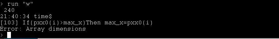

Can anyone see why this isn't working please?
It should run on any MM
It's meant to print a triangle representing the wind direction of 240deg
It's giving this result
CLS
Dim As integer z(1000)
Dim As string q
q=Chr$(34)
'set up pointer
const pivot_x=501   'specify where the centre of the dial is located
 const pivot_y=387
 const radius=73   'specify the radius of the compass dial
 const side_length=13    'specify the size of the equilateral triangle pointer
 'define the points that make up the triangle relative to a pivot at 0,0
 const x0=0
 const x1=-side_length/2
 const x2=side_length/2
 const y0=-radius
 const y1=-radius+side_length*cos(rad(30))
 const y2=y1
 dim integer angle, X, Y, W, H
 dim integer xx0,xx1,xx2,yy0,yy1,yy2   'variables holding the vertices of the triangle relative to its pivot
 dim integer pxx0,pxx1,pxx2,pyy0,pyy1,pyy2 'variables holding the absolute vertices of the triangle
 angle = 240 'wind direction
'load image "image.bmp" ,400,280  'load compass picture
do
 print angle
 angle = val(angle1$)
 print time$ " time$"
 moveto(angle)     'Move Compass to the current wind direction
 pause 1000
loop
'Subroutines to make the compass pointer move to the correct position
sub moveto(angle as integer)
local integer xs=x, ys=y, ws=w, hs=h
 rotatetriangle(angle,0,radius,x0,y0,x1,y1,x2,y2)
 pxx0=xx0+pivot_x
 pyy0=yy0+pivot_y-radius
 pxx1=xx1+pivot_x
 pyy1=yy1+pivot_y-radius
 pxx2=xx2+pivot_x
 pyy2=yy2+pivot_y-radius
 getlimits(x, y, w, h)
 ' blit write and blit close first time in will error so skip
 ON ERROR SKIP 2
' BLIT WRITE #1, xs, ys, ws, hs 'restore the save background  **** bypassed as the triangle isn't working at all***
' blit close #1
' blit read #1, x, y, w, h
 triangle pxx0, pyy0, pxx1, pyy1, pxx2, pyy2, rgb(RED), rgb(BLUE) 'COLOUR OF TRIANGLE
end sub
sub getlimits(x as integer, y as integer, w as integer, h as integer)
Local integer i,max_x=0,min_x=MM.HRES,max_y=0,min_y=MM.VRES
 if(pxx0(i)>max_x)then max_x=pxx0(i)
 if(pxx1(i)>max_x)then max_x=pxx1(i)
 if(pxx2(i)>max_x)then max_x=pxx2(i)
 if(pxx0(i)<min_x)then min_x=pxx0(i)
 if(pxx1(i)<min_x)then min_x=pxx1(i)
 if(pxx2(i)<min_x)then min_x=pxx2(i)
 if(pyy0(i)>max_y)then max_y=pyy0(i)
 if(pyy1(i)>max_y)then max_y=pyy1(i)
 if(pyy2(i)>max_y)then max_y=pyy2(i)
 if(pyy0(i)<min_y)then min_y=pyy0(i)
 if(pyy1(i)<min_y)then min_y=pyy1(i)
 if(pyy2(i)<min_y)then min_y=pyy2(i)
 x=min_x
 y=min_y
 w=max_x-min_x+2
 h=max_y-min_y+2
end sub
' Simple trig to rotate the vertices of a triangle
' specified as x0,y0,x1,y1,x2,x2 relative to coordinate 0,0
' by the angle specified
' and then translate them about the supplied real centre x,y
' the calculated coordinates are then placed into element n of a set of coordinate arrays
sub rotatetriangle(angle as float, x as integer, y as integer, x0 as integer, y0 as integer, x1 as integer, y1 as integer, x2 as integer, y2 as integer)
local float sine=sin(rad(angle)),cosine=cos(rad(angle))
local integer x0a,y0a,x1a,y1a,x2a,y2a
 x0a= x0*cosine - y0 * sine + x
 y0a= y0*cosine + x0 * sine + y
 x1a= x1*cosine - y1 * sine + x
 y1a= y1*cosine + x1 * sine + y
 x2a= x2*cosine - y2 * sine + x
 y2a= y2*cosine + x2 * sine + y
 xx0=x0a
 yy0=y0a
 xx1=x1a
 yy1=y1a
 xx2=x2a
 yy2=y2a
end sub
'*******End of compss routine  *******************************
I just cannot figure out why though

Atomizer_Zero
Joined: 04/07/2020
Posts: 134
Posted: 09:15pm 23 Jul 2020
I think it's because you set your pxx0 (and similar variables) as integers, not arrays, so when you try to index into it (pxx0(i)), it can't because it's not an array

  Quote  It's a bug on the Pi-cromite
No it isn't. Geoff tightened up error checking and I included it. You are using declaring pxx0 as a scalar but then using it as an array. This creates the error. Fix function getlimits and it will work

Posted: 06:28pm 24 Jul 2020
getlimits doesn't do anything useful with i so you can probably remove it and also remove all the
(i)
references.
e.g.
becomes
if(pxx0>max_x)then max_x=pxx0

The BASIC code is WRONG. Old versions of the Picromite code work because they didn't check syntax properly. Fix the Basic code.
if(pxx1>max_x)then max_x=pxx1
if(pxx2>max_x)then max_x=pxx2
if(pxx0<min_x)then min_x=pxx0
if(pxx1<min_x)then min_x=pxx1
if(pxx2<min_x)then min_x=pxx2
if(pyy0>max_y)then max_y=pyy0
if(pyy1>max_y)then max_y=pyy1
if(pyy2>max_y)then max_y=pyy2
if(pyy0<min_y)then min_y=pyy0
if(pyy1<min_y)then min_y=pyy1
if(pyy2<min_y)then min_y=pyy2
x=min_x
y=min_y
w=max_x-min_x+2
h=max_y-min_y+2
end sub

If I use any version of Stretch,and MM for Stretch it's working and drawing the triangle perfectly using the exact same code - the modified getlimits
The only issue with Stretch is it's very slow drawing boxes on the screen which is why I would have loved to have had Buster working. but c'est la vie
Simple code that loads a compass and draws a triangle pointer (set for 7 inch SSD1963)
CLS
Dim As string q
q=Chr$(34)
'set up pointer
 const pivot_y=387
 const x0=0
 const y0=-radius
 const y2=y1
 angle = 174 'wind direction
do
 print angle
 pause 1000
loop

First of all, I don't have a picromite running at the moment, so I cannot test.
But from browsing your code, there seems something not logical.
You commented out the blit functions.
The preceeding ON ERROR SKIP 2 will skip the "END SUB" now.
Result: you won't see the error, but also the program may also crash.
Maybe you could also comment out the ON ERROR SKIP line.

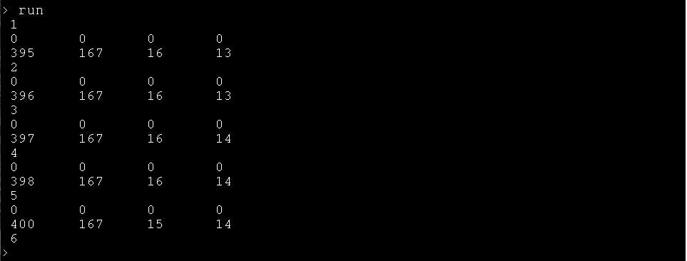

I give up totally
I'm in my 60's, had brain surgery so my memory is cr@p, everytime I leave MM for a few weeks and come back to it. I've basically got to try and learn all from scratch again
Yesterday I spent the whole day going through every version of Stretch and Buster I could and also trying every version of pi-cromite
The triangles definitely do not work on the later versions of pi-cromite, I thought it was just me until I saw a post from someone saying triangle was not working as well
What made it really hard is every version of Pi-cromite is called mmbasic
It would have help tremendously is it had the version number as well in the filename
It really would help if there was one post dedicated to posting new versions of Pi-cromite along with issues people found with that version, that way it would save having the search the whole forum to try and find versions
I'm sure that would be the case with other versions of MM as well, such as DOS etc
That way people such as idiots like me can see instantly which version they are testing
Yes I know you can check once it's running but that doesn't help when you're trying to find the right version to install in the first place
After spending all day and most of the night I just give up, it's definitely not working
Yes Volhout you were right, I had an error in the code, I thought I had changed it before I uploaded it
The correct code is below and it should work on every version of MM that has a display attached
from my "VERY" limited knowledge it seems to me from running the program that the issue "could be" that the blit read and write figures and not correct?
I thought that Blit write should have the same values as the previous Blit read??
It doesn't
the pic below shows the angle of the pointer and underneath it the values of Blit write and underneath Blit read
This was running Buster and the latest version of pi-cromite I could find V5.05.04

 text mm.hres/3, mm.vres/3, "test to check display works",CM,2,1,rgb(white),-1   '"checking display works"
 print xs, ys, ws, hs ' so we can see the values
 print x, y, w, h     ' so we can see the values
