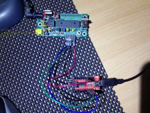

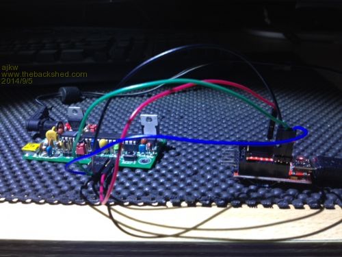

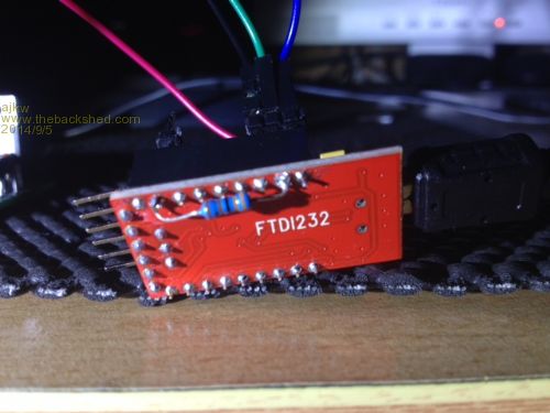

Could someone please check my set up. Programming is taking some hours to do and so far I have only successfully updated 1 PIC. Other attempts have seemingly performed successfully but I am left with a unresponsive, ie MMBasic will not boot/run, chips.
I have used Mick's MUP and Zonkers boards, Win 7 on a VM and Win XP on a laptop but all is equally the same slow.
I know John says it is slow but others like Mick have reported programming being achieved in 10's of minutes. I don't really get why there is such a large variation in time. I believe I have set up the resistor on the FT232 board correctly. Please refer attached photo's.
Even if I could get it to an hour instead of leaving it running overnight would be great.
Anthony.

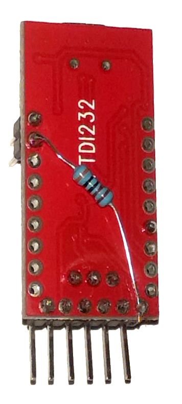

I have my resistor soldered like this:
I checked with a multimeter and you have yours connected to effectively the same spot.
I am using the 5V on the FTDI board to power MuP.

Wow, you guys do resistors neatly! Mine is shoved into one end of a (du pont) wire, then poked into the side of another.
(When I went to a lower value R I poked the 2nd one into wherever it would shove.)
