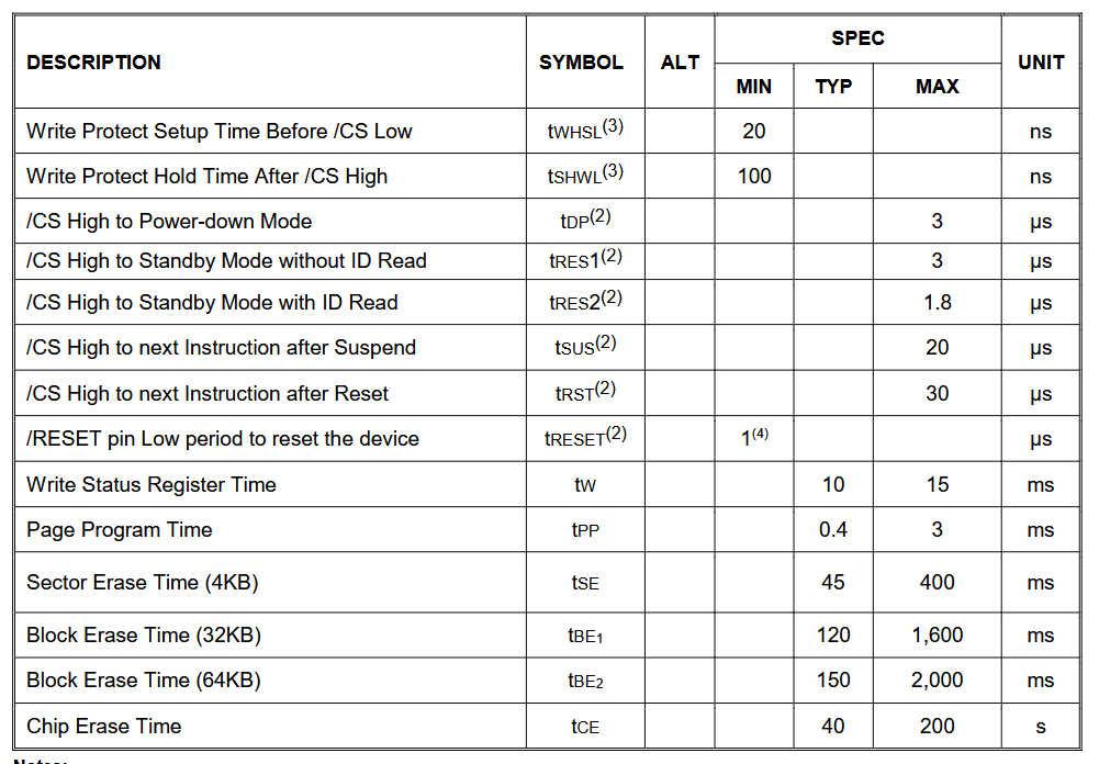

basically the SEEK now works on A:, but the time required for I/O is a bit strange:
      drive a:           drive b:
seek     0.2 mSec           1.1 mSec
print   36   mSec           0.2 mSec
input    0.3 mSec           0.2 mSec
flush   65 - 200   mSec     3.7 mSec
i would expect drive A: to be faster than drive B: but it's just the other way round and I/O on A: is incredible slow.
I will later make some experiments with sequential reads/writes.
But thank you for bringing the SEEK/write I/O functionality to drive A:, maybe the time behavior can be adjusted as well.
Gerald
P.S. added input (read) times
Edited 2025-03-06 23:31 by ville56

You need to think about how flash memory works. Erasing flash sets it to all ones. Writing sets the relevant bits from 1 to 0. Flash memory has a 4Kbyte page size. So to overwrite a  single zero to a one it needs to read 4K, erase the 4k, and then write the 4K back with the changed data.
Now, your use of seek, as Tom indicates, sets NULL (zero) to bytes before the new position. This means to overwrite you need to erase for every write. I suspect LittleFS isn't clever enough to compare the stored data with your write to see if it needs to erase.
See the chip timing below for more info - in particular look at the sector erase time and the page (256 bytes) write times

OK Peter, I understand, it is the erase time. I have completely underestimated this. Buffred writes are still fast, so what I've intentionally tested with constant flushing was the worst case of course. But it is good to be reminded again that writing to flash is really slow.
Gerald

LittleFs generally has a relatively poor performance when writing.
This is due to the design! LittleFs is designed to survive power cuts and crashes without errors. This is why it works with transactions. If a new empty flash block is needed for writing, the next invalid block found is only deleted immediately before writing.
In addition, when writing in the middle of an existing file, all existing data behind the current position up to the end of the file is rewritten during a "commit" (e.g. by flushing) to ensure that the file is in a valid state again.
LittleFs does not perform garbage collection in the background by itself! This can be added, but this means programming effort.
If you have use cases such as a circular buffer, LittleFs is certainly not the first choice. SPIFFS, for example, is suitable for this.
However, you can also distribute the circular buffer across several shorter files of a fixed size to achieve something like this. E.g. "values.1.dat", "values.2.dat", "values.3.dat", ...
