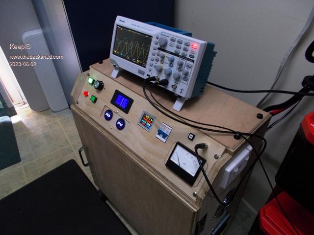

Another twist in the Choke "who done it" story.

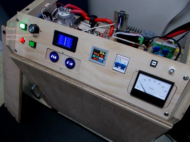

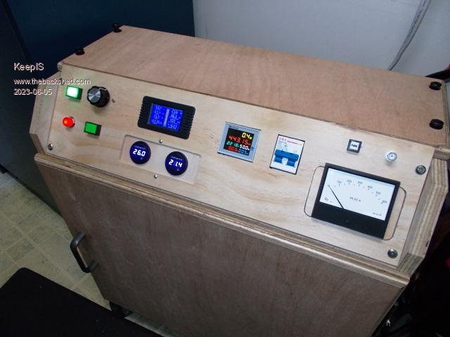

But first, I've modded the front panel to fit an analogue Meter to show Peak input current, when I'm finished it will be able to switch to show kW input as well.
I'm glad I left the finishing of the cabinet until everything is set in stone. Moved the twin 15A socket to the RH side, a much better location IMHO. I didn't want to leave the AC skt off as it allows testing the inverter off load, and also makes it self contained, needing only DC input to power something.
The power point moved to fit an Analogue Meter. The socket above the Meter is the same as the DSO skts. It brings the DC Current Sensor output to a location where the DSO can be plugged in with a patch lead without opening or disturbing the inverter.
Power socket now mounted on the RH Side of the cabinet.
Skts above batteries are used when testing.
The Choke Story continues
The Current drawn by the big 380A to 560A loads has dropped slightly by 5A to 15A, the Power input remains the same as the DC input voltage across the FETS is now higher and therefor less current is needed to hold 230Vac output.
The Startup noise from a sustained 375A current surge lasting almost 2.5sec was very quite before, however it's now even more subdued in tone, to the point that I would hardly notice it while I'm sitting in front of the Inverter with the inverter door open eyeballing the Toriod.
Who knows? on that one.

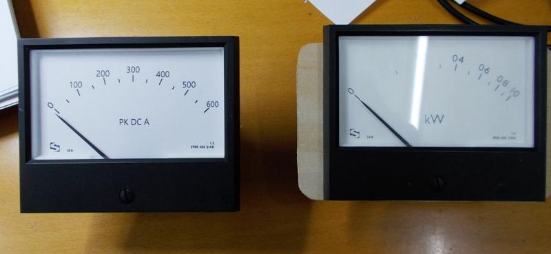

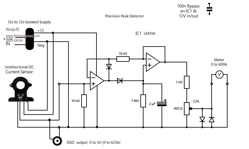

I finally have my Peak DC current Analogue meter calibrated. I made a precision peak detector [virtually instant attack time and slow release] with a dual setting for release time. The hard part was calibrating it to almost 600A.
The meter I used was one of the two I saved in my vintage parts bin. Made by SIFAM in England, it still has the written test data and serial numbers on the sides of each.
Originally marked as kW meters, I did my usual of removing the scale plate once I had  enough accurate ref points, scan it in, photo shop a new scale, fit it over scale plate and done. I even include all the existing ID and type info on the new scale, basically it looks original. Made even easier as these old meters are like new.
Dam it's scary seeing the pointer kiss just under 600 amps starting the Comp. It's just brilliant to be able to see at a glance the current that the FETS and Toriod are using to produce the Power to these big startup loads.

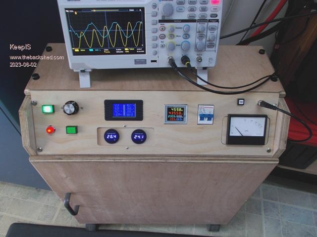

One update on the Noise and waveforms:
Since removing the crap Fuse holder and meticulously going over every connection to the Toriod, chokes and driver board, the startup currents has gone up slightly, I though it might drop, but the startup is even more unbelievable with the ancient 3HP compressor.
Today when standing in front of the inverter filming the Meter face during calibration [don't ask], I had to ask my wife to start the compressor, "when she had just done that", I heard nothing from the inverter and the spin up of the compressor was so dam fast that it didn't ever register to my ears, I repeated it a few times during the day just to check if I'd been daydreaming, the results were exactly the same.
This inverter sounds so freaking Strong, and every indication of the DSO and other measuring equipment I have connected agree with that feeling.
This really is something that I though was unattainable for a home built inverter, I'm sure others have the same feeling when they get one running, especially considering the major components are salvaged from junked equipment and the rest handmade by us.
It just seems so effortless now for an input surge of 27.3kW [581A peak] which includes 1.5kW of additional running loads at the time.

One on the left is with my new scale.

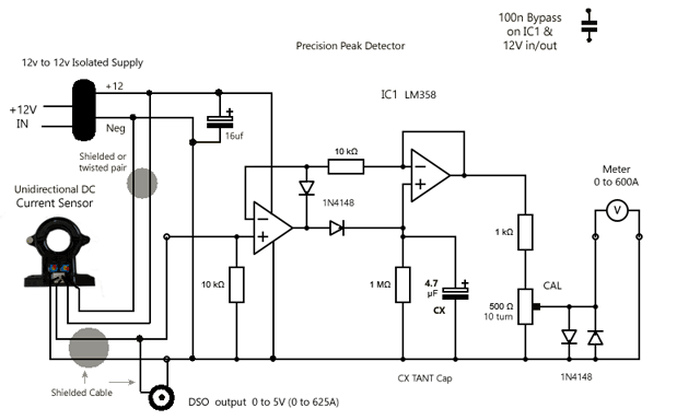

For anyone interested in the Precision Peak detector: I have changed the cap from 2.2 to 4.7uF. A few tweaks to the inverter have seen the startup time of some machinery reduced. The Cap change allows me to see the current reached correctly, which in this case is almost Full scale deflection of the Meter @ 585A, just 15A shy of the 600A limit.
For those who think this circuit is not accurate, it is! Right across the full scale range of  the meter. These current Sensors are low cost and have a 100% repeatable response, this circuit only needs one or two cycles of 100Hz current to charge the Cap to the Peak instantaneous DC input.
I'm comparing the Meter reading with a DSO capture from the Sensor output, the output is a permanent socket mounted on the Inverter control panel.
I no longer need to use the DSO for Peak input checks, this meter is that good. Of course the DSO is still used for waveform analysis. For the Meter, the DC current waveform is always going to be a 100Hz DC sinewave representation of the FET current drawn to produce 50Hz AC when driving the Toriod Primary.
Revised circuit: The Meter I used is 50uA FSD, but almost any meter will work, if the adjustment range is limited, a change to the 500 ohm 10 turn preset or the 1K connected to it will fix that.

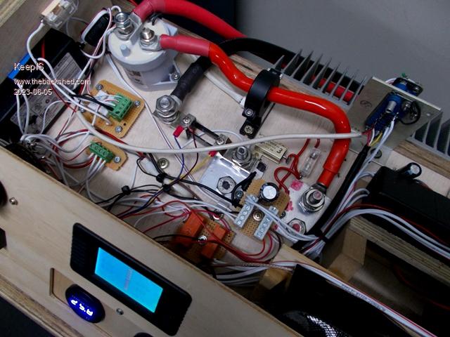

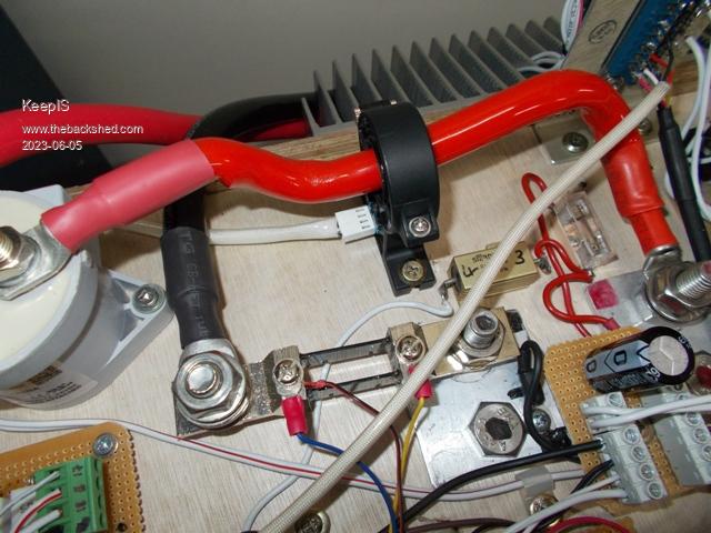

To complete the Meter and DC input modifications, here is a picture of the current Sensor mounted in the cabinet, it replaces a big fuse holder that is really not needed here and could not handle continuous high current demands.
This Hall Sensor also shuts the Inverter down if DC input is over current, much the same as the existing AC output over current trips. No waiting for a fuse to blow or a Circuit breaker to trip.
Over current faults cause the big Contactor to the left of the Sensor to open the Battery feed to the inverter. [seen clearly on the last photo] That Contactor is part of the Automated Capacitor bank charge and inverter startup / shutdown functions.

tinyt
Joined: 12/11/2017
Posts: 564
Posted: 12:54pm 05 Jun 2023
  KeepIS said  For anyone interested in the Precision Peak detector: I have changed the cap from 2.2 to 4.7uF. A few tweaks to the inverter have seen the startup time of some machinery reduced. The Cap change allows me to see the current reached correctly, which in this case is almost Full scale deflection of the Meter @ 585A, just 15A shy of the 600A limit.
Nice! Can I have permission to copy your circuit? Do yo have a part number for the Hall effect sensor? Thanks.

  tinyt said  Nice! Can I have permission to copy your circuit?
That's a very old circuit from way back in my Audio days, I think you will find it everywhere as there really is no other way to design it with 2 op amps, or 1 dual op amp.
Most meter movements should go full scale before the two diodes across the meter start to conduct. Just some very basic protection to try and stop the coil burning out if a "brain snap" moment happens.
Obviously you don't have to use an isolated supply to power it, but as I mentioned before, I'm trying to maintain earth and supply isolation to keep interference, earth loops and spikes to a minimum in this inverter.
Link:
D-C2T- 500A unit is the one I use in this Inverter for peak DC input.
Select the option for 12V or 24V supply rail. Current consumption is <25mA.
Current Sensor
  Quote  Do you think it's possible to calibrate the meter without having the DSO capture facility?
You really need DSO to capture the instantaneous peaks, but you could try using a CRO and your camera to video the startup up, you should be able to catch the Peak Sensor output voltage if you set the CRO correctly.
But a DSO positive edge triggered and 100ms time base is hard to beat.
KeepIS
Joined: 13/10/2014
Posts: 2287
Posted: 12:55am 06 Jun 2023
  Murphy's friend said  Do you think it's possible to calibrate the meter without having the DSO capture facility?
I set a DSO up to measure the voltage across a Resistive shunt on CH1 and compare it to the Current Sensor on CH2.
I wanted to see if the shunt could be used to get an accurate reading of Peak input current at high current.
The shunt calibration is 75mV = 200A.
I though that starting a 420A peak load through the Shunt might make it easier to get a good result above the switching noise on the DC input.
It's still very difficult. Where the Hall Sensor produces a perfectly clean DC sinewave as it follows the Inverter input current, the Resistive shunt has a lot of transients and is not consistent in amplitude from cycle to cycle.
The Sensor indicates 420A across the startup surge waveform, the Shunt is indicating anywhere from 430A to 560A.
You might get a ball park figure from the shunt, but that's about it. If I find a way to get a consistent result I'll post it.
EDIT:
When starting a load drawing 570A Peak DC, the shunt displayed this 590A on the cleanest waveform cycles, but you have to understand clean in this context, but once again it was also showing values of over 700A on other cycles. Really useless, and looking at the waveform I doubt a resistive shunt even with filtering would be reliable at these high currents through DC cable.
You really need the galvanic isolation provided by the HALL effect Sensor.
FYI: The Precision Peak Circuit and Meter showed just over 400A on the 420A startup and hit just over 550A on the 570A start. Dam that's good.
Edited 2023-06-06 11:23 by KeepIS

  KeepIS said
Link:
Current Sensor
Thank you for that link.
Forgive my limited knowledge about peak detectors but what does that meter show when there is a *steady* current flowing through the hall sensor?
If it shows the value of a steady current, say 100A, then that would be accurate enough for me to deduce meter pointer positions for peak current values further up the scale.
Or am I on the wrong track here?
