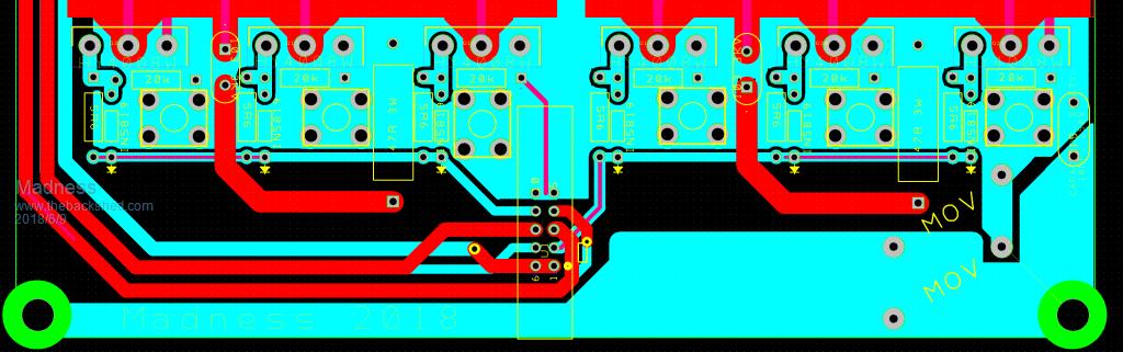

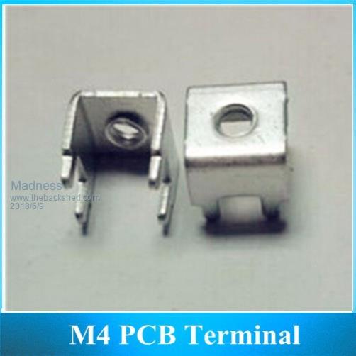

  Madness said  I have made further changes to the Regulator PCB to include these SMD Terminals .

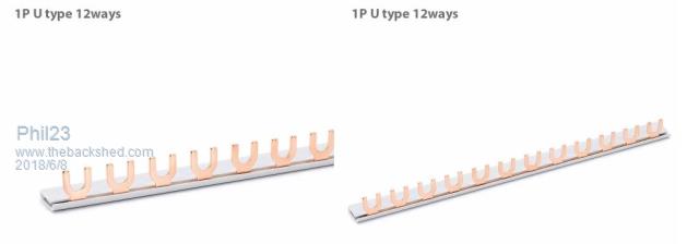

Hi Mad,
Don't know the dimensions of the above board, but how would you gos spacing the screw terminals to match a breaker busbar, (18mm I think).
Then the cable could be terminated to these.
Cheers.
Edit
Now I think about it, it would even be possible to trim the end of the bar a bit & crimp it & cable in some copper tube or a joining link to keep some flexibility.
Edited by Phil23 2018-06-09
Posted: 11:14am 08 Jun 2018
Hi Phil,
I don't have room to move them any other way, it would be easy to drill a piece of copper to suite. This 3 X 15mm Copper Bar Could easily be drilled to suit the hole spacing required. But I think I would prefer crimping 6 smaller cables on the end of the main cable coming in from the panels and a round end crimp terminal on the end of each smaller wire. That would put much less stress on the board also.
Posted: 09:44pm 08 Jun 2018

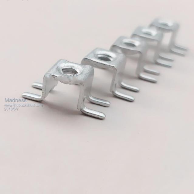

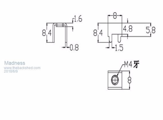

Just added PCB-11 Screw Terminals to the 4 KW Inverter PCB for the negative connections. It still has the option to solder directly to the bottom also.
These are the 8MM long type there are others that are 11mm ones that won't fit. You can also find these on the Aerosharp PCBs but they are M3.

Posted: 10:48pm 08 Jun 2018
I have just ordered the terminals, $2 extra if you want them also. The ones I have ordered include the M4 screw as well.
But you can use the ones out of the Aerosharp PCBs just that they are M3.Edited by Madness 2018-06-10

Posted: 10:38am 09 Jun 2018
  Madness said  This 3 X 15mm Copper Bar Could easily be drilled to suit the hole spacing required. But I think I would prefer crimping 6 smaller cables on the end of the main cable coming in from the panels and a round end crimp terminal on the end of each smaller wire. That would put much less stress on the board also.
Other thought that came to mind regarding stress on the board was flat copper braid.
No drilling, just a washer either side. Enough extra length for some flex & add a bit of sleeve.
Don't see a problem with the 6 you mention above, just can't help thinking of possible alternatives....
Cheers.
PS, I'm better off suggesting alternatives to the 6 smaller cables,
that the Six or so herbs & spices going into tonight's dinner recipe.....

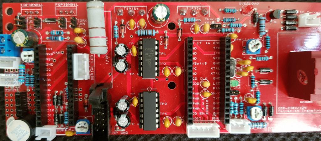

Posted: 11:29am 12 Jun 2018

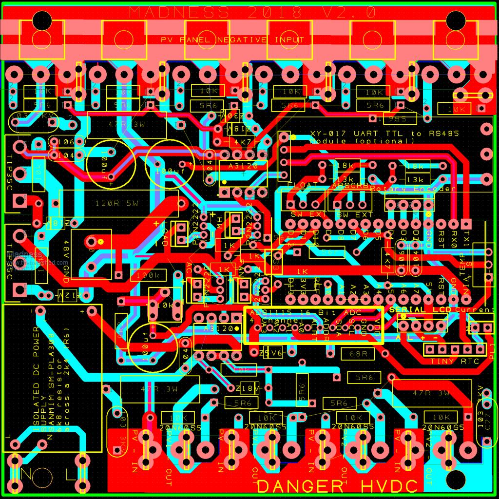

Here is the final version of the Charge Regulator, I had some issues with the A3120 Isolated MOSFET driver on the DC to DC side dying due to overvoltage. So now it's 18V power supply is referenced from the PV panel negative rather than ground. When regulating the voltage of the PV panel increases and therefore the PV - goes below lower than ground (MOSFET Drains are connected to the negative side of the battery, Source to the panels). This was increasing the voltage across the IC to 40 or more volts. Now the 18V supply stays constant but is floating with the PV panel negative voltage below zero. The IC can operate up to 30V, there is also a 30V Zener across the IC to stop it going past 30V.
Another change is I have added 2N2222 transistors to all the auxiliary output pins to step up the signals to 12v. The SSRs I am using are supposed to work from 3 volt but with PWM they need more kick, now with 12V it is sending excess power to the HWS as I expected it to do. There are 6.3mm spade connectors for the HVDC for the GTI side they are supposed to handle 20A and there 4 inputs and 4 out so should be no problems with them. On the DC-DC side there are 6 M4 Screw terminals which should handle up to 50 amps each so it should be possible to regulate up to 300A. That is well under what the MOSFETs will handle. The ground connects to the battery is via the heatsink with the HY4008 (or any other suitable N Channel MOSFET).
If anyone else is interested in getting any PCBs please let me know ASAP, I am going to be ordering them tomorrow.

Here is the parts list for the regulator, I think it is complete. Just updated it, I had not included the LCD Display and battery temperature sensor.
I have included links to the less generic parts to make it easier, they there for examples, you can buy them or the same from elsewhere.
2018-06-17_073341_Regulator_V2_Parts_List.zip
I found one incorrect value on the silkscreen, 4K7 resistor in center top half of image in previous post should be 10K.Edited by Madness 2018-06-18
Posted: 11:09pm 16 Jun 2018
Here is a picture of the control board assembled for reference.
Posted: 04:28am 17 Jun 2018
I have had a few problems with step down voltage converters sending a spike through when turned on. I have killed a couple Arduinos due to this, to stop it happening put a 13V Zener diode across the 12V input of the Control Board with the banded end connected to the positive side.

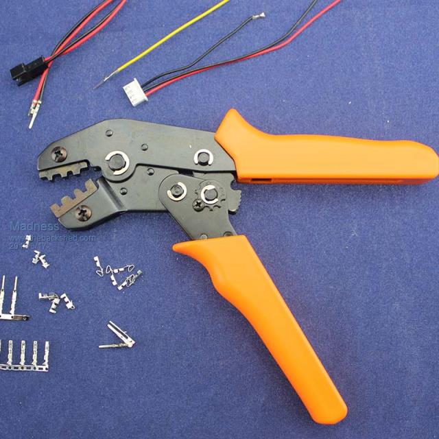

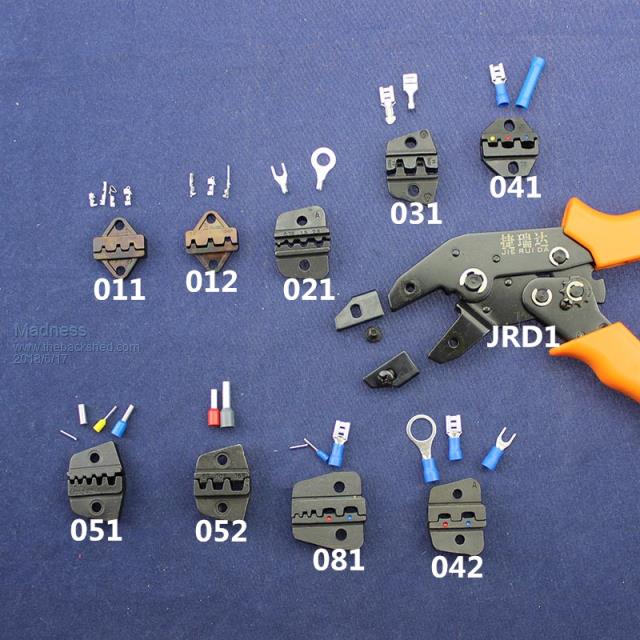

Posted: 10:57am 17 Jun 2018
This is the Crimper I use. If you get one you do need to follow the directions they give you. I have never had any problem with these connectors apart from not having the wire in the terminal properly when crimping. Once you put the crimped ends in they are very difficult to get out without wrecking them. The pins are not numbered, they can only plug in one way, there is zero risk of getting it wrong except if you have multiple connectors with the same number of pins you need to get the right one.
Plus you can get different jaws for crimp connectors etc.
You can put them together without the crimper but it is more fiddly and the end result is not as good. If you plan to be playing with PCBs into the future it is well worth getting the right tools.
Posted: 01:30pm 17 Jun 2018
  Madness said   I have never had any problem with these connectors apart from not having the wire in the terminal properly when crimping. Once you put the crimped ends in they are very difficult to get out without wrecking them.
Thanks for all that info Gary, very useful for all using these connectors.
Looking closely at the crimp inserts I see they have a retaining barb just like the Ouupin brand I have been using so far. With these, the 'barb' latches in an opening of the connector shell which is accessible from the outside.
Using a very small flat blade jewelers screwdriver its easy to push the barb in and withdraw the crimped connector & wire. A sharp knife blade resets the 'barb' and the crimped connector can then be re-inserted in the correct slot.
Can you do that with your connectors? I ask that in case I change over, I am using shells with up to 12 pins and sometimes start to push the crimp connectors in from the wrong end . The crimping tool I have is non latching but I think it would do the job for the connectors you use.
