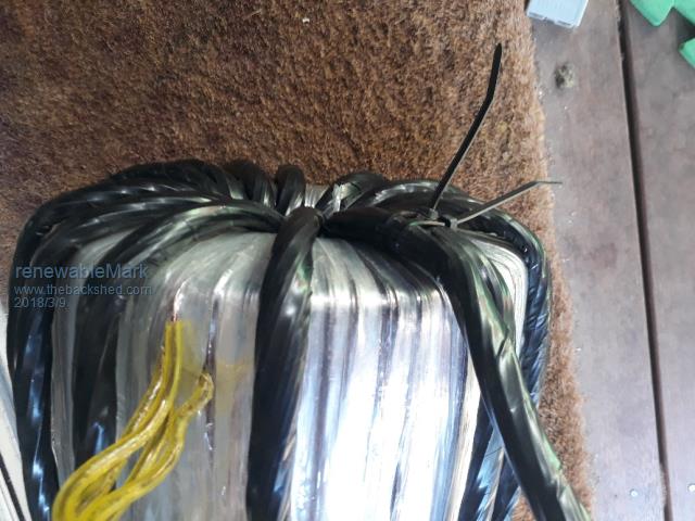

It's very hard to see in the photos, but the more levering I did the more the wires flattened out and made it worse, so just got to that point and thought as long as the ends are flat and a super big washer gets mounted flat and square then that will do. It will still fit a bolt with some conduit.
Reckon if the wire got twisted a lot tighter it would have held it's shape better, the way mine was it just seem to flatten out too easy, I reckon that's where I went wrong.

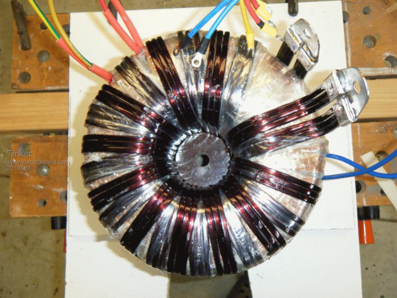

Mark, you can do better than welding cable! Look at this picture of my double stack toroid and notice the center hole size. That's a total of 90 mm sq BTW for the primary, something you will *never* manage with round cable.
That square wire (3x5mm) I got for scrap price as a leftover of an order from a local firm that makes this kind of wire to any size you want - if you order 200kg. For leftovers you take whatever they have at the time.
Apparently there are two companies in Australia making this, one here in Perth and the other in the eastern states somewhere - maybe near you. I found out about them from a local motor re-winder.

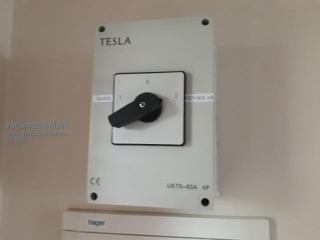

Hey fellas, if you wanted to do a primary of 70mm, could you just wind one layer of 35mm and then a second one of 35 and join the ends of each together?
Should be the same yeah? And probably a lot neater.
On another matter I got the changeover switch fitted. Spoke to battery fellas today and will order that.

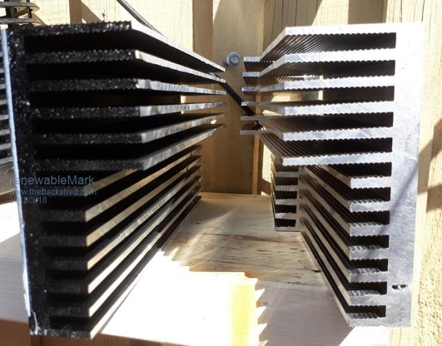

Finally got around to cutting the heatsinks, jeez that made a mess! Tiny al filings all over the courtyard, I reckon there was that much aluminium flying around the airport picked me up as a low flying plane!
Tinker, not wrong about full mask, ended up using my welding helmet and full overalls.
Have to drill the heatsinks now then ready for testing.

You do get a very nice finish with the correct blade.

Posted: 05:02am 18 Mar 2018
Should have warned you about the blizzard of ally chips.
The noise can be quite memorable as well.
I do that sort of thing way out in the middle of the lawn these days.
I think you said you used a Bunnings blade ? what was it exactly, it seems to leave a very nice cut.

Mark nothing wrong with starting with 4 FETs you can do an initial check with no toriod. Just leave the big caps off and run through a resistor, the 2 you used in parallel to test RDS on work fine. You should get a good sinewave out with no load, it may be slightly in a triangle shape, that is okay. While running through the resistor you can't put more than maybe 50 W load on it. Once you have a sinewave you could try bypassing the resistor and run a 1200W load for a quick test. The sinewave will be more triangular due to no caps. Once you have confirmed the first 4 are good then start adding more MOSFETs. It is a bit time consuming but best to be patient. Keep an eye on the DC current, should be 50W or less with no load, any more and you need to find out why.
Those heatsinks look like you bought them. I have used blades made for timber as well but the proper Aluminium ones are much better.Edited by Madness 2018-03-19

Thanks fellas, it was an aluminium Irwin blade 254mm?, used the Lanox, boy does that make a difference big time!
