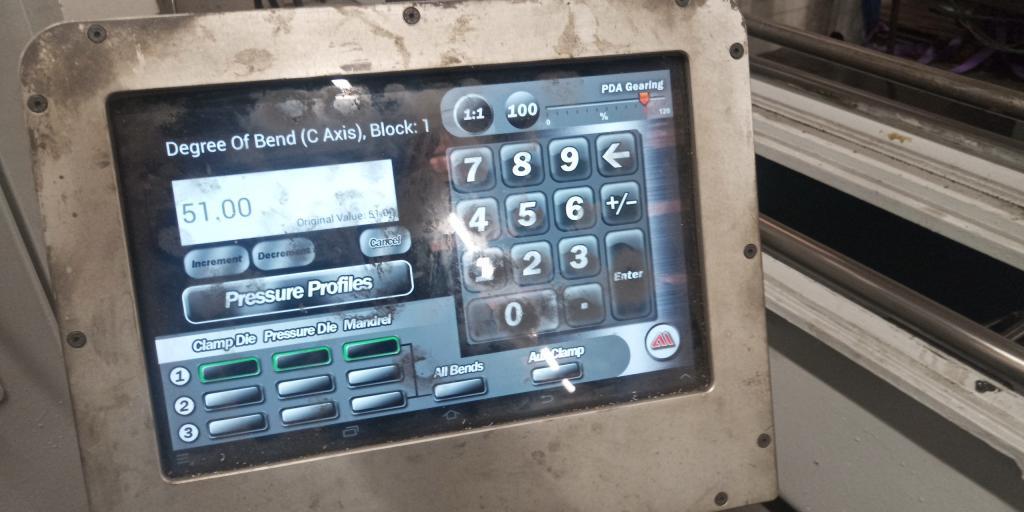

The reason that I prefer capacitive touch is that they are resilient. I have been using MicroTouch (now 3M) since the eighties and the only reason they have ever been replaced is due to a dead CRT.
This is a Samsung TAB 2 that has been abused since 2015. It responds perfectly in spite of the mess. They can't even be bothered to wipe it down.

Phenix,
I do like the style and color of that UI. Might be a nice exercise to port that on a pico. You would need a higher resolution screen though, 320x240 wont do. But 640x480 would. No need for framebuffers, just blit elements to screen.

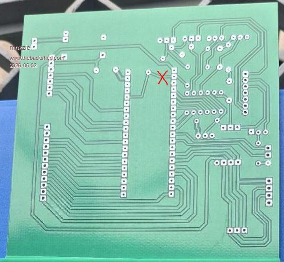

Just looking back over some things and couldn't figure out why the steppers won't enable. This might be a problem:
I think this has the Enable permanently tied to 3v3. Hopefully an easy fix

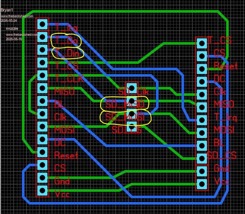

A close look at the LCD PCB and it looks like:
MISO is connected to Touch-DIN
MOSI is connected to Touch-DOUT
This could be causing some grief
Regards, Lyle.

Thanks for pointing out that mistake I made Lyle   I changed the SDCard 4 pin header to a 90 degree pin setup and put it under the pcb then cut both tracks and soldered in jumper wires the correct way.
I did put V3.00RC19 on and doing B: files did show the SDCard contents but trying to set the time on the RTC is still going the "not found" error.
Now as the boards only cost $3.50 for 5 of them   I'm going to get on and correct the error of the SPI lines which should make a nice no bones backpack for the LCD's.

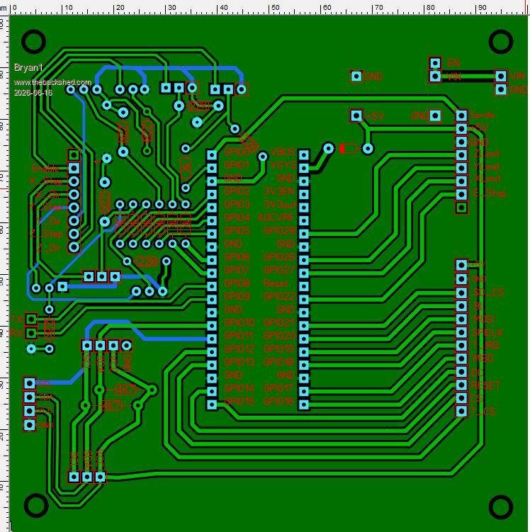

Posts: 3429
Posted: 04:01am 16 Jun 2026
Perhaps wait till the RTC issue is found and fixed, just in case that is a track problem too.
Edit.
I think you have SDA and SCL crossed over looking at the PCB here.
I2C2 SDA should go to GP10
I2C2 SDA should go to GP11
Edited 2026-06-16 14:12 by phil99
Footnote added 2026-06-16 15:25 by phil99
Silly typo. should be:-
I2C2 SCL should go to GP11
Bryan1

Posts: 3429
Posted: 05:23am 16 Jun 2026
The 3 I2C sockets are wired correctly to each other but are the wrong way round at GP10 = I2C2 SDA & GP11 = I2C2 SCL.
If you consider getting new boards made perhaps add a ground pin to the bottom socket.
While you are at it there appears to be room for pads for pullup resistors on SDA and SCL. You may never need to install the resistors but it costs nothing to add the pads, just in case.

Ok it does seem these grey cells got both boards all wrong so just got on and ammended the mistakes on both boards.
Now with the LCD board moved the silk screen for the SDCard connector so one can see them and swapped over the SPI lines.
On the stepper board corrected the I2C lines, put in pullups also put GP1 which is the Enable pin to ground as tying it to Vcc stopped the steppers being armed. Also with the step and limit connectors added a non connecting pin to make them a 8 pin socket as 7 pins sockets aern't around.
Also one thing I need to do with every board which I neglected to do was put in mounting holes so they were added.

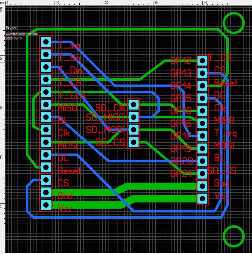

V2 Stepper Board
V2 LCD Board
Now rather than rush ahead and order these boards if I have gotten something wrong again could it be pointed out please.
Regards Bryan
