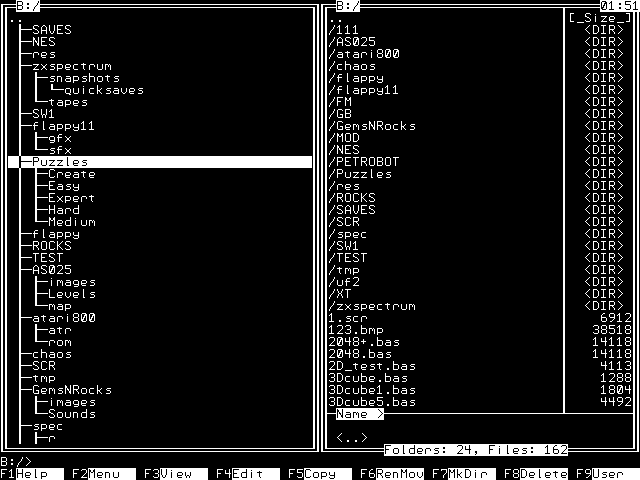

FM v1.75 for PicoMiteVGA/HDMI
+ Adaptive adjustment of list sizes depending on RAM size
+ Directory tree (Alt+F9)
+ HEX Viewer (Alt+F3)

I really like your Dir-Tree. Very good idea and implementation! Congratulations!
I'd like to incorporate it into my FM version – slightly modified. In fact, it's already finished. If you don't object, I'll assume you've approved its publication.

The Dir-Tree is an awesome feature! Thank you!

  twofingers said  I really like your Dir-Tree. Very good idea and implementation! Congratulations!
Hi Michael,
Of course! For our friends from Germany and the whole world, anything!
@twofingers @Amnesie,
Thanks for your feedback!
I tried to implement a very simple algorithm.

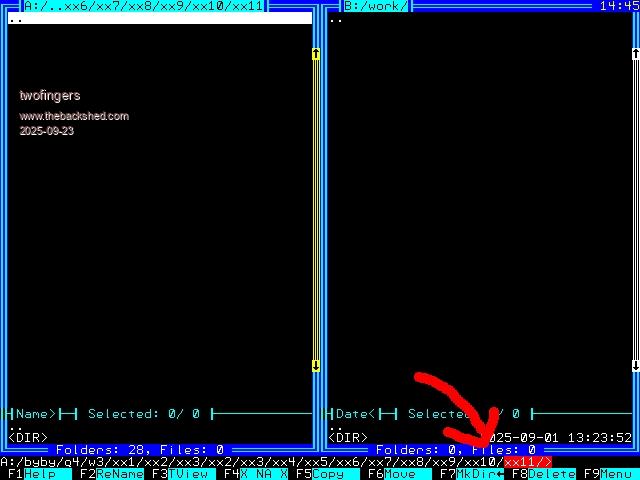

- The maximum number of files/folders (for "DirTree"!) per panel is set and tested at 400. However, this does not mean that this maximum number is recommended.
Note: For time reasons, the number of selected files is not calculated for files over 200 and is set to zero (adjustable with SMAX).
Additionally, I added a small delay (ms DELAY) for deleting large amounts of data to give the user a chance to cancel.

- The sorting function has been revised. Directories are sorted separately when sorting by name or date. When sorting files by size, the directories are sorted by name, since directories do not contain size information.
Although it is the user's responsibility to adhere to the maximum path length of 63 characters*, I have implemented some safeguards to make this easier. It is still possible to create paths longer than 63 characters, but this will certainly lead to serious problems. For example, to prevent illegal directory names for Rename, the location and length of all directory and file names would have to be checked beforehand. This is a task for FM2.0. Vadim's "DirTree" offers a good way to check directories and also displays errors.
Exceeding the file/path length is displayed in red in the command line (see screenshot).
*For the latest beta firmware (V6.01.00b11), the maximum path length has been changed to 127 characters (announced). This is a major improvement. But for now, to remain compatible with older versions, I'm keeping the maximum path length for the FM at 63 characters. However, I would still recommend continuing to observe the old 63-character limit and considering the additional characters as a safety buffer.

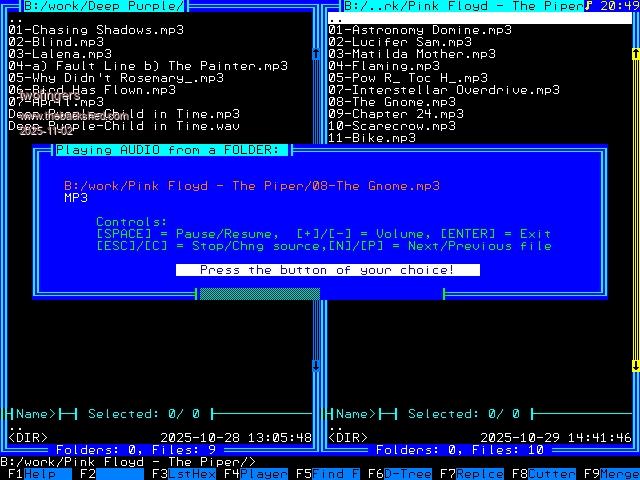

This is the "party edition" of the FM (FM02100b3-Party), an improvement on the FMb2 above.
The reason is to test and learn about the possibilities and limitations of the PLAY MP3 (FLAC, WAV) command for RP2350 on drive B:.
FM02100b3.Party.zip
New is the (experimental) integrated player for mp3, flac, and wav files (with Alt-F4). Both individual files – as before – and entire directories can be played in the background. This means that most of the FM's functions can be used in parallel as usual, except for example, copy operations, for which the audio output is paused. It was also necessary to temporarily disable the blinking cursor in the input routine during audio playback.
If an entire directory is to be played, the player assumes that all files are of the same type (mp3, flac, or wav). The player then automatically selects a type. The respective status (off, pause, play) of the player is displayed to the left of the time. The volume is 50 percent by default and can be changed in the player.
Caution: In very rare cases, the PicoMite has frozen when playing MP3s in the background and required a reset.

Started to use it a few days ago; mostly for playing music.
For playing single files all is OK, but I have not any success with playing a whole folder. Help (F1) says: Alt+F4 for plying a folder. Does not work for me. It wants to edit a file...
Probably an error between the backrest and the screen?

The development of the FM is dependent on receiving feedback due to the many different hardware platforms (Peter is to blame! ;-)). I only test on my system (HDMI reference design with USB keyboard and via TT console).
Have you tried pressing Backspace + F4? Because I (mistakenly) assume that all FM users are familiar with the entire thread and the development of the FM, I almost forgot that some might not know about this workaround using Backspace (BS). Which keyboard are you using? I had already considered adding the player function to CTRL-P as well.
It's also important to adapt the user configuration section in the source code.

My system is not any of the "standard" ones. I have made a homebrew with HDMI, SD and a USB-hub. Using a small wired "english" keyboard without the nordic letters (which are anyhow useless for MicroMite). Cheap wireless Microsoft mouse). All working very well.
I have tried many different combinations with F4 now including backspace+F4, but it seems that nothing plays the folder. Any other suggestions to try?

Now it works! Backspace+F4
I had to set OPTION KEYBOARD US for my new keyboard. No other changes needed.

It also seems that all files in the folder need to be music-files. I ripped some old CDs and among the flac-files there are a .gif and a .m3u file. Folder won't play before these are removed.

That shouldn't be the case. On my system, the file manager automatically searches for audio files, and if it finds any with the correct extension (MP3, FLAC, WAV), then those files are played.

FM02100b4.Spooky.zip
What's new?
- Audio playback can now be paused with Ctrl+P (Missing in "help").
- The player can also be opened with Shift+F4 (My mistake).
- A flashing of certain colors serves as a busy indicator – for example, when a large file list is being resorted (hence "Spooky"). The FM now uses MODE 3.
- Several minor improvements to the player.
