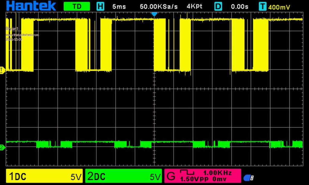

first scope test
Ch1 to D1
Ch2 to D7
Gnd

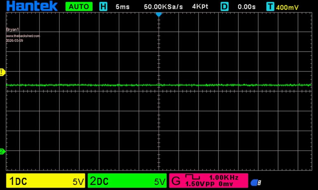

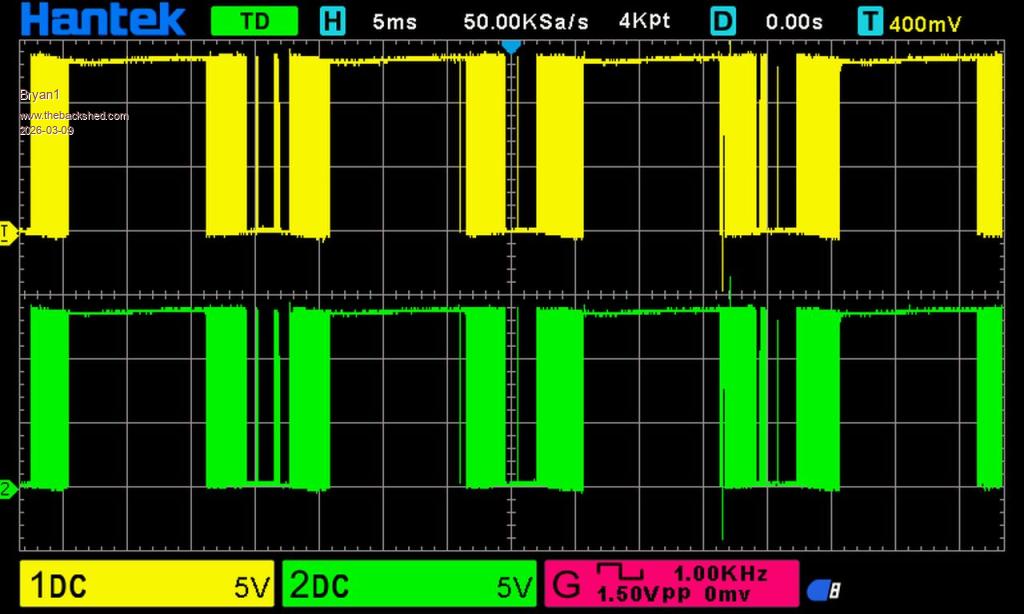

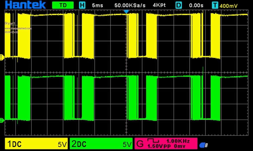

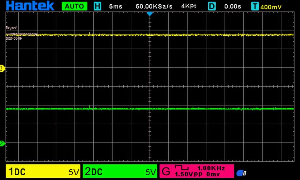

VS1 Low side
CH 1 pin 1 on the TIP42
CH 2 pin 1 in the TIP41
VS 2 low side same setup
more to come
VS1 high side
VS 2 high side
So it does look like the high side TIP's are gone.

Also, Bryan's scope traces are confusing.
TIP41 pin 1 and TIP42 pin 1 of the pair are connected together on the board, so Bryan's green trace is a duplicate of the yellow trace.
D1, D7 traces seem to show something wrong by the low P-P voltage of the green trace (D7) but I am no sure yet.
