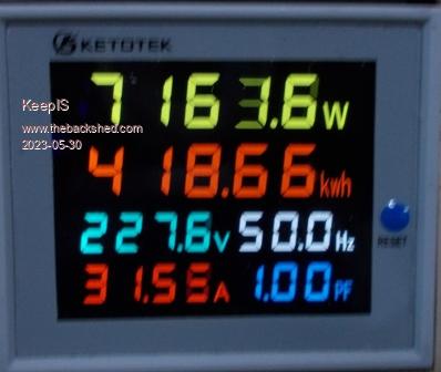

Found something stuck to my head 20 minutes ago.
The only spanner in the works, I could not really disconnect the House loads, but they were only around 400 watts when I did the 10 minute test, so, almost all of the load was resistive.

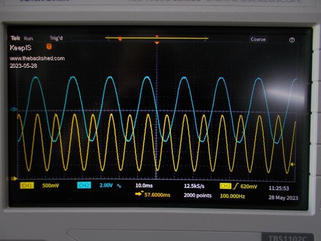

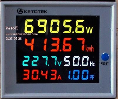

Inverter running at just under 7kW for 10 minutes.
Peak DC input current swing 263A.
AC current 30A
AC voltage 227.7vac.... It is exactly the same voltage at idle.
BELOW:
Everything looks good to me: Toriod obviously silent.
Blue: AC ... Yellow DC input current.
The heatsink on the back of the cabinet:
It's the same temperature as the FET heat transfer mounting blocks, so I'm 100% happy with the method I used to couple the FETS, temperature went from 28 to 31 deg after 10 minutes at 7kW. There is ZERO fan cooling.
Toriod went from 31 to 35 deg after 8 minutes at 7kW, stayed there as the fans came on and off for a just a few seconds at a time, turned on 3 times.
I must change the Fuse block at the input to the inverter - dam thing gets hot - as in burn your fingers, will try a DC/AC breaker the others are using.
I need to redo one connection to a chokes and one on the input, they get quite warm, the rest are fine.
The Contactor on the inverter: The terminals are the same temperature as the coil and housing, a result of a small holding current in the coil, warm to touch is all.
All DC and Toriod connections on wiseguys power board are only slightly warm to touch, I've been checking them under every heavy load, they appear to be a real quality high current screw connectors, board warm slightly after 10 minutes.
The rest of the external Battery supply chain, interconnects, fuses and breakers are at room temp.
I think that's a good effort for its first run at a high constant power level, even if it was only for 10 minutes - small steps!

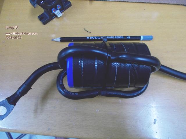

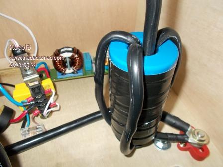

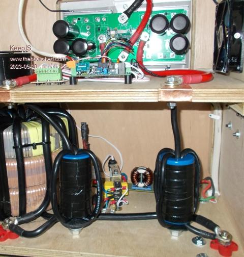

Found the problems with the connections mentioned above, 1 bad termination and the wrong washer on a another, must have grabbed the wrong one when assembling it the other day.
I think I fixed the big Fuse holder, which BTW is not there to protect the Inverter board or FETS, the Caps themselves will make sure there is nothing left to protect, it's only to stop the heavy DC cables from causing havoc if they somehow shorted, the fuse works, I tested it, well, I spot welded a steel bar across two terminals when I tried to test it, it blew, so I guess it's tested
I'll repeat high load testing tomorrow and recheck all the connections once more.

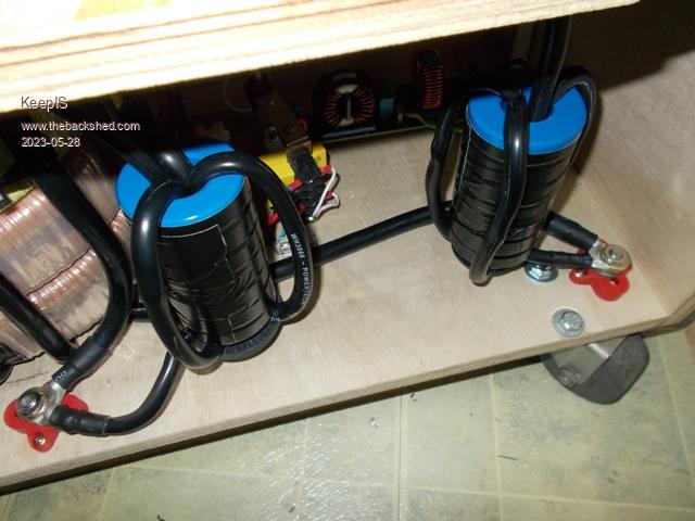

A poor pix of the new Chokes installed, 4 turns on each, they are on standoffs, so they look a bit taller then they really are. A blue toriod ring on each end of 4 black toriods rings. As mentioned before I used what I had.

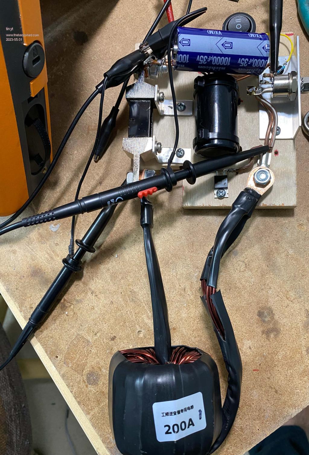

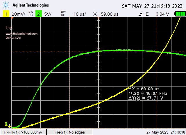

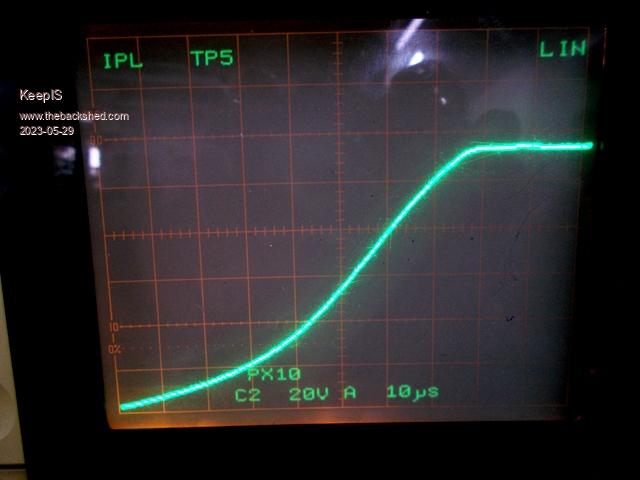

Rewound Chokes:
I removed one Blue toriod and got the inductance down to 20uH from 23uH.
Total inductance is now 40uH down from 46uH.
Below:
Saturation curve for One 20uH Choke, there are two Chokes in the Primary.
V-scale: 250A per division:

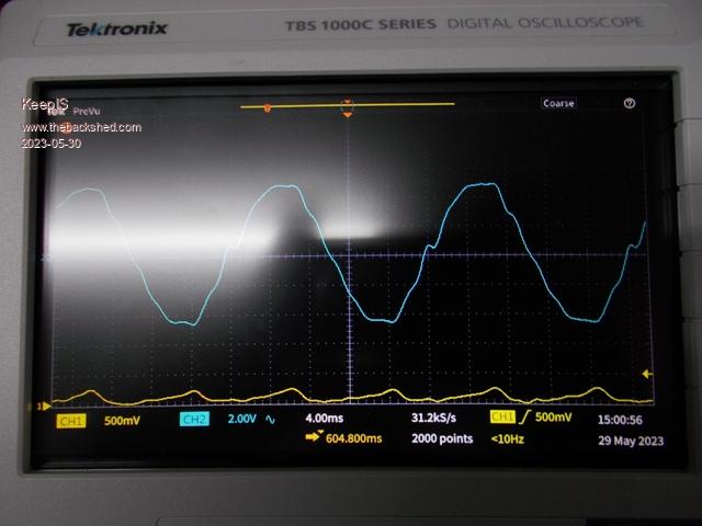

Today: Before changing from 46uH to 40uH, I re-tested the Inverter with the Hair straighteners plugged in very close to the Inverter.
All other loads are always near the inverter.
Hair straightener.
46uH Choke
The UPS started to beep, but noise was still not "to" bad.
Choke 40uH
The UPS is silent - buzz is just in the background.
Everything else was silent at 40uH.

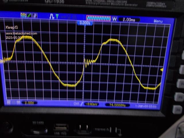

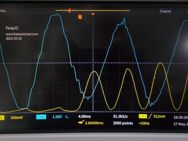

Bad Inverter Loads:
Briefly and simplistically generalized by myself: Going back 7 years in various forum postings, the decision when choosing a Choke was initially around the lowest Idle current, the rational was sound, it was realized that normal inverter loads were around 300 to 1kW 99% of the time and for a number of reasons, most of us went for the lowest idle current.
We still make that choice, but in my case I have proven that it's not really a compromise to get a Choke that virtually stops 99% of the noise, even with bad loads, even loads that in the past would destroy some inverter, obviously "DUH" this can "not" be put down to simply changing a Choke.
The typical Waveform:
ABOVE:
This is what you see with Heatguns that switch a Diode in series with the Heating element on LOW. The same thing happens with the Hair Straighteners, and even the AirCon. Choke value was around 58uH, very high saturation chokes in all cases.
This was with the China inverter in the Cabinet, I never bothered with capturing an image of the New inverter board running this load, but it was quieter, still made you want to turn it of "quickly" though.
These Loads vary in how deep they cause a step into the waveform, other waveform distortions and how much ringing they cause. Almost like hitting something with a hammer, in this case the Toriod, and making it ring.
I've found that one change I can make in the Inverter that has a very noticeable change to the amount of ringing, Toriod noise, and helps reduce the step in, or at least reduce the sharp edge nature of it, is the Choke inductance.

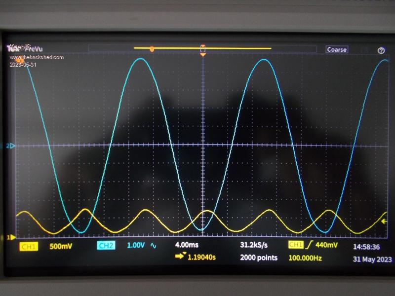

Below
37uH to 40uH Choke:
30A peak DC input and the step around 6A, the AC load is around 400 watts
The ringing has completely gone from what I was seeing the other day, and the step in is less.
There is only a small value of current at the step. This inverter is now very quite running this load. Before it was scary loud, flashing Workshop lights and UPS beeping like crazy.

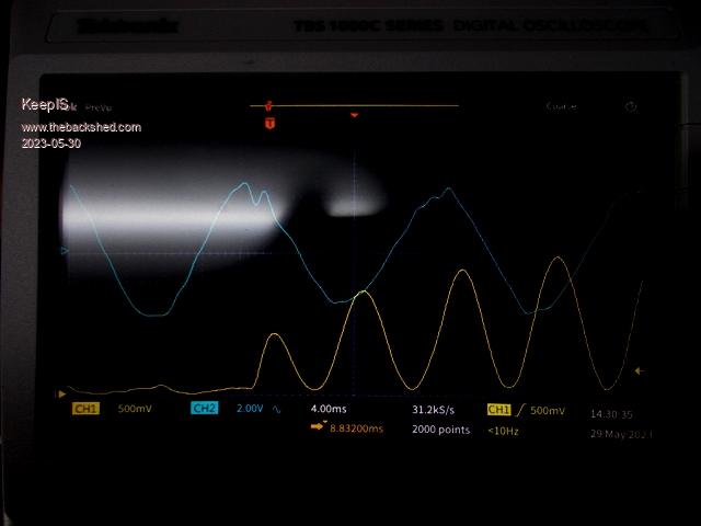

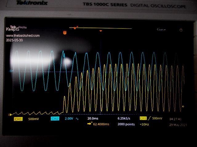

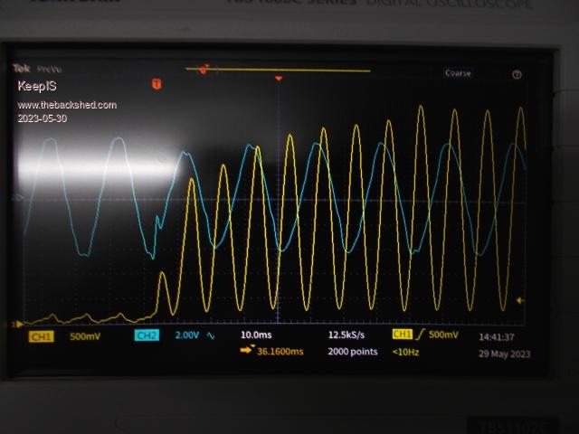

DE - Induction motor startup with 2 x 21uH Chokes:
The 100Hz DC current no longer varying between half cycle pulses for each complete 50Hz cycle.
There is no longer any ringing in random cycles of the 230vAC waveform.
Closer look at startup: Reaching 312A peak input at the 4th cycle, and on it's way to 380A which will hold for 2.5 seconds before falling off.

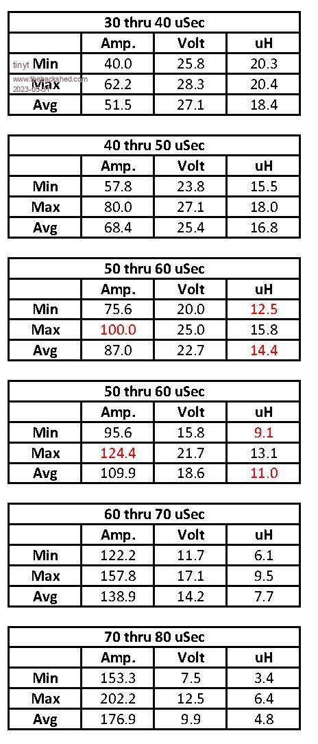

I was just looking back and found a test that Poida did:
  Quote  I just tried this with a 60W Apple "magsafe" macbook power supply.
The negative going peak is 30V which is 315 Amps.
Perhaps the minimum saturation point should be around 400A and not 300A, I believe Poida was measuring the Primary current. Which stands to reason as the FET Switching currents can be higher then DC input current depending on the Duty cycle.

I know this is likely boring, but, I did get another pix of the Inverters AC OP meter. I didn't catch the 8kW load on the Meter as I had to turn the inverter off due to a Large Fuse holder going into meltdown, not the fuse but the Metal Block cable connections.
I did however get the 7kW+ reading, it was varying between 7.1kW and 7.3kW at the time.

  KeepIS said  Hi, the Inductance is calculated from the resonant frequency of the choke with a known value of parallel capacitance. In my case 4.08uF. I have a Vector analyzer and other RF equipment but I find this method gives me 100% consistent results for these types of chokes.
Can the inductance be calculated/estimated using the results from a choke saturation tester?

  KeepIS said  Yes, Poida discussed the correct way and the math to do this using a saturation tester and DSO. It also allows you to calculate the Inductance at various points as you climb the slope to full saturation.
Thanks to you and Poida. I bought this 200A inductor which does not publish its inductance. So, I made a tester from your schematic, total capacitance is 20000 uF.
Took me some time to make the scr trigger work. I used a 200A 75mV shunt, and a DSO. I enabled bandwidth limiting for both channels to filter out some of the 'noise'.
Luckily the DSO I borrowed can save readings in excel format (csv). But I think bandwidth limiting is not applied to the numbers. I did some calculations to selected ranges. Red colored numbers are what I think the approach to saturation.
Looks like its inductance is a little low for the inverter I am making.
Thanks for sharing your work.

Great work, I had a similar choke from China, it was wound on 3 Black toriod rings, same Toriods as I'm using for the Chokes I make.
I think the current rating they advertise is the current the choke will handle without melting
The Inductance was supposed to be 47uH (where have I heard that value before) and made for their big inverter boards. Turned out to be around 39uH, saturation was still fair at around 220A, which is never going to cut it for a decent inverter.
As you measured, there is not much Inductance left for big loads, OK for reducing idle currents, but nothing left when the going gets tough.
BTW: Found a permanent fix for the melting Fuse holder - I removed it
I'm going to do something I've been wanting to do for a while. Fit a 500A [700A] peak Hall Sensor on the DC input, and as the voltage output is so stable, accurate and noise free, it can be easily set to an exact Trip current, I'll use that to halt the Inverter drive and throw the Big Contractor solenoid open in the event of a catastrophic current surge.

AC waveform at 2.3kW. A big VFD Lathe under load and Dust-ext Induction motor running, along with the rest of house loads. Something that causes a flat top appearance on the AC [Mains and Inverter AC] was not running at the time, I must hunt that down, I still think our huge Inverter Fridge Freezer is almost always sitting across the AC supply and just idling along and causing this.
