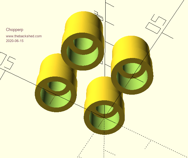

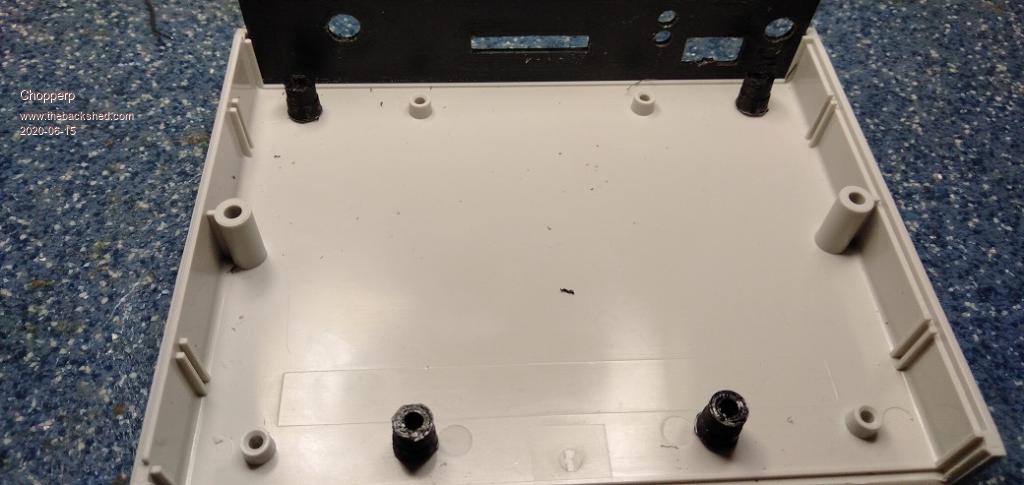

I was fitting 3D printed 5mm high standoffs to mount the CMM2 board, then I realised I could make some that fit over the exiting mounts, making mounting the board easier, so I did.
4 rough & ready pieces produced & fitted as shown below. Worked well.
I had also 3D printed the two panels. Front printed at 0.2mm layer height was average. The rear printed at 0.1mm was a bit better
Simple SCAD code for one standoff
translate([0,0,0]){
   difference(){
   cylinder(h = 4, d = 7.5, $fn = 180, center = false);
   translate ([0,0,-0.1])
   cylinder(h= 5.2, d = 5.5, $fn = 180, center = false);
translate([0,0,4]){
   difference(){
   cylinder(h = 5, d = 7, $fn = 180, center = false);
   cylinder(h = 5.2, d = 3.5, $fn = 180, center = false);

Posted: 12:45am 15 Jun 2020
Your standoffs will make fitting easier.
I cheated and drilled through the base and used 2mm countersunk bolts to mount the board. Saved trying to keep the standoffs in place.

  TassyJim said  Your standoffs will make fitting easier.
Yes, they certainly do especially as you have to angle the board to get it with the front panel in place.

I have found, while playing around with my front/rear panel sets, that you can really ignore the standoffs essentially.
Fit the front and rear panels to the board, lower into the base of the plastic enclosure, then simply do up the case screws.
The board can still move a little, but is is held pretty much in place just with the panels alone.  Fit a couple of small strips of foam-rubber to the top of the board, and then install the top of the case and do up the screws, and the foam-rubber holds the board pretty much perfectly, and stops it even rattling about even a little bit.
No need to then bother with the fiddly spacers, which INSIST on falling off or moving while you try to lower the board+panels into the case.  I guess you could certainly glue the spacers in just as Chopperp did, but I had done the foam-rubber thing before I updated my brain on this thread!

  Grogster said  II guess you could certainly glue the spacers in just as Chopperp did, but I had done the foam-rubber thing before I updated my brain on this thread!
Mine were a press (tight) fit over the existing mounting points. No gluing required.
My CMM2 came from CG & doesn't have the rear socket as such, & no front power switch so not much to hold the board to the back panel & same for the front panel.
With all the updates coming forth, one is always taking the lid off anyway.
