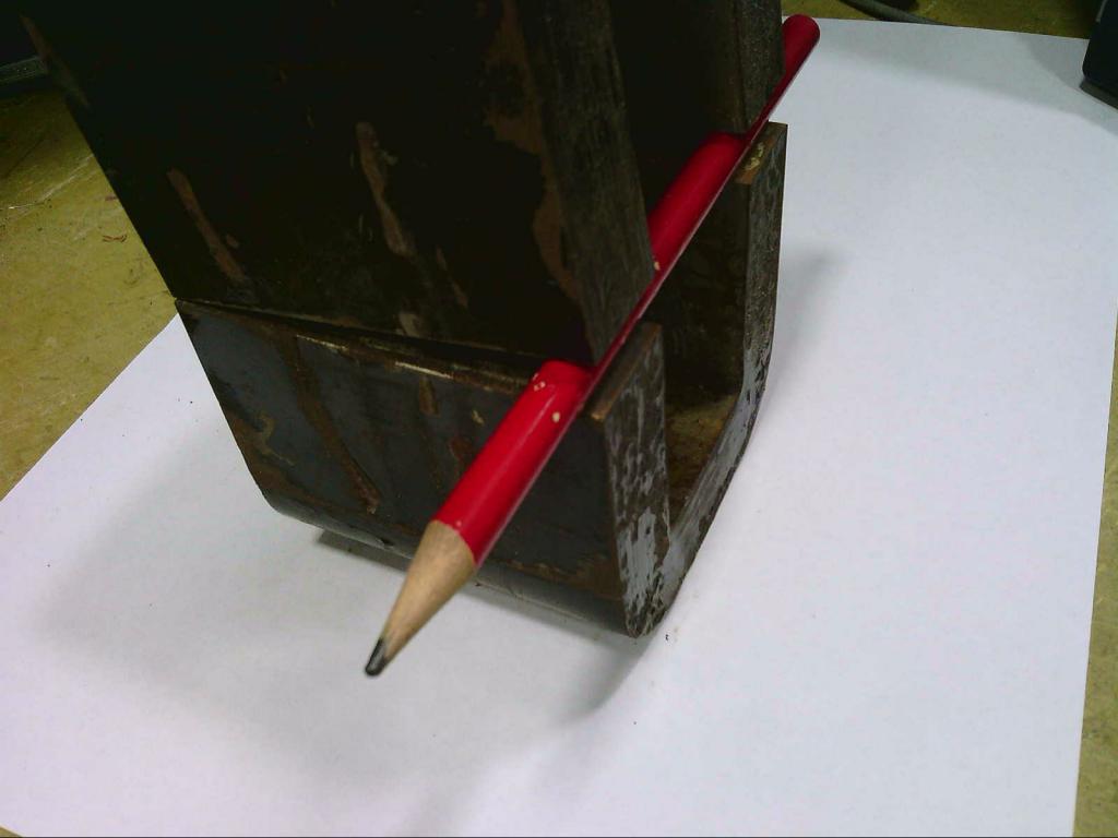

While you are in the choke testing mood, try making a "swinging choke" out of a pair of those steel U cores.
By tilting the cores with respect to each other, its possible to have a high inductance at low dc current, and have a much lower inductance at high dc current.
In other words a very soft upward sweeping progressive saturation characteristic, using ordinary steel core material, which would otherwise saturate much more suddenly.
This is an easy to photograph exaggeration of tilting a core pair, using a pencil.
A hypothetical air gap might be say, 0.5mm at the thin side and 2mm at the wide side.
Give this a try, Klaus has tested a few of these swinging chokes with great success.
