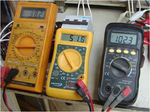

I have a pic of the voltages I measured today.
The meter on the left is the ACV across 2phases. The centre meter is the DC voltage across the lower bridge of the voltage doubler. The right meter is the voltage across the two bridges.
WRT your comments.
I treat the voltage doubler like 2 series cap coupled arrangements that are parallel across the windings but in series across the load. This to me is the easiest way to visualize.
In the cct here
What I have seen is that the caps connected to the top rectifiers develop a negative DC voltage when measured between the AC from the winding and the rectifier input, and the caps connected to the bottom rectifiers develop a positive DC voltage when measured between the AC from the winding and the rectifier input.
The sum of the absolute value of the voltages equals half the output voltage. The voltages are not static, but change with loading and AC input voltage.
As to what to call the diodes function????? I suppose normal rectifiers could be called steering diodes as well.
To test the function of my cap voltage doubler arrangement would not require large expensive caps or bridge rectifiers. 3phase source may be a problem for some. I would not go back to a single phase test as the ripple makes it harder to measure without a CRO.
Gordon.

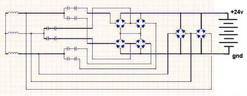

so Gordon, how does the series load work with 24V battery and a 48+V inverter like the PVE1200, ie like Phill's
I cant understand this part of how it works per the schematic, would obviously save me some money in batteries.

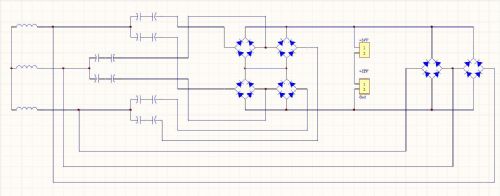

I have noticed an error in the cap article. There should be a connection between both pairs of bridge rectifiers. That is the 2 + terminals of the bottom rectifiers shoud be connected together, and the 2 - ve terminals of the top set of rectifiers should be connected together, and these sets are then connected together. This means 4 connections in the centre between the rectifiers. My original picture in the forum thread a way up now was correct.
I expect Gizmo will be able to easily fix the pic in the article.
There have not been any Queries, so I suspect no one noticed a difference either.
I hope all readers have the correct wiring, as in my pic above.

Hi again Gordon. I'm always following progress, and again I have a mill worth trying this on. Maybe I will add some experience with industrial motor conversions, where so far most success has been with the F&P's.
I do want to understand the diagram as well as possible, first, and the reduction in resolution makes it hard to read the image. I also cannot tell if Gizmo has updated your diagram image or not, so the starting point may be a bit out of date. What I can see leaves me with a question. I've "tweaked" the drawing to show what I mean:
Do you have to use 12v batteries? It looks like a continuous string of cells for 24v should be connected, like I've shown in my edited version.
I'm not very familiar with circuit drawing conventions so maybe you're not supposed to draw things this way, or maybe you've used a short-hand notation and it's obvious to everyone but me.
I also use a 3-phase bridge in my system, not the little square bricks, and it looks like it won't matter as long as I use the 4 brick rectifiers as you've shown in the parallel Cap circuits. If I'm right so far, I'll draw up my own circuit diagram and post it.
Hopefull someone will give a shout if I'm about to let the magic smoke out.

PS: anyone with a multimeter, handy with a soldering iron, or clip leads, with a 3phase PM motor and 12 diodes and 12 DC caps could show the voltage doubler function as an academic exercise. probably a few dollars for new components, Low voltage testing, not even a battery needed, 1n4001 diodes and 10uF 35V caps, and spinning the motor by hand on a pulley.
The usefulness with a windmill comes with component sizing for the required power levels.
PPS: from the meter readings above.
The ACV was 38.2VAC. This would be approx 54.01 peakDCV, less approx 1.2V diode loss, so 52.8VDC. The measured 51.8V is close enough. double this is 103.6VDC. The measured 102.3 is close enough. All these measurements are within the meter measurement errors.Edited by GWatPE 2009-11-14

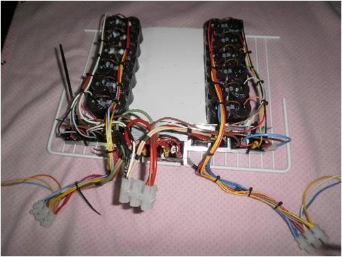

I reckon you should call it the
"OZ-FLUX CAPACITOR"
It will sit in the "fridge" electrical cabinet.
Additional wires with ends are for the stop switches.
This setup uses 12x 35A bridge rectifiers and 24x 680uf 450V caps back to back.
Can be used for a dual stator mill or in my case a single stator with half in star and half in delta.
caps ebay from Japan- best I could do was $100USD including freight.(which was 1/3 of the cost)
Total is about $180 bucks worth of bits here and about 3-4hrs to put it together.
From an economic point of view at 18c/kw/hr =1000KWhrs extra the 'mill will need to make over its life.
I figure 1KW/hr/day extra it will make over uncapped rig call it 3 year payback which is not unreasonable.

My voltage multipliers are working on my new design AxFx mill. Phillm has the Rolls Royce version at 3kW. The cap article has more details of my cap arrangements, and Phill has posted his config elsewhere as well.
I have 12V batteries and LiPo cells. The battery is just that, an accumulation of cells. This gives the system voltage. A battery is not essential, but smooths out the transient power bursts from wind gusts.
Your pic is OK. 3phase bridges make the connections easier as well. You will only need a total of 3.
Gordon.

[quote]3phase bridges make the connections easier as well. You will only need a total of 3. [/quote]
Three instead of four rectifier blocks: This will probably become more obvious as I draw it up.
Once I have a good diagram and tried wiring it up, I do want to try a Spice sim, too. Thanks.
Steven T. Fahey
Posted: 08:48pm 13 Nov 2009
Hi sparweb,
Yes, with 3phase bridges, only 3 in a total system of cap doubler with a normal rectifier. 2 used in the cap voltage doubler, and one for the normal rectifier. The direct connected 3phase bridge would have a higher current capacity, as outlined in the cap article.
It will be interesting to see what spice comes up with.
Gordon.
