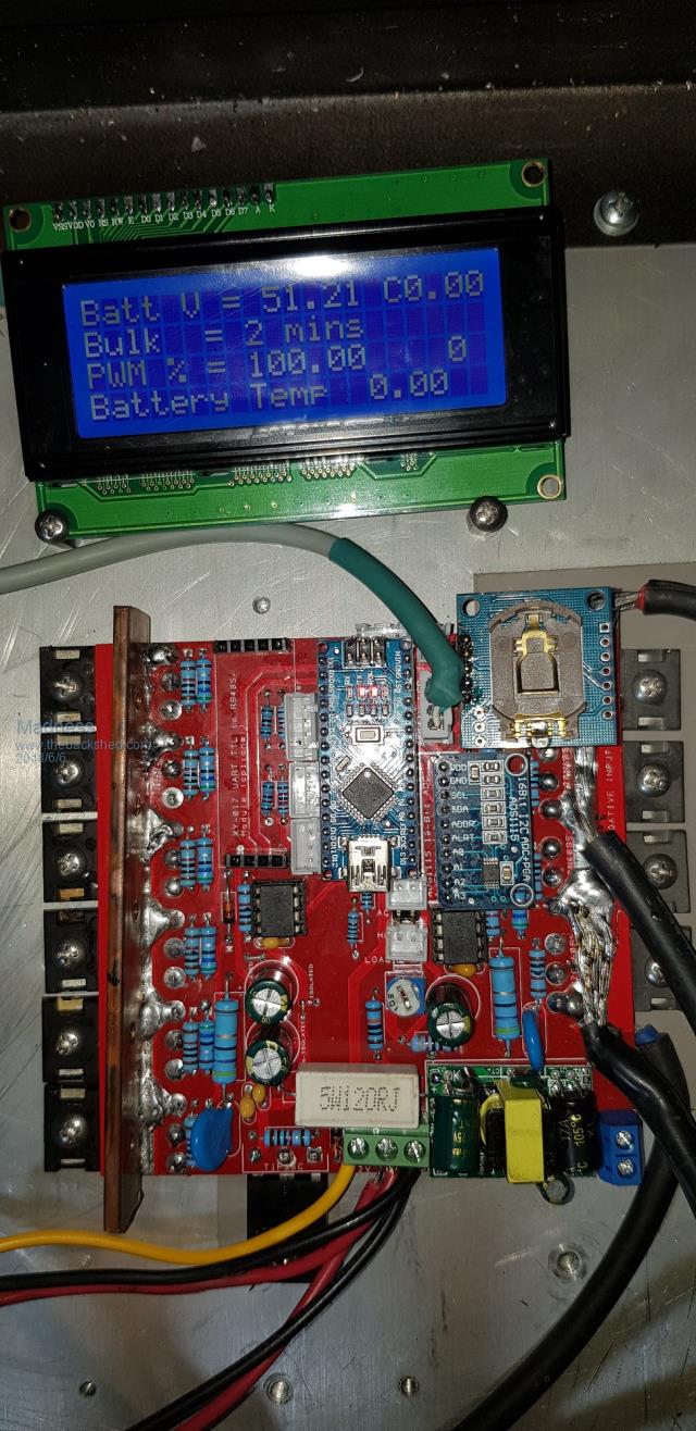

I have assembled the new version of the charge regulator but have run out of time today to test it. It will need to wait to the weekend now to try it out.

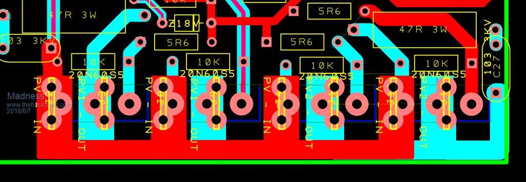

Neat PCB board Gary but a little compromised by the direct soldering on of those big black wires. Doing that is very tough on the track underneath, from a mechanical and heat stress during soldering point of view.
Can I suggest, for your next board layout to provide an area to bolt on cable lugs directly to the board or, if room is short, have a right angle copper bracket that bolts to the PCB at that track and then you can bolt on several solder lugs to the raised end of that copper bracket.
I should think a copper strip 25mm x 1.6mm should do to make neat high current connecting lugs.
You can see a real high current version of this on a picture of my inverter, used to connect the negative rail to the PCB. I think even oztules now uses this method, from what I spotted on his pictures.
Posted: 10:40am 06 Jun 2018
Trouble is getting bolts through the pcb when you have tracks the other side. I have yet to see a failure soldering directly to the PCB.Edited by Madness 2018-06-07

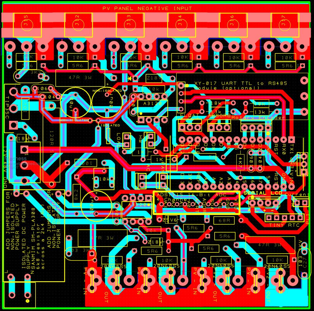

I have worked out a way to improve the connection of the DC from the PV panels for the GTI. I have changed it to 6.3mm spade terminals right next to the MOSFET legs, as the MOSFETs are on the bottom side of the PCB and flat against the board this means there will be no interference between the 2.
The other side will have to remain as it is for the high current for low voltage DC to DC as the current is much too high for the 20A limit of spade terminals. I have used 15 X 3 MM copper bar with M4 threads, it is quite easy to attach to the PCB, just file clean the edge. I put solder on the PCB first and then heat the copper with a Butane gas torch and tin the edge. While the copper is hot just place it on the PCB in the right spot. It melts the solder on the PCB, then just keep it in place until it cools enough for the solder to harden. This does not put excess heat on the PCB, it is best to do it after the MOSFETs are installed otherwise it is hard to solder them as the copper draws away the heat.

These terminals work quite well High Current PCB Terminal, the M5 ones come up sometimes, 40 - 80 amps should be ok.

Thanks Mike, that is very helpful, even found a 180A M8 Version.
I had thought of using the M4 ones that are on the Areosharp PCBs but could not find a source, now I know what they are called it is easy to find and buy them if needed. Edited by Madness 2018-06-08

Thanks for taking up this suggestion Gary, a well worth while addition, especially to people who might not have much experience with high current connections.
That 180Amp terminal would do well on your inverter PCB, one at each end would give a choice for connecting the negative cable.
Posted: 07:58am 07 Jun 2018
Inverter PCBs are not something I am doing anything with ATM, however I don't think one connection is going to be a good idea. Having to rely on the PCB copper to conduct across 300MM is stretching it a bit, I will look at something with multiple connections.
I have made further changes to the Regulator PCB to include these SMD Terminals .
They are almost identical to the ones in the Aerosharp PCBs except they are M3 and through hole. I have checked and it easy to bend them to the same as the photo above. Being SMD made it much easier than trying to use through hole, that would have required a major increase in PCB size. Six of them fit across nicely with just 0.2MM overhang, the output is via the heatsink. So those plus the Spade Terminals on the HVDC side eliminates heavy soldering on the PCB and can still take big currents.

Thanks Ralph, Should be ready to order PCBs sometime next week. I just need to confirm I have got everything right for the current sensing.
I will just clarify what they will do, they can be used as a basic charge control regulator for a GTI (any size 1 or 2 Channels I am running 7KW of panels) back feeding through your inverter. That is handled by the 4 20A 600V MOSFETs on the bottom of the PCB, the 6 200A 80V MOSFETs on the top side will regulate DC from PV to your batteries by PWM. The best panels for this are those that have a maximum power voltage just over 30V, so running these in strings of 2 gives maximum power around 61V. There is virtually no losses with this regulator, you don't get MPPT (the GTI will have it) but what you save in the cost of the regulator will buy you a lot more panels to make up for it. This Regulator will handle at least 10KW of panels going DC to 48VDC. You can use just a GTI or just DC to DC or both giving a possible 20KW capability. You might think you will never have that many panels but secondhand panels are getting cheaper all the time, I recently saw someone selling 30KW of 250-watt panels for $30 each and less for bulk buys.
There is no such thing as having too many panels when it is cloudy you can still get plenty of power if you have enough panels. Where it could be a problem is putting too much power into your batteries when the sun is bright, so I am also using a 300A Hall Effect Sensor to monitor battery current. This will then allow limiting the battery current to a suitable level for your batteries. Also it will be used to give you a battery state of charge reading which is particularly useful for people that don't understand how it all works but just want to know "How Much Power is in the batteries".
Other things it will do is regulate another GTI via a second PCB set up as a slave (same PCB with less components and different program) up to 1.2KM away via twisted pair wires, turn on a HWS when there is excess power, control a battery vent fan, control a dump load and more.
