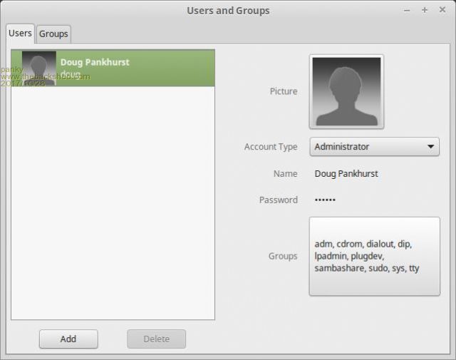

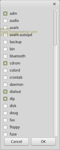

I am a member of the dialout group.

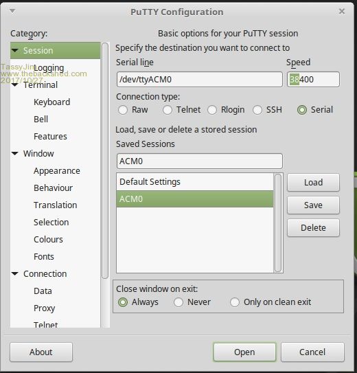

When you start Putty, you should be presented with the configuration screen
Select serial, 38400 baud rate and /dev/ttyACM0 or /dev?ttyUSB0 etc
give the connection a name and "save"
The next time you select that connection from the list.
click on "connect"

I have set up the symlinks in dosdevices and am a member of dialout and sys groups.

Just occurred to me, the problem with the putty screen. Look at Tassy Jim's picture above here, and left pane with all the options: Telnet can just be seen, also notice the 'pull bar' to the right, showing 'there is more'. The pull bar is readily distinguishable here, but on my system you can not see it until hovering right over it with the mouse.
That cost me a lot of time, because the last option is Serial I never found in the beginning and in that field you set the proper "com link" ie instruct Putty which USB/serial port to be used the first time and when then saving the configuration you no longer need to worry about this (until the configuration changes). You just select the svaed configuration next time, all Putty parameters is are set up in the saved version.
I can certainly imagine that being the problem for you. There is however the question about Mint, perhaps this is a nonexistent problem, ie you can see the complete Putty Screen Config. Edited by plover 2017-10-28

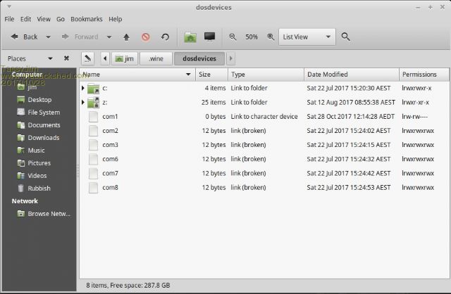

At the risk of leading you further astray, this is what I see in my dosdevices folder with NOTHING plugged in.
All links are listed as 'broken'
When I plug in one 'mite and refresh the display, the first port becomes active.
The device I plugged in uses a standard USB port so com1 is linked to /dev/ttyUSB0
If I had used a 'mite that comes up as ttyACM0, it would have been com6 that became active.
Until you can see a link to character device in the dosdevices folder, it is no use trying MMEdit.
Comparing the permissions for broken and linked might help too.

It has been a steep learning curve and I am now more familiar with the Mint command line than I thought possible or desirable but it has been fun.. Thanks to all who have contributed to this thread - I hope it has helped Paul as well.
Doug.
Posted: 04:01pm 27 Oct 2017
Glad you finally have it working Doug.
I am not sure why you have to get so aggressive with the permissions in the MMedit folder. My 'standard' install only has the *.exe files executable. Even the dll's are only read/write.
It might be because you didn't install into the default Program Files folder.
You do seem to have a few permissions errors so it might be that instead.
Posted: 04:05pm 27 Oct 2017
  panky said
doug@dougMint17 ~ $ ln -s /dev/ttyACM0 ~/.wine/dosdevices/com7
doug@dougMint17 ~ $ ln -s /dev/ttyUSB0 ~/.wine/dosdevices/com8
doug@dougMint17 ~ $ ls -a -l ~/.wine/dosdevices
total 8
drwxrwxrwx 2 doug doug 4096 Oct 28 12:15 .
drwxrwxrwx 4 doug doug 4096 Oct 28 10:49 ..
lrwxrwxrwx 1 doug doug 10 Oct 25 12:37 c: -> ../drive_c
lrwxrwxrwx 1 doug doug 10 Oct 28 10:48 com1 -> /dev/ttyS0
lrwxrwxrwx 1 doug doug 12 Oct 28 10:44 com11 -> /dev/ttyACM0
lrwxrwxrwx 1 doug doug 10 Oct 28 10:48 com2 -> /dev/ttyS1
lrwxrwxrwx 1 doug doug 12 Oct 28 10:46 com3 -> /dev/ttyUSB0
lrwxrwxrwx 1 doug doug 12 Oct 28 10:46 com4 -> /dev/ttyUSB1
lrwxrwxrwx 1 doug doug 12 Oct 28 10:46 com5 -> /dev/ttyACM0
lrwxrwxrwx 1 doug doug 12 Oct 28 12:14 com7 -> /dev/ttyACM0
lrwxrwxrwx 1 doug doug 12 Oct 28 12:15 com8 -> /dev/ttyUSB0
lrwxrwxrwx 1 doug doug 8 Oct 25 12:38 d:: -> /dev/sr0
lrwxrwxrwx 1 doug doug 21 Oct 28 10:48 e: -> /media/doug/8FE6-2DA1
lrwxrwxrwx 1 doug doug 14 Oct 28 10:11 e:: -> /dev/mmcblk0p1
lrwxrwxrwx 1 doug doug 12 Oct 28 10:11 f:: -> /dev/mmcblk0
lrwxrwxrwx 1 doug doug 1 Oct 25 12:37 z: -> /
doug@dougMint17 ~ $
Any reason for having com11, com5 and com7 all linking to ttyACM0
Likewise com3 and com8 linked to ttyUSB0
JimEdited by TassyJim 2017-10-29

@palcal
Paul,
The best way to add yourself to the dialout group is to open up the Users and Groups window.
Do this by selecting Menu (bottom left of screen) then up to All Applications. Scroll down to Users and Groups. Selecting this will open a window asking for your password. You will then find yourself in the User and Groups window. Click on yourself then select the tab Groups at the top. You will now see a list of groups you belong to on the right of the window.
Click on the list there which will bring up a window of groups you belong to and you can select additional groups as needed. Select dialout and then OK.
You are now a member of dialout. Close Users and Groups.
This was all I needed to do for both putty and MMedit.
Cheers,
Doug

@jim
No special reason Jim other than my 144 pin MMX board shows up as COM11 under windows. I thought there may have been something special that required it to be linked in Mint the same however that is not the case. I have just kept it as com11 purely for consistency. I have tested and it could by 5 or 7 or anything else - they all work.
In fact I found you can have multiple com ports sym linked to the same ttyACM port if you choose to.
Doug.
palcal
Joined: 12/10/2011
Posts: 2055
Posted: 11:19am 28 Oct 2017
@Panky
Did what you said and added the dialout group but when I open Users and Groups I get my name but the right hand pane is completely blank, no picture, account type, name or anything and Putty still no go.
Paul.
