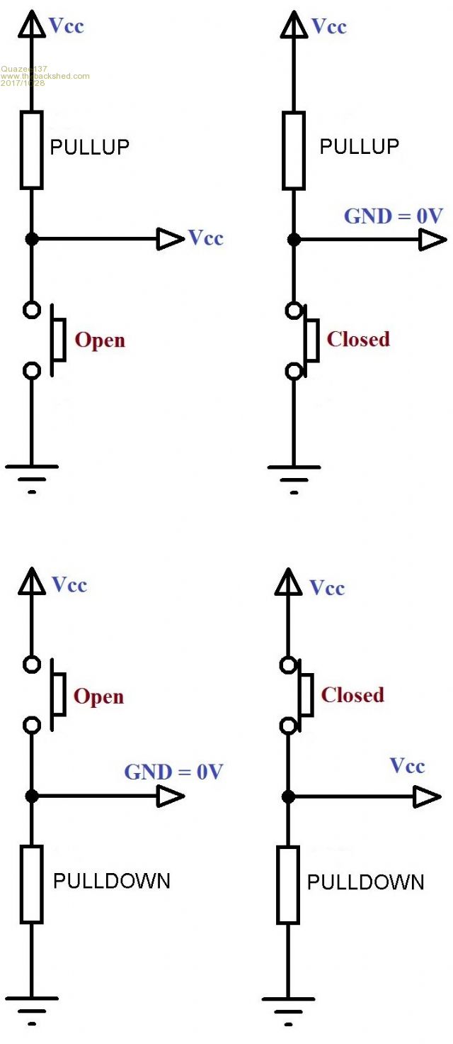

Just a thought can you go the other way
do PULLDOWN and have the switch goto 3.3v
and look for a high or Interrupt on low input
to high.

  Quazee137 said   Just a thought can you go the other way do PULLDOWN and have the switch goto 3.3v and look for a high or Interrupt on low input to high.
Sure, that would work, sort of. But, in the big picture, none of these "Fixes" to a flawed circuit will cut it in the long run.

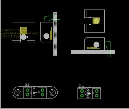

May be trying a sealed version will work keeping all else the same.
tilt sw
or
tilt sw 2
the problem may be only in the switch being unsealed.

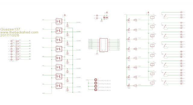

was adding parts and saw the opto library and got an idea.
Edited by Quazee137 2017-10-30
