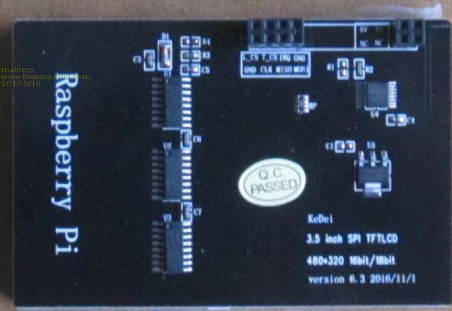

Posted: 07:31am 16 Sep 2017
Don't buy this display as I won't be supporting it on either the MMX or Pi-cromite.
Note the split connector. When you examine it closely you can see there is only one chip select connection for the display itself + the SPI connections. This is because the display is set for 3-wire serial mode. In this mode the data/command mode is set by adding a bit to the front of each byte - i.e. a 9-bit transfer. Neither the MMX nor Pi can support this in hardware so the I/F would have to be bit-banged. The vendor KeDei does provide a Pi image to support the screen but, unsurprisingly, it runs like a dead pig.
Oh well £10 wasted but I'll harvest the various chips for possible future useEdited by matherp 2017-09-17
