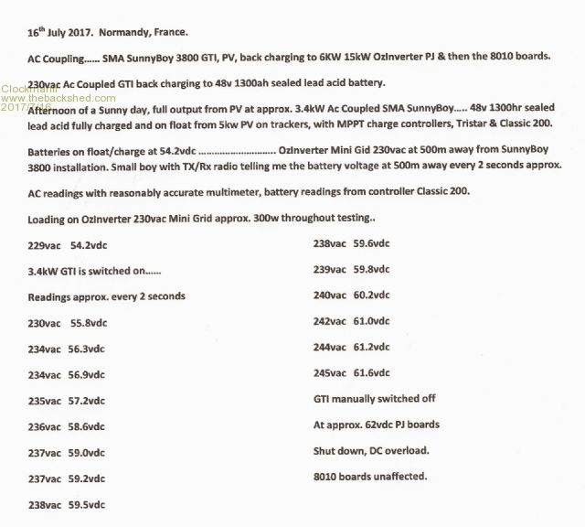

Okay Oztules & Madness, finally got some test data on the AC voltage rise set against battery voltage rise when a GTI is backcharging
Note, the batts were full and on float, no diversion or dump loads.
Note, the 8010 boards had a similar readings, but I stopped at just before 62vdc.
Edited by Clockmanfr 2017-07-17

Well that looks like mountains of room to play with... looks like I just need more sun to push the thing harder..... hopefully get some sun today, and will try a little tranny out.
It seems to gyrate around a few ( up to 5 maybe) hundredths of a volt in it's fuzzy logic of up down, and thats dividing from 59v. I'd still be very happy with 60v if I was ac sensing.
So it looks like each GTI inverter could have this built in.
Hope you have a good season there in Normandy.... very cool here.

Hmm, Oztules gets no ac voltage rise on his 8010 boards. hmm
Mine were just as similar as the PJ boards, hmm. I will delve deeper, but that means if there are differences with the OzInverter Mk1,2,3,4,5 and 6, then the AC side is not a viable option.
I was trying to get a simple robust solution to shut the AC side down of the GTI, its normal operating parameters on most GTI's. Yes a Bang Bang as oztules calls it.
Don't get me wrong I love your DC control and the Arduino set up, but being very honest here, coding and what you have done is far beyond my small brain. Sadly at present, I am not in the Ardunio club.
Here this time of year, my time is constantly filled with multitude of other tasks and projects.
Back to my preset DC battery voltage Bang Bang on the AC side using a TX/RX and a few relays.

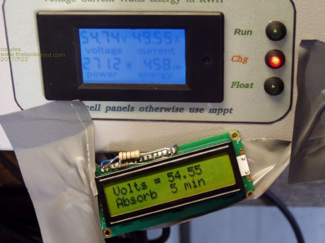

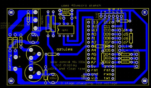

ok clockman, things have changed.
It is now a fully digital affair, The LCD readout has voltage, and mins of each stage in real time... the micro also has outputs for three leds if you don't want the screen .... just to tell you where in the charge cycle you are.
The board looks like this now, and I will get some made, as pcbway is doing 10 boards for 5 dollars..... i cant make them in the bath for that.
The code for it is this at the moment.
Will be tested fully today, but appears to pass the smell test.

oztules
Joined: 26/07/2007
Posts: 1686
Posted: 02:23pm 21 Jul 2017
Here is what it looks like cobbled into/onto and outside of the DC DC solar controller box.
So it can run GTI or 60v or whatever solar panel to battery controller box.. like this one is.
Yes there is a discrepancy of about .2v with the two voltages, but thats just changing a single line in the program.
The lights are now integrated with the computer, and run now means bulk, chg now means absorb, and float will mean float... need to make another label.
The calibration pots on the board also affect the voltage algorithm.... pesky, but thats life... the calibration figure in the micro, is used on the voltage from the divider on the board.... so a change in one necessitates a change in the other.
.....oztules
edit ... the curse of testing with short time intervals, is you don;tpick up the problems regarding overflow... so the above sketch has a few problems when unleased in the real world.. I won't reprint it now, there may be further bugs I have not found yet.Edited by oztules 2017-07-23
yahoo2
Joined: 05/04/2011
Posts: 1166
Posted: 04:27pm 21 Jul 2017
Thank for posting Oztules,
this is the first time I have seen any version of your charge controller, I will have to sit down and try and work out what you have done. Looking at the new version of the board while you talk about the calibration of previous one is a bit confusing.
is this the calibration line?
lcd.print (val/16.94);
I will sit down and have a look at it tomorrow. cheers
