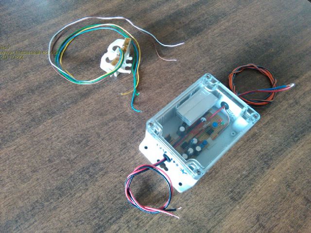

voltage switch that Dave built,finnished and in its box waiting for me to hook up to furling actuator , and an rps unit for one of the stators to measure rpm.

  brucedownunder2 said   I like your rpm box , do you have a pcb for it (for sale) ?
The circuit board is a one off, custom unit I made specially to Fred's requirements. It can be replicated as most parts can be purchased from Jaycar Electronics including the plastic casing and vero board.
It uses a 555 timer, adjustable from just over 30 min to 2 hours triggered by voltage which can be set from 245 - 310 VDC. The solid state switch uses 4 power MOSFET's set up in a H bridge configuration to allow reverse polarity of the 12 VDC to control an actuator. To turn on the actuator to extend it requires +12 VDC on the red & blue wires. Then when the actuator needs to be retracted is reverses the polarity to -12 VDC.

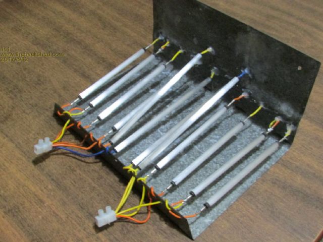

The wind turbines dumpload resistors = 8 ohms, all from f n p washing machines.
DaveP68
Joined: 25/11/2014
Posts: 292
Posted: 11:22am 12 Aug 2017
Hi Fred
Each resistor is rated 300 W, so with 12 combined to get 8 ohms the peak rating is 3.6 kW! That should be more than enough capacity for your dumpload function.
It may look a bit different, but you can't turn down free parts if they can be used for a different function like this.

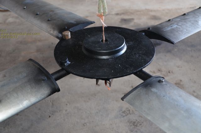

I added some more strengthening to the hub,so had to balance it again.
I wonder if there is much electrolytic corrosion between these aluminum blades and the steel blade roots?
I greased the shafts before inserting them into the blades to hopefully slow down any corrosion.

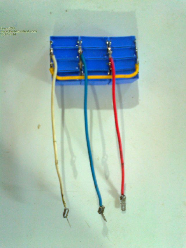

might have to fit one of your power factor correction setups to my turbine ?
DaveP68

Hey Fred
Yep can do, will send it down along with with some more F&P dump load resistors.
Just need to fine tune it, so it works correctly and extracts the maximum power in the 500 to 600 RPM range.
Here's a photo of version 1 used for testing.
DavidEdited by DaveP68 2017-08-15

Posted: 02:21pm 14 Aug 2017
Thanks Dave
looks good, small size
DaveP68
Joined: 25/11/2014
Posts: 292
Posted: 02:45pm 14 Aug 2017
Less is more
When using a capacitor doubler, found that the required torque was much greater with more power in for a given output. Max output with the drill was 700 W.
Just completed another test and got 870 W @ 488 RPM so this is now the gift that keeps giving!! Haven't even optimized it yet, so expect that number to keep going up. But a jump of 170 W over a capacitor doubler using the same drive system is a very big change!!
