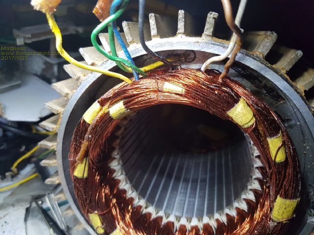

Got the 2 speed motor out, bloody pain in the arse to work on, I had to modify tools to get the Allen screws out that held it in.
The stator is out now and all the wires are buried between the windings, hopefully, I can pry them apart enough without damaging the windings. If all else fails I will just rewind it, I did my 8KVA generator a while ago, it is a 12 wire stator and that was more complicated than this motor.

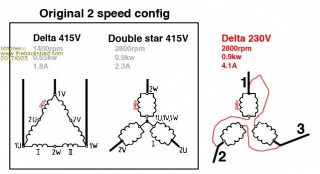

You should only need to use the wires coming from the motor.. you should not need to open the motor up
Look at the wiring diagram you supplied.. it is a 4 pole to 2 pole iteration.. it should be simple to do.
Warp. look at that diagram of the igbt... any two input to any of the 3 ph input will yield the 340v.... up to 4kw from that inverter mad built......
So mad, you should not have to open it up, just rewire the inout as i suggested above... it should yield 240v delta @ 240v full power as your right side diagram said.
you should be able to get up to 3kw or more..... use the ramp to your advantage. You don't need to get to 6000rpm too fast, just take it steady.
You can also wire it for 4 pole, and wind the hz up to 100 if you want.
Warp, I was running 6kw for 5-10 mins today as I noticed the washing machine with heating, the hot water heater, and the electric jug with 2 lts were all running at the same time....and the house base load... so 3kw is a walk in the park for the mad inverter I suspect
.....oztulesEdited by oztules 2017-06-26

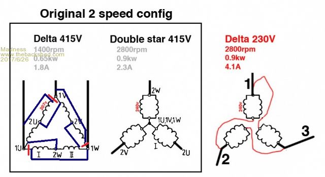

Sorry, Oz did not read your post properly earlier, I was rereading it and had planned to ask about it. So what you saying is to effectively short one coil on each leg of the Delta windings? Motor is 1420/2710 RPM 1.6/2.2 KW Would bypassing half the coils reduce it's power capability?

No Mad look at your pic here
Look at your double star....... keep looking..... now make it delta???? done!!!... do not look at the delta 415v pic..... look at the center pic and the right pic... penny dropping now....
Look at the thing I said about connections.... 1W-2V then 1V-2U then 1U-2W.... same as delta 230v one.
The coils stay the same as the diagram, but you simply go from star to delta. NO COILS ARE SHORTED
It is the same power, near twice the current as star... you have said so in the third ( Right hand side) pic...... and it can be done without removing the motor at all.
ie 1U,1V,1W and 2U,2V and 2W come out at the connection block do they not?
......oztulesEdited by oztules 2017-06-26
Posted: 02:17am 25 Jun 2017

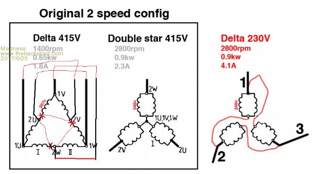

Yes 1U,1V,1W and 2U,2V and 2W come out however they are hard wired as per the Delta drawing on the left, to increase speed 2U, 2V and 2W are shorted to make the Double star.
But to get the result on the right 2 U must be disconnected from the coil going to 1V, then that coil is connected to 2V etc as per the diagram below. The red X is where the wire needs to be disconnected as 2U is permanently connected to each coil above and below it. Same for 2V & 2W.
If it was wired this way it would be possible to change externally.
Here is a really oddball video that explains how the motor is wired from the factory. If you watch it you will think it is not about anything electrical but the guy in the video is obviously very clever but very unusual.
Edited by Madness 2017-06-26

Sadly for you... i see what you mean.
At least the input wires will show where the joins are, so should be easy task.
........oztules

It is all disassembled apart from wedgeing apart the coils to get the leads out, that is the part the that worries me the most, I don't want to create any shorts in there. For a machine that is 32 years old it surprised me that the motor looks like brand new inside.

In case anybody in the future is looking at doing the same, I just realised the modification diagram is incorrect. The double star is effectively turned inside out when compared to the Delta 415V. So I have redone the modification diagram, coils with the red line through them need to be cut at the red line and reconnected as per the blue lines.

Success rewired the 2 speed motor as per the last drawing and wired the VFD to the rotary switch and everything works perfectly. Most settings are the default, the main one I had to change was motor speed parameters. Fortunately, all the three motors are 2 pole, spindle motor did switch between 2 and 4 pole before but now it is a double delta 2 pole. To run at the lower speed as per original can be done on the VFD.

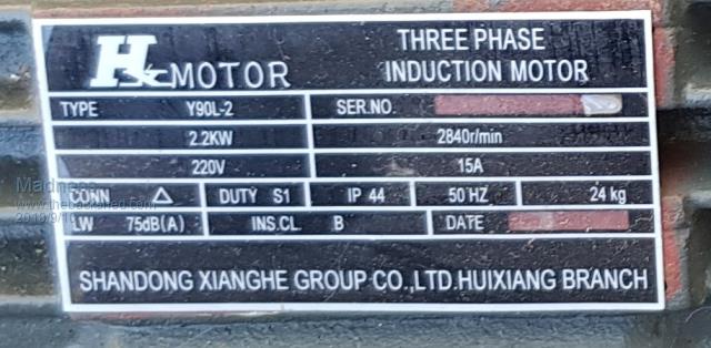

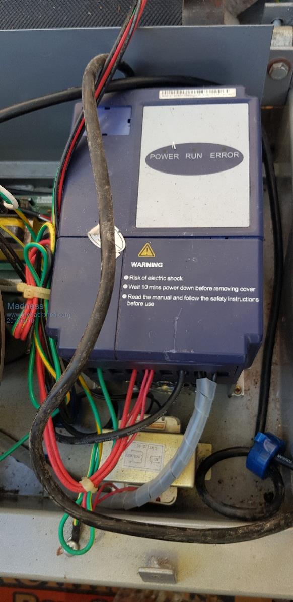

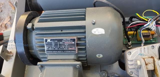

Today I picked up a treadmill for free on Gumtree, took the cover off the motor and there is nice 2.2KW 3 phase motor and a VFD. I intend to use the treadmill for what it was designed to do but thought I would pass this on if anyone spots one of these things and could use such a motor and controller. I have heard of some treadmills using a scr controlled motor etc, I was quite surprised to see this nice setup, it would be really good for a drill press or small lathe. There is a linear actuator that raises and lowers the angle of the machine that could be very useful also.
Edited by Madness 2018-09-11

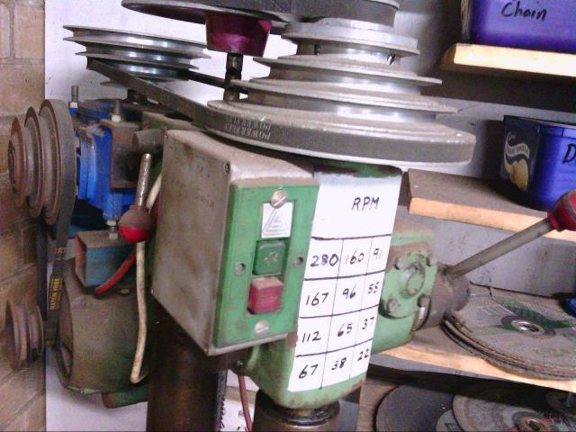

For very large hole saws and monster drills I built this:
The blue thing at the back is a 10:1 worm drive right angle gearbox. With the two sets of cone pulleys I can get down to 22 RPM.
