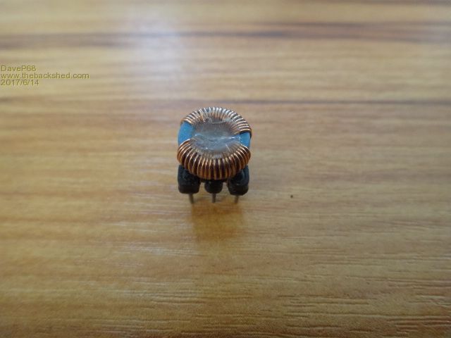

Isolated gate drive can be achieved using small high frequency transformers driven by low power CMOS gates. The output of which can be rectified to provide full gate drive voltage to the MOSFET's. Have them by the hundreds as that was the technique used by F&P to drive the high side MOSFET's on the motor control module boards.
Here is a photo of one.

Those little transformers look to me like a standard common mode choke.
If you can measure the inductance, it would probably be fairly easy to find a direct equivalent.

I'll have to get back to you on that as the 'common mode choke' as you put it that I've got in big numbers just work from my perspective. Not much incentive for me to find out it's electrical characteristics.
Will let you know the results though when I get the switching circuit that you proposed up and running.Edited by DaveP68 2017-06-17

It makes sense for F&P to have used something like that as they are cheap and pretty readily available.
They are made and sold to be used as common mode chokes, but they can also be used as a 1:1 high frequency transformer with pretty good voltage isolation.

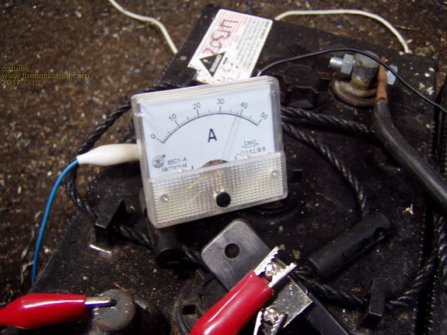

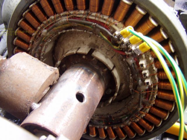

Davep68, I tried to play with my f&p, but i had wired it for low voltage high torque pump application on a mono pump... which works very well oddly enough..... anyway, I decided to pull it off and put it in the lathe, expecting maybe 15 amps or so, and at fairly low rpm... maybe 300 perhaps.
I don't know what stator it is, and have not even bothered to count the poles after the modifications some time back... memory is poor and pole count matters not any more, but you will probably want to know what it is... the pic follows.
I fired it up into some 220 amp 6v batteries, and this is what happened.
here is the stator with feeble wiring.
It needed over 500 rpm to get to 20 amps, and made it to 40 amps or more...on the 750 setting...... then the belts slipped.... the pic caught it at around 38amps.
So it was clear the driving device would not go much further.
I slipped a phase out to get an idea of what may happen when i connected the star point.... it went from 20 amps to 25, I was pulling up near 1000 rpm, belts were not happy, so I can say that in single phase , when you add the star point diodes as well, there is a marked increase, but i will need to do something better with the driver before i can discount the three phase hook up. It seems to be getting current limited after 750rpm, so the delta would not kick in until well over 1000rpm I suspect.
Anyway thats as far as I got today, and proved nothing, so at this stage i can't say the star delta diode system works at all ... never mind well, but the theory seems good so it needs better power inputs.
Very surprised at the 40 amps... didn't expect that much , and it would appear that a 5hp IC engine coupled to it would make a nice cheap little 2kw 48v charger ... even in just star.
I noticed the iron losses are very small too... another good thing.

The stator looks like an 80s 14x 1p star. Did you feed it into 2x 6 V batteries in series? That would make the battery terminal volts something around 14-15 VDC depending on how charged the batteries were.
The optimum current from that set up is 28.28 Amps at what ever volts/RPM level you want to run at. The maximum current is 40 Apms which is 1.414 x that optimum current for 80s 14x 1p star.
Interesting result removing 1 phase and noting a jump from 20 to 25 amps. RPM was very high though.
These stators are very predictable once you get to know them in their star/delta nodes.

The best I can do is 45 amps on the dot. As I was only interested in the current, a short circuit was sufficient to test this setup. The leads are skinny, so it was nowhere near a real short I guess.
Result is NO DISCERNIBLE CHANGE with the extra diodes in place it was 45 amps versus 45 amps.. nothing... nix..
I can't see why this is the case... but it is.. Dave was right.
