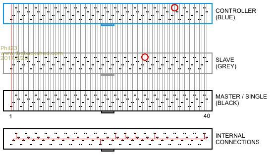

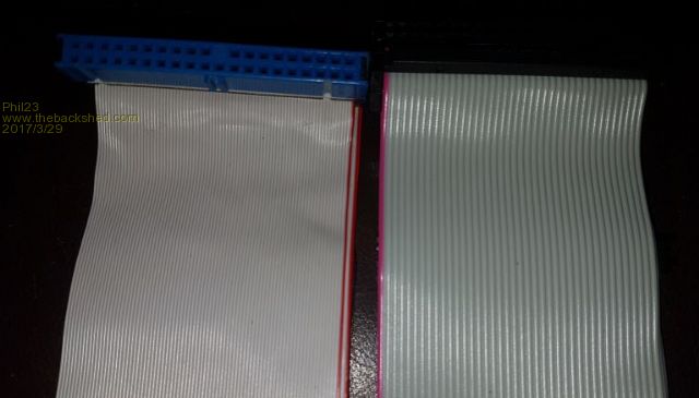

On the topic of cables, does anyone recall these; just had a ferret about to find one.
They were a higher spec IDE cable with 80 conductors instead of 40, but still 40 pin.
Maybe they would be more suitable than the standard ide.
Don't recall how the 80 cores were wired, but someone might know.
Not also it has a key pin, would need to drill a hole to accommodate it.
Thoughts?

The 80 core cable would only work if the IDE ground pins were the same as the TFT ground pins.
Stick to the 40 way cables!
Some of the 40 way cables have the centre pin blocked of too but fortunately, most are OK

Just explored this a bit further & it seems like a bad idea.
Looks like the resulting cable would have all these pins tied together.
2,19,22,24,26,30,40.
Cables look like this.
Phil

harking back to the 80 wire data cables - They were used with high speed data harddrives, and (so the story went) had a ground wire connected between every data wire (ie every data wire had a ground wire on either side)
they were supposedly interchangeable with standard 40wire IDE cables, just had less chance of data corruption due to crosstalk between data lines....

  Boppa said   harking back to the 80 wire data cables - They were used with high speed data harddrives, and (so the story went) had a ground wire connected between every data wire (ie every data wire had a ground wire on either side)
I often wondered about them, How did they get the GNDs to those wires when there was still only 40 pins on the sockets on the end of the cables?
I might pull one apart and see if it is a special connector or just a `con job'
Posted: 11:55am 13 Aug 2017
It's a bit too involved for use to make use of it as a 40 way cable. All the 'gnd' pins are interconnected along with the isolation wires.
