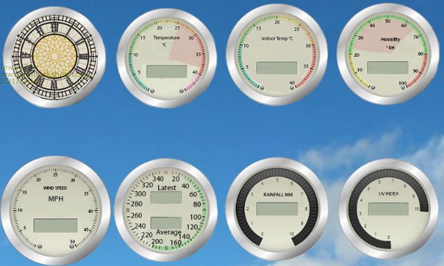

Hi Lewis,

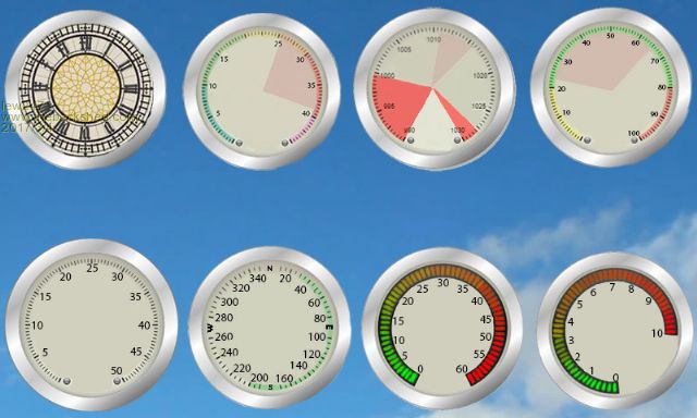

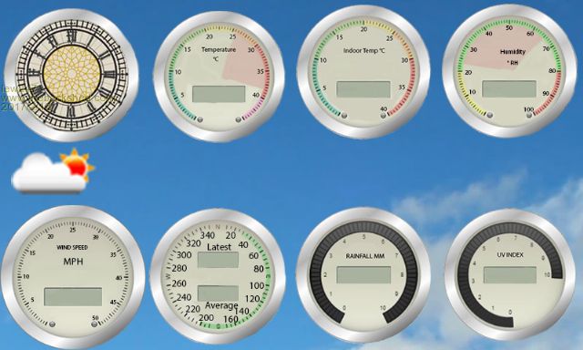

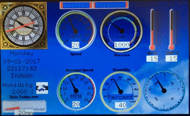

Thanks for the boards. I have done a little bit of work to earn them. Its not complete but it should show you enough to see you are on the right track and its possible to have dials and readouts on you existing background. I have added code to generate demo movement for the dials, thermometers and rain gauge. This code should run and pull data from the ESP8266 on COM2 and it should show the gauges being exercised stepping from min to max value.
It is all based on Peters gauge demo from here.
Photo realisting Gauges
I have just put a couple of wrappers around it and duplicated for two sets of gauges.
This is a snap of the code generated dials etc.
The code
2017-01-09_120337_BigBenClock_WeatherGA.zip
Gerry
Code if anyone wants to browse without downloading the zip.

That is great to see Gerry, and no doubt will also be a big help for Lewis in achieving the dials he is after
lew247
Joined: 23/12/2015
Posts: 1709
Posted: 11:36am 09 Jan 2017
wow Gerry, all I can say is "WOW"
that really is amazing, Unfortunately I'm away in Ireland on Holiday this weekend coming for a week or two so won't have time or chance to work on this for a bit, but that will help tremendously
All I have to do now is find some decent gauge pictures instead of the ones there at the moment and with the work you have done it will look amazing
Lewis
lew247
Joined: 23/12/2015
Posts: 1709
Posted: 02:53am 22 Jan 2017
disco4now just got back from Ireland and loaded up the code you posted, and all I can say is it's totally amazing the work you have done.
Thank you so much
I'll try and get some decent dials now that are suitable for the amazing job you have done

I wasn't happy with the background picture and the other half kept moaning at me that the "Big Ben" clock looked totally out of place.
I've redone the background picture as just 1 .ppm file now to be loaded at startup
With the new BLIT command this "should" work well
Although I haven't started on the new software yet you can see where I'm going
My plan is have the main display showing the relevant information with a "largish" weather icon showing somewhere on the bottom left with some other bits
The CURRENT day will show inbetween the 2 sets of dials - in a nice font!
Touch the display anywhere on the screen and the "DAY" changes to "tomorrow" or whatever day tomorrow is and the dial sets will show the PREDICTED information from the internet
Touch the screen again and it shows the next day and so on for probably 3 or 4 days in the future
Touch it again and it shows todays weather
That's my idea.... UNLESS any of you have any better ideas?
lew247
Joined: 23/12/2015
Posts: 1709
Posted: 07:53am 18 Feb 2017
The pictures above were taken from my computer not the Micromite display
I wish there was a way to have transparent picture backgrounds, the picture above actually shows the cloud as a .PNG file which lets the transparent background show
But it still looks ok with a white background - BUT the picture has to be shrunk to fit... or the backround covers the dials
New pictures enclosed in case anyone wants to try them
2017-02-18_205643_pics.zip Edited by lew247 2017-02-19

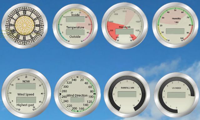

New background image if anyone wants it
.ppm file in the zip
2017-02-22_113626_Weather-Station-NEW100.zip
2017-02-23_211256_Gerry.zip
Edited by lew247 2017-02-24
lew247
Joined: 23/12/2015
Posts: 1709
Posted: 12:22am 04 Mar 2017
Updated pics to use as the background
removed the writing and text box as they can be done in software
The bottom right is UV index and the one to the left is rainfall in mm
2017-03-04_142842_Weather.zip Edited by lew247 2017-03-05

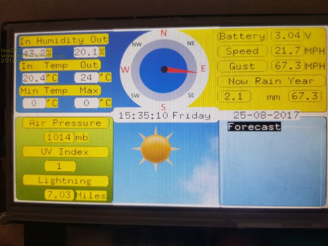

I've finally got round to doing more work on it to "try" and make it look a bit better
Can you let me know your opinions, and opinions on how to make the display look better please
It's not exceptionally "pretty" and it's definitely not finished
I'm open to any ideas (and/or help)
As you might notice I've included Lightning detector results although I haven't started on the code for that yet (or the hardware)
I want the bottom right to be a set of touch buttons that say something along the lines of
"Tomorrow"
Day 2
Day 3
Day 4
the buttons would obviously touch sensitive and able to pull the readings from com2 and display them where needed
I'd also like to include an UP and Down arrow that lights up to the left and right of the Pressure reading to indicate if the pressure is rising or lowering - not figured out how to do that yet (might use an led but an arrow would look better)
The weather icon is too high I know that and it's going to be repositioned lower on the display I just haven't done that yet
There is one thing that's bugging me - the day of the week does not change once the program is run, yet the time and date do
Code attached in case anyone wants to look/suggest changes
2017-08-25_153439_weather2-test.zip Edited by lew247 2017-08-26

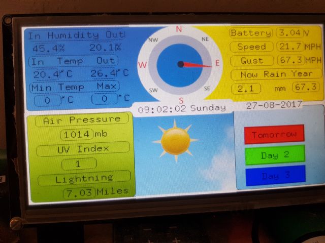

Joined: 23/12/2015
Posts: 1709
Posted: 11:03pm 26 Aug 2017
Does this look better than the picture above?
