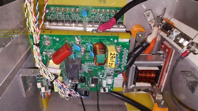

gpalterpower
Joined: 19/07/2009
Posts: 177
Posted: 11:06pm 03 Feb 2017
Hi Madness and Yahoo,
I have included a pic of the PJ boards. I just wanted to confirm before doing any changes to my system. If its not up to scratch then Im sure I could use the original 3kw power star inverter as I know for sure they are also work as a battery charger. Presently its just sitting there collecting dust
Having Air condition running on solar is impressive to say the least. Just shows that even with a large power demands it can work on house hold applications.
Yep ! 5 years goes fast! So much has been accomplished, learnt AND burnt in that time with this new DIY inverter technology.
Marcus
if it aint broke dont fix it!!
Posted: 01:46am 04 Feb 2017
Yes that is the right type Marcus.

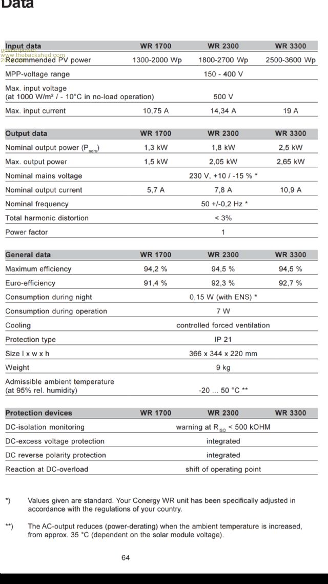

gpalterpower
Joined: 19/07/2009
Posts: 177
Posted: 04:15pm 08 Feb 2017
A check with Mr Google and soon found out about my GTI. Mines the WR2300. This is all that I could find in the 85 page online catalogue about input/output specs.
Not sure if this page tells all. Seems the voltages are set. There is more info about fault codes which is important too plus more pages of reading bout instillation. Im not going to even think about trying to tweek it in any way...I aint that smart and would just end up stuffing things up! It is working right now, but just noticed that the battery voltage just climbed above 28.5. Thats not over the top but I dont normally see it there.
This is really a test to see if it works or not.... and it does, which is great. So it has satisfied my curiosity for now with the help of you guys, and I do appreciate that. Until I work a few things out, I can just turn it on first thing in the morning, off around 10am , then back on in the arvo around 4pm. That will give me more flexability of power for now until additional battery storage/ power diversions can be organised.
Just noticed 29.3v... just shut it down.
