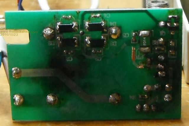

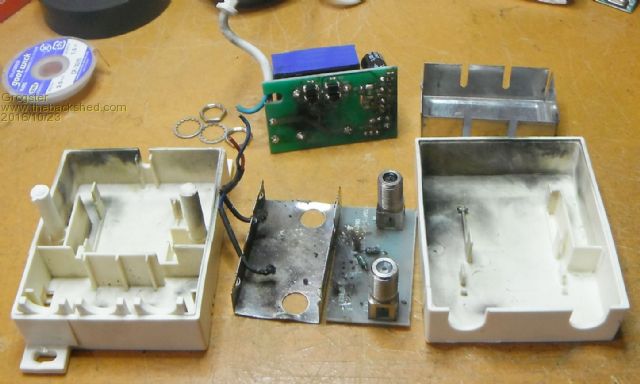

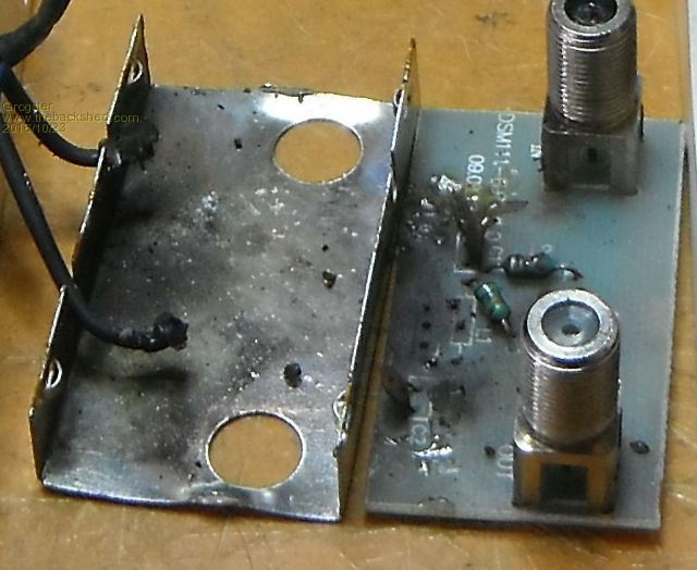

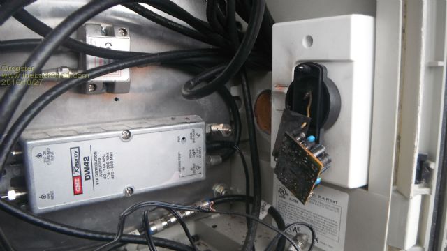

Yet another electronic device makes it's way up to silicon heaven:
That used to be a TV distribution amplifier, and this was out in the field, not even in the main complex that was hit, so the lightning has come screaming down the underground cable-TV feeds too, and did that to this amp in a completely separate building from the main one.
Wow.
I expect I will be finding new faults and replacing parts up to Christmas and probably beyond at this rate. Edited by Grogster 2016-10-24

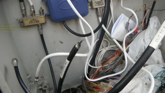

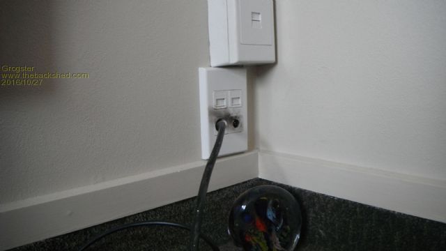

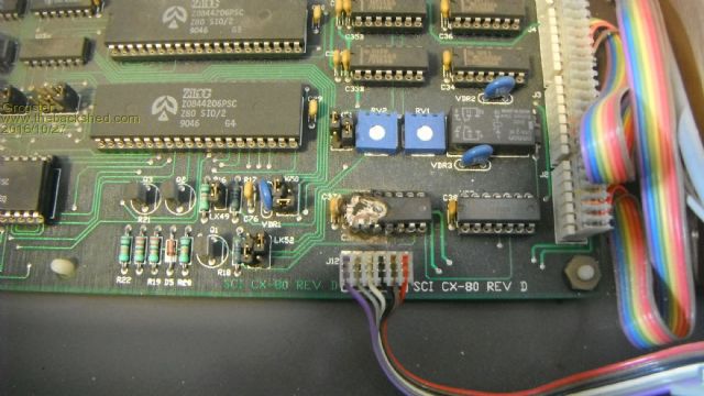

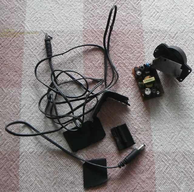

Some more carnage photos for you then:
End blown off RG11 cable-TV feed cable - this was one block of buildings over from where the main strike was.
An outlet in one of the rooms:
Another TV distribution box out in the field:
Another shot of the amp PSU carnage:
Nursecall system mainboard:
If these photos are of any interest to people, I will keep posting them as I discover damage, but I guess after a few photos, they all start to look the same eh?
Posted: 06:49am 27 Oct 2016
I am curious what kind of board is on the last picture. Are those Z80 SIO chips?
