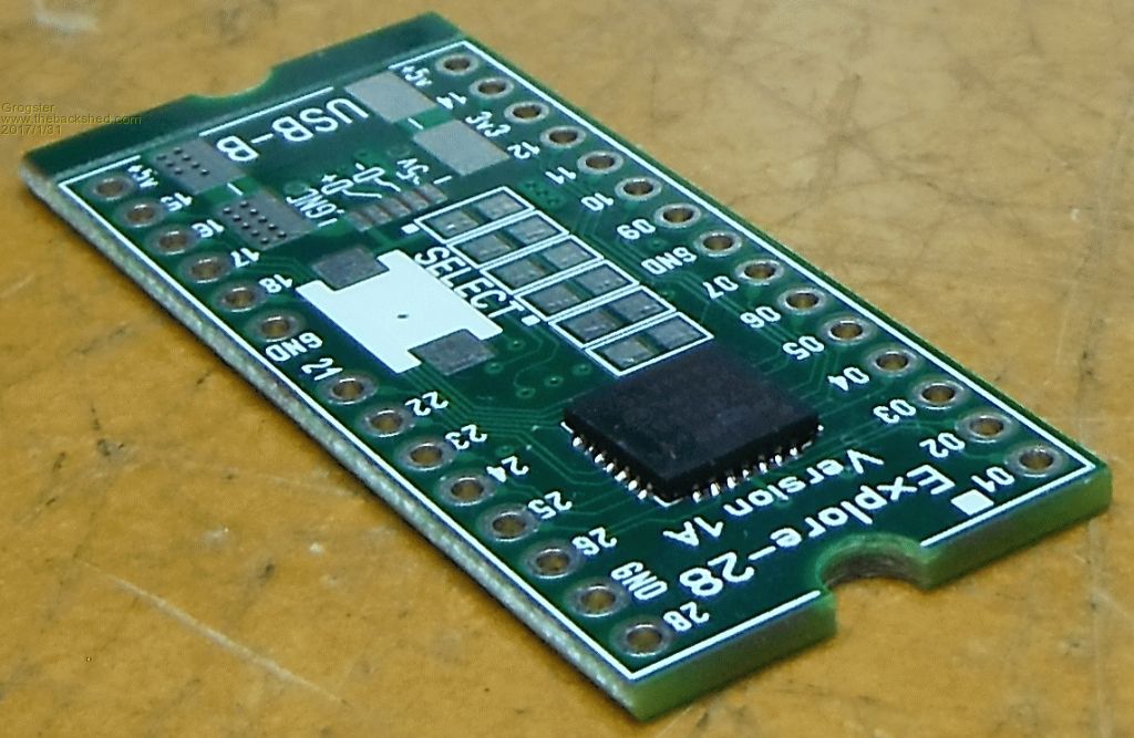

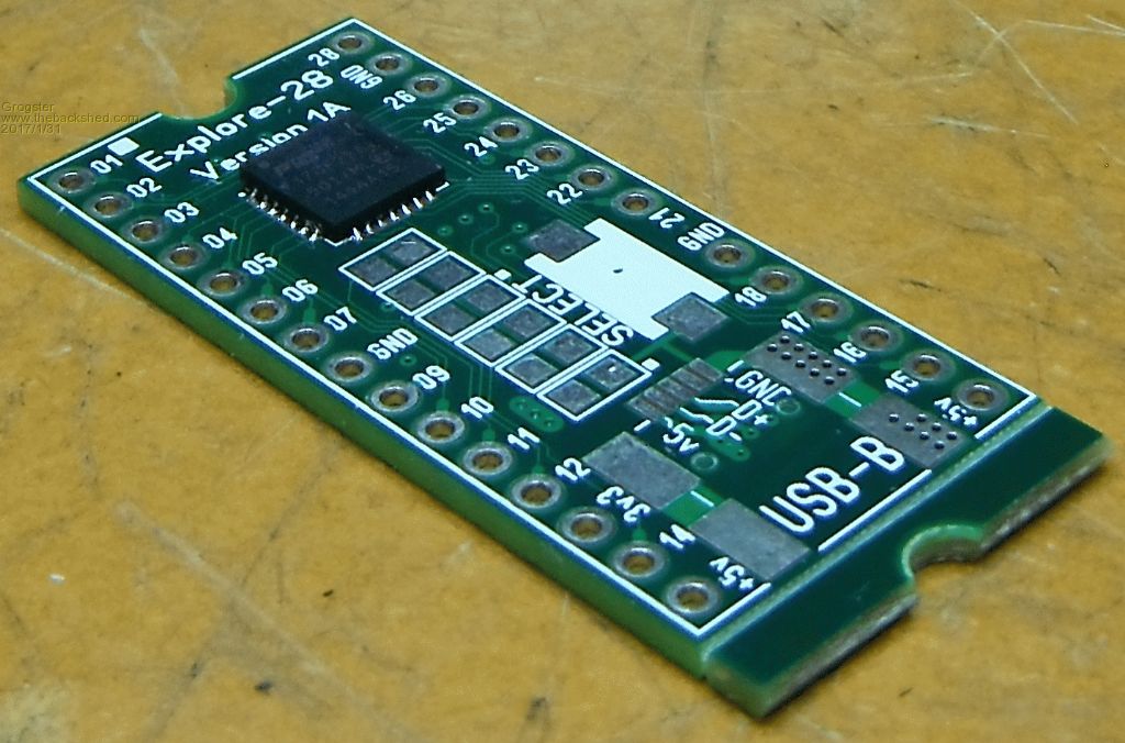

Well, here is my attempt:
This is the very first QFN I have done, so I will probably get neater as I do more of them. Difficultly level: 5/10.
Not really a problem, in other words. This was hand-soldered with a bench iron, same as Rob did his one.
In my case, I used a TINY bit of blu-tack under the chip, to both hold it there while soldering, and make it nice and easy to move the chip around for alignment. You press the blu-tack flat with your finger, then press the chip onto that. This means the blu-tack will hold the chip SLIGHTLY proud of the PCB, but that is probably not a bad thing, as the solder can then flow under the pads to form a nice solid connection. The blu-tack holds the chip there while I mount the PCB at 90-degrees so I can see the pads and the lands on the chip. Apply flux-gel, and soldering was easy. Does require about one second longer per "Pin" then the standard QFP chips, but once it is on the move(the solder), then it flows very painlessly to where you expect and want it to sit, so overall, very pleased with how easy they are to solder, when I thought they would be a right pig.
I'll try to build the rest of this module tonight depending on time. Rob having got his one finished has prodded me to get a move on!
