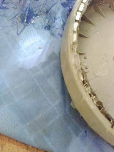

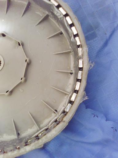

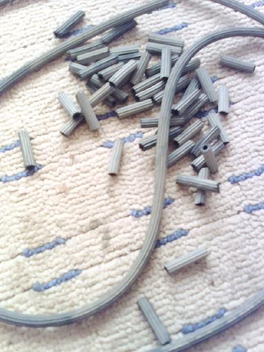

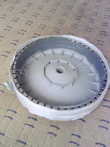

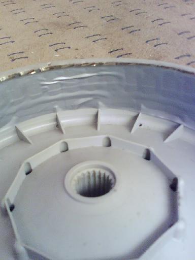

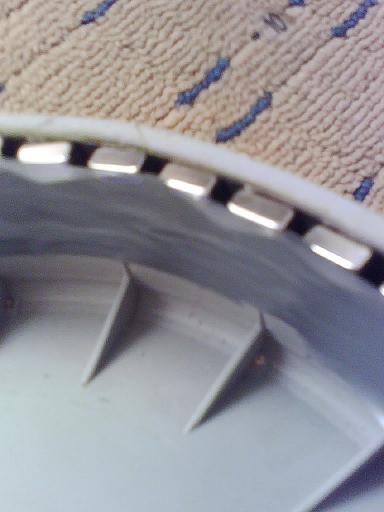

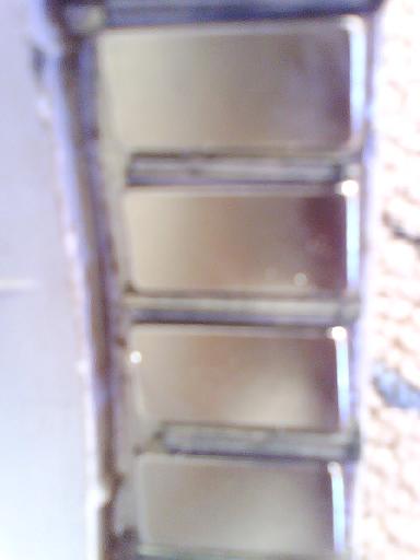

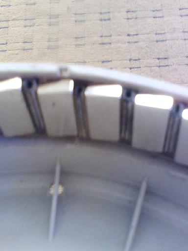

i have finaly been able to get back to my neo mod after a short break for work
i found the old rubber used for retaining the flywire in flyscreens a good size for my mod
i then formed the dam using ducktape
i then poured the resin

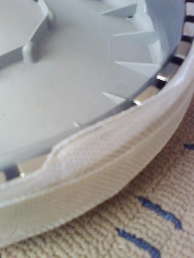

i also strenthened the rotor with a wrap of fiberglass cloth
its a bit messy and will need to clean up when dry
i will post a pic of the the completed unit when dry
fingers crossed for the unvieling

Posted: 08:43am 19 Feb 2008
Very good work Martin. Cant wait to see how it goes.

Posted: 10:35am 19 Feb 2008
Martin,
I used duct tape on an earlier project and found it blistered badly from heat and/or chemical reaction and leaked resin everywhere. What a mess. I swore never to use that again. I thought masking tape may be better as the paper would not blister like the plastic does.
Did you have any difficulties in that area? If so, what do think would be better for next time?

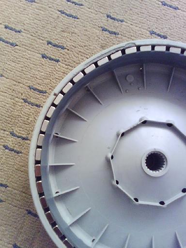

Your Magnet spacing looks regular and very neat. I measure the angle on the new F&P hub as 12deg to form the arrow head, so that equals 6deg across the full width. But they round the poles as well for even less cogging so it's difficult to know what will work best. What is the angle you set yours to?
We're all hoping it goes well.
Cheers Gill _Cairns, FNQ

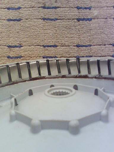

martinjsto
Joined: 09/10/2007
Posts: 149
Posted: 11:43am 19 Feb 2008
hi guys,
you are right gill,i just removed the duct tape and the duct tape had blistered a bit leaving the finnish a bit irregular, i didnt get any leakage only where i spilt the resin whilst pouring, choice now is whether to clean up the mess or remove the magnets b4 it sets completely.
i have a lathe so if the runnout isnt too much i might just skim it and sand down to smooth.
i realy didnt set the angle i found as i mounted the magnets i could only twist so far and then the magnets rocked so i reduced the angle untill i found the best seating position without being upwright. i think i have about 6 to 8 degrees i will check with the protractor after cleanup.
the job looks good with good resin penetration thro-ought i will also do more strengthening of the outside diameter probably increase it about 5 tp 8 mm. i read someware the metal laminations are to reduce the "flux" affect from rotation magnetic field. im not sure what that is but as i am using much more stronger magnets

Hi Guys
I made 3 Neo conversions some time back. The first one failed due to an out of round rotor. The second one developed problems with cracking from the resin mix .
The third one worked okay but our mills at the time were not torquey enough . It also developed a out of round fault. Anyhow some HOW TO SUGGESTIONS
1 Find some MDF/CUSTOMWOOD and use it for spacers. Make them longer than the magnets and remove after the duct tape but before the resin.
2 Cut small angled pieces of wide duct tape and put them down in line withe magnets You will need about 12 of them
3 Once you have mixed you resin put it in a sauce bottle then blow it in and you will not get any mess.
Regards Dennis L

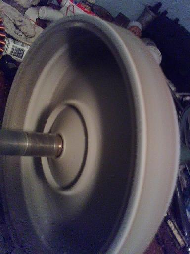

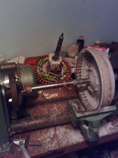

Posted: 03:11pm 20 Feb 2008

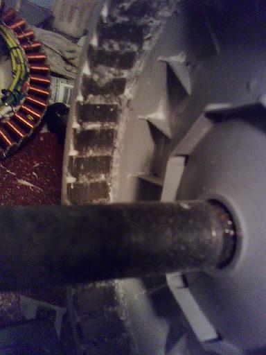

thanks for all the help guys,
i have started the priliminary machining to clean up the rotor.
i will be applying more resin and matting to the outside after cleanup and build up between machining.

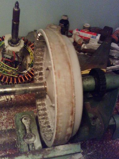

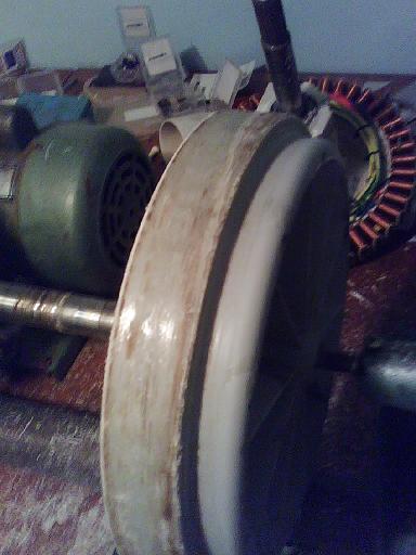

setup in lathe and check for runnout, looks within 0.5mm at this stage
need to apply more resin inside as i didnt get even fill
hard to see but very little runnout or vibration at this stage
martin
