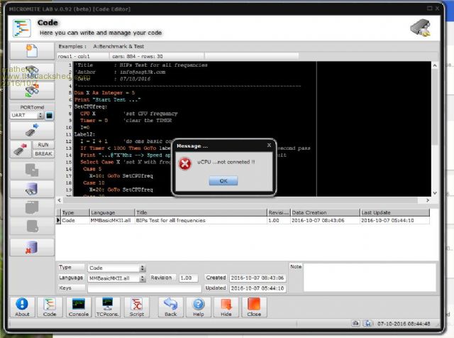

I'm trying the code on W10 64-bit. I can connect with the console and the break and run buttons work fine. However, the load program button give the message "uCPU not connected", same for the read code from uCPU button

It is necessary that you are not in "micromite edit mode". The SW search the prompt ">" why I need to start with "autosave" command in upcode and "list all" in download code.

The Micromite is in normal console mode. I go to the console type return and I get ">". I then go to the code window and click "write code to uCPU" and get the error

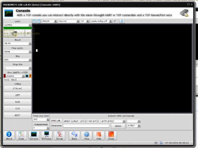

In the "CONSOLE" you can find "TimeOuT in ms". You can try to increase or decrease the value. Can you to do a schreenshot where I can see the console? So I can see the problem.
Posts: 12185
Posted: 09:46pm 06 Oct 2016
As before timeout now 100msec (huge!!!)
Connection works perfectly from the console window.
Is there a reason you you autosave? MMEDit uses XModem which has at least some error checking

Console form ...thanks
Exactly the same for me on win10 64bit
