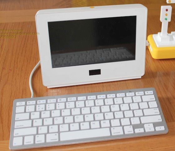

If you are familiar with the iMac wireless (BlueTooth) keyboard - I modify a BT keyboard identical to this (dare I say it, they are cheap on eBay) and convert it to PS2. End result is a stylish and small keyboard that is proportioned beautifully
I will see if I can find a photo . . . .
Posts: 2998
Posted: 11:53am 23 Aug 2016
Here is a 'modified' keyboard that works well with the MM+
It does not have a Home or End button so Geoff kindly made Ctrl and cursor keys mimic these functions in the early days of Beta Testing.
Note that in this photo the MM is connected to an 8" TFT. However, it looks good with a 7" and a 5" too.

  WhiteWizzard said  If you are familiar with the iMac wireless (BlueTooth) keyboard - I modify a BT keyboard identical to this (dare I say it, they are cheap on eBay) and convert it to PS2.
How do you do this conversion Phil?
Greg
Posts: 2998
Posted: 01:48am 24 Aug 2016
@paceman
I take out the circuit board, and add my own that contains a PS2 Matrix chip (HOLTEK), and drill a hole in the back for the PS2 lead to pass through.
It is a real 'custom' job that takes a fair bit of time. If people are interested in this then I would make some PCBs up BUT the cost on eBay for a PS2 keyboard doesn't really make this economic sense.
The parts for the PCB (excluding the keyboard itself) come to about £6. It takes about 1 hour to do the 'modification'; and then another £8 for the BT keyboard.
